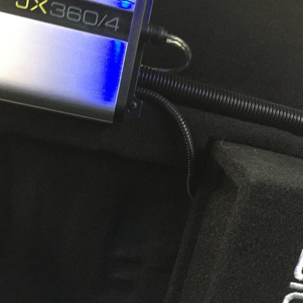

  17. Nov 9, 2016 at 2:06 PM
    #137
    ICrazyChrisI
    ICrazyChrisI Well-Known Member
    Jan 13, 2009
    #12534
    86
    San Diego, CA
    2016 TRD Off Road DCSB
    Looks like a snug fit. Did you have to cut the child restraint hooks?
  18. Nov 9, 2016 at 6:48 PM
    #138
    VandalTaco
    VandalTaco Well-Known Member
    Dec 28, 2014
    #145129
    1,045
    Will
    Moscow/Idaho falls, Idaho
    07 DCSB TRD SPORT
    OME 887 lift, 16" XD addicts, 285 duratracs, leather seats, badass JL/Focal stereo
    I didn't install it, but no, I believe they are still there.
    There is one section that did require some cutting. It's covered with carpet in this photo, but it's the right angle allowing the top left corner of the sub to fit. I think the shop just had to cut a section about two inches long and about an inch high.
