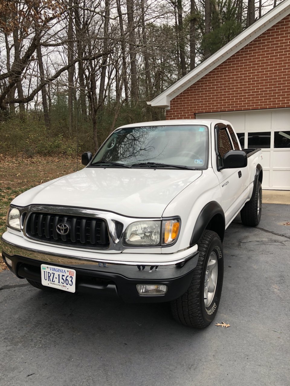

  2. Jan 14, 2020 at 10:35 PM
    TWJLee
    TWJLee Well-Known Member
    Dec 7, 2018
    #275158
    264
    Jay
    Midwest
    2003 Tacoma AC 3.4 4x4 auto TRD 2004 Tacoma DC TRD 103k. 2002 4Runner Limited 235k 2020 Tundra DC LmTD 2020 F150 5.0
    2003 Bilsteins 5100’s 17”s off gen3. New frame, sweet deal truck. 2004 new frame low mile deal 2002 T4R exceptionalism Tundra GFC 33’s Borla Pro XS F150 33’s Magnaflow 2” RC level
    That thing looks too nice to tear up! More pics
    but a 2” Bilstein 5100 up front complete with new springs should get you there for those wheel and Tires.
    Back- maybe a shackle lift or a mild leaf pack will leave you with solid reliability a bit more trail versatility.

    yes 4x4. I have been leaning towards bilstein 5100s or dobinson. thoughts?
  6. Jan 15, 2020 at 6:36 AM
    harris_taco
    harris_taco [OP] Member
    Jan 13, 2020
    #316014
    10
    Ian
    2004 White Tacoma TRD
    STOCK! Ready to build.
    i have been looking at bilstein 5100 with new springs and new shocks in the rear with the add a leaf option instead of blocks. thoughts?

  12. Jan 15, 2020 at 9:04 AM
    jbrandt
    jbrandt ......LOADING
    Feb 12, 2011
    #51038
    15,090
    Justin
    Sacramento, CA
    '04 TRD Tacoma 4x4 DC
    Kings, J59's Total Chaos UCAs Custom skids Sticker mod
    Definitely don't do blocks.
    With those 285's, you should be able to run a 2.5-3" lift without too much trouble. Depending on the offset of those wheels, you'll likely run into rubbing on the frame or the fenders. Pinch weld mod is a definite must.
    Keep in mind that the coilovers don't change the suspension geometry, they just change the height of where it sits. So all things equal, bigger tires will *always* rub unless you make changes to the suspension (after market UCAs) or different wheels/spacers. But like I said, I don't know what the offset of those wheels are, so a bad offset can make the problem worse.
    Best to just toss them on there and see where it rubs, and trim/hammer accordingly.
