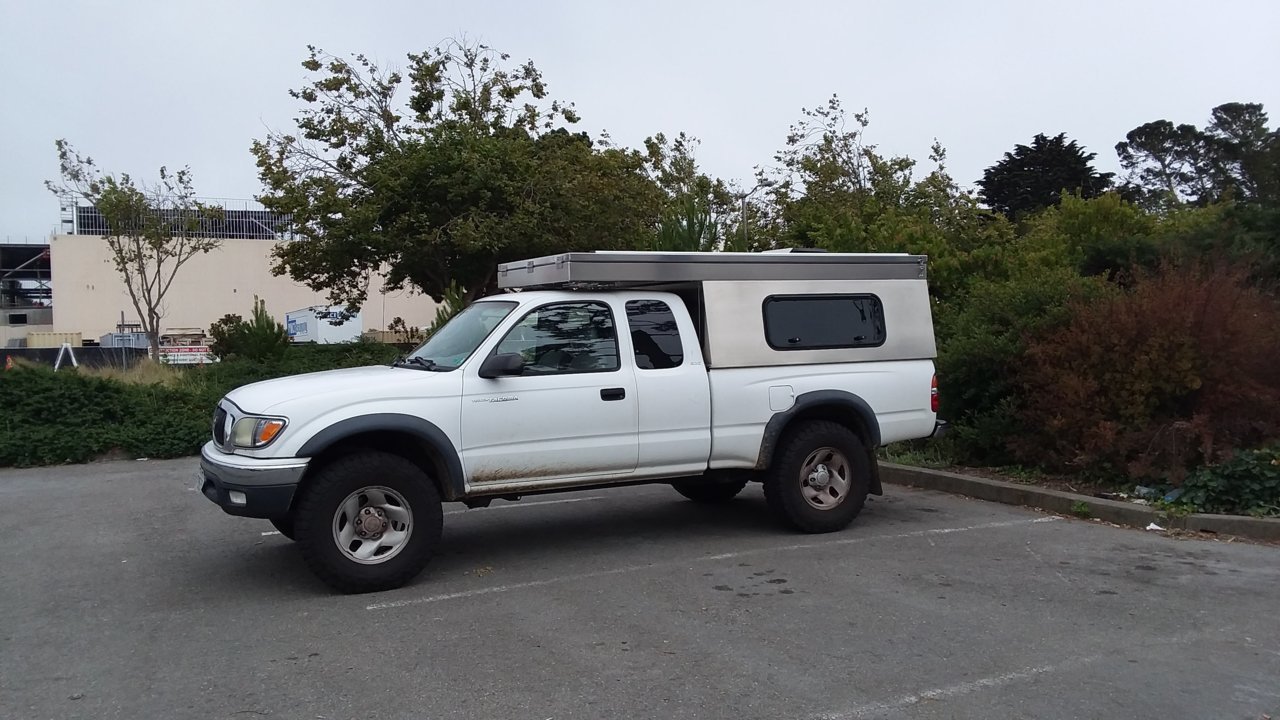

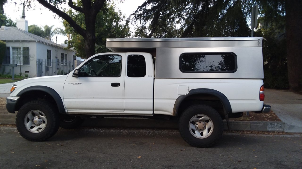

    I have an 02 4cyl 4x4, just did a full OME upgrade through Toytec, it cost about $1200, and I had a shop install it for $600. I went with 881 coils. It gave me about 2.5 inches of lift, and is pretty stiff with just the shell, which weighs 350lbs. I just took a long road trip with a couple hundred pounds more weight in the back and that was the sweet spot. It sounds like the OME package likes to carry weight and work, as soon as I build out the back a little it will ride like a dream. 20191115_163917.jpg
    The photo above is after the suspension upgrade, the photo below is before.
