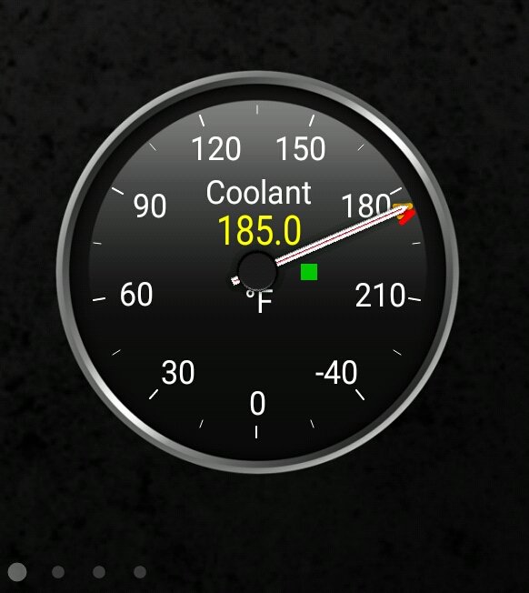

  20. Apr 4, 2018 at 1:09 PM
    #20
    taco2010trd
    taco2010trd Cyber Bully
    Apr 15, 2012
    #76977
    2,367
    Tampa, Florida
    2010 Silver TRD OR DCSB
    This is what my OBDII is reading as I'm idle in the shade and it is 84 degrees outside.
    190 is the highest I've seen it
    llamasmurf and shr133 like this.
