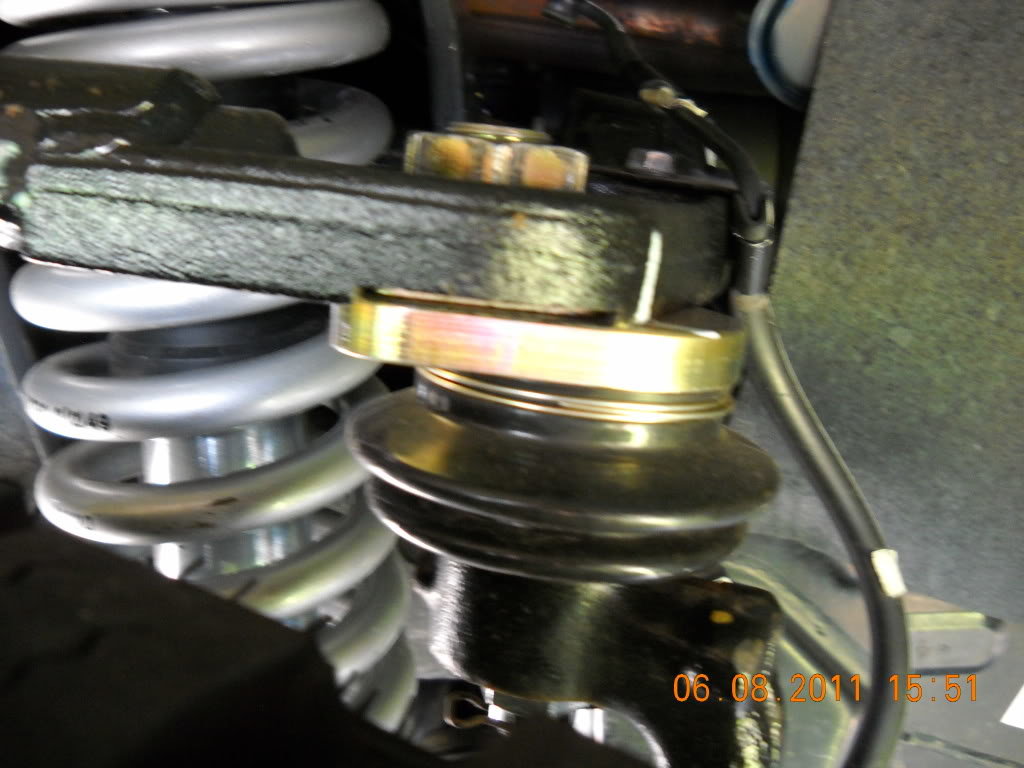

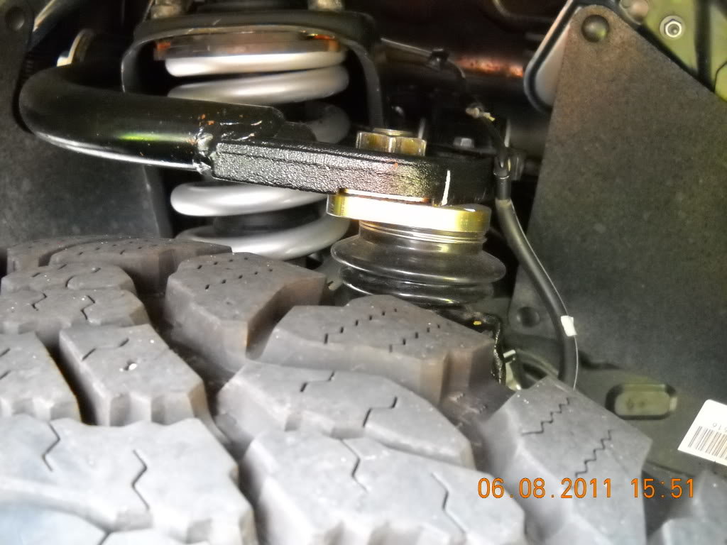

    Ok here are the pics, they are all of the drivers side with the wheel turned to the right stop.

    thats your problem. you are at the maximum plus caster setting (A) on the UCA pushing your wheel further back in the wheel well, then the alignment shop had to further reduce the caster to try to get in spec at the bottom pushing it even closer. rotate it forward to the E/F position and have them realign it and you will be fine.

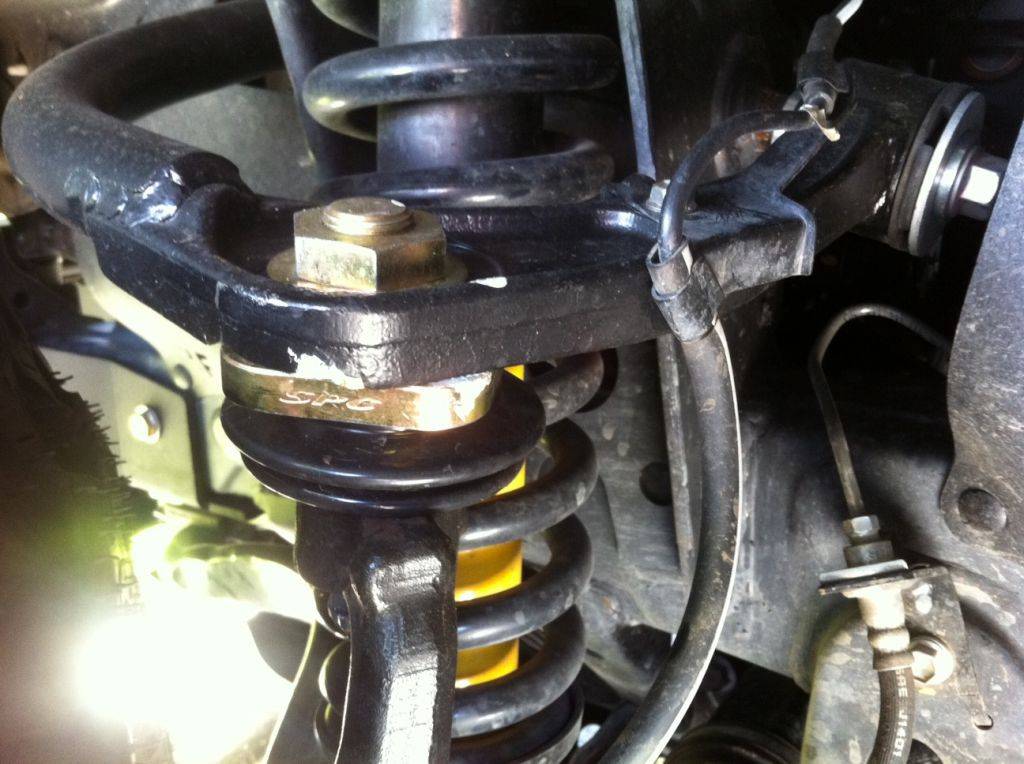

    For comparison, here's mine at the "-1" position
    and
    Also both taken from driver side with wheel cranked hard to the right.

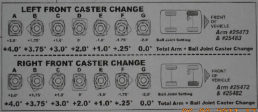

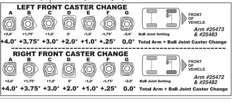

    According to the way I inturpeted this drawing I am set at "G" right now with the flat facing front (based on vehicle image) and the ball joint to the rear. Am I reading this drawing wrong? and if so please explain

    Wrong instructions or outdated. You are in the A position. This is directly from their website.

    That's the "E" position. It's the one you can see well in this photo:
    Driver side, wheel cranked hard to passenger, looking into the wheelwell from the rear.

    Nick, the more I look at your picture, the more I think you've got the ball joint set at a position that isn't listed on the sheet AT ALL - two letters "before position A" if you understand what I'm saying.
    i.e. if there were two more diagrams in the pic, to the left of position "A" then first one to the left of "A" might be labeled "Z", then the one left of that could be "Y"
    ...I think you're at "Y"
