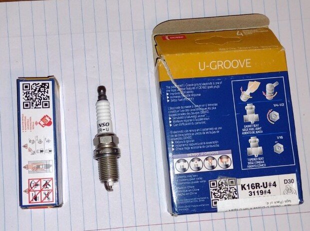

    Does this look normal? For years I've gone to the parts store to buy copper NGKs for my 1996 2.4 because they are OEM and the cheapest. Thought I would save myself $5.00 in gas and just have Amazon deliver plugs to my house.

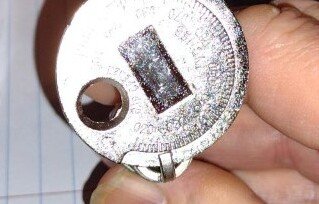

    Amazon had these Denso plugs for $19.00, they came in today and what the hell? They came all gapped at .26 (not .32), they are made in China (not Japan), and they just look and feel cheap (I'm afraid to stretch the gap out to .32 thinking there's some reason they are set at .26).
    Do these Denso copper plugs look like the ones you buy?
    Should I gap them to the .32 recommended in the manual or leave them alone?

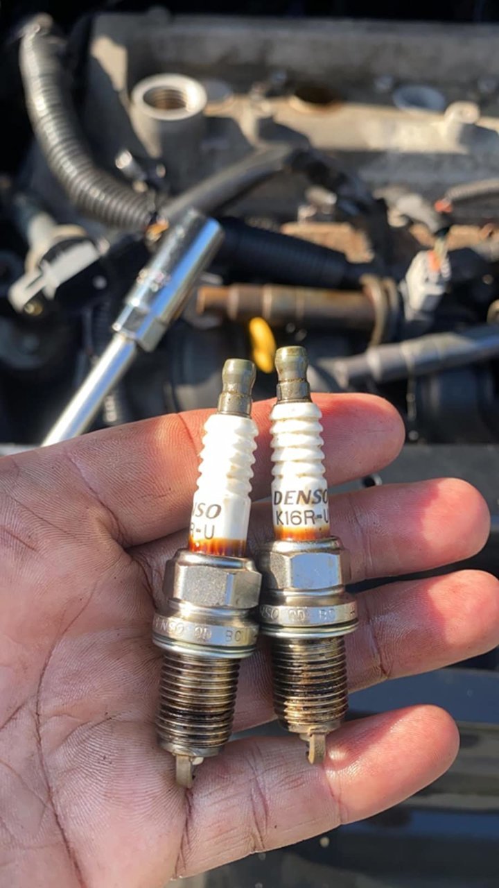

    Here's a pic an Amazon customer sent in of these plugs being burnt. Should I throw these in the trash and go with the same NGK copper plugs I've used for years? imageedit_3_7986328519.jpg imageedit_1_5108051926.jpg

    Thats standard gas stain on the porcelain. Nothing to be worried about.
    I'd run them, you have them why not.
    Set the gap yes. 0.032 (odd that our guide on this page says more, its 0.032" for sure)

    According to Denso, some of the plugs are made in China.
    And the majority of the time, a Chinese counterfeit will NOT say made in China.
    That kind of defeats the purpose of counterfeiting the part?
    Here is a link if you want to know more.
    https://www.denso-am.eu/news/deneur19_33_counterfeits

    Thanks for the replies. I'm old and poor and that truck is all I got, don't want to waste money buying another set of plugs, but don't want to mess up my engine or replace them in a few weeks either if they are junk.
    I'll put them in and hope for the best. Weird they are gapped so damn small.

    the counterfeit plugs are a big issue on Amazon and ebay. ive had to replace a few engines at work due to them. and when it happens your SOL. plugs are one thing to buy from the dealer or the parts store (the copper ones are fairly cheap.. even at the dealer)
    these knock offs LOVE dropping the electrode in the combustion chamber and destroying the top of the piston

    I would not put those in my vehicle. My co-worker found out about the “Amazon” fake Denso plugs on his car. 5k miles later he was putting in a used motor in his G37 for a tune of 5000.00.
    One of my best friends put these cheap “Amazon” plug in his Lexus IS300 and I called him right away after my coworkers motor was destroyed. He pulled them out and almost had the same issue with the electrode breaking off.
