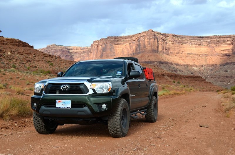

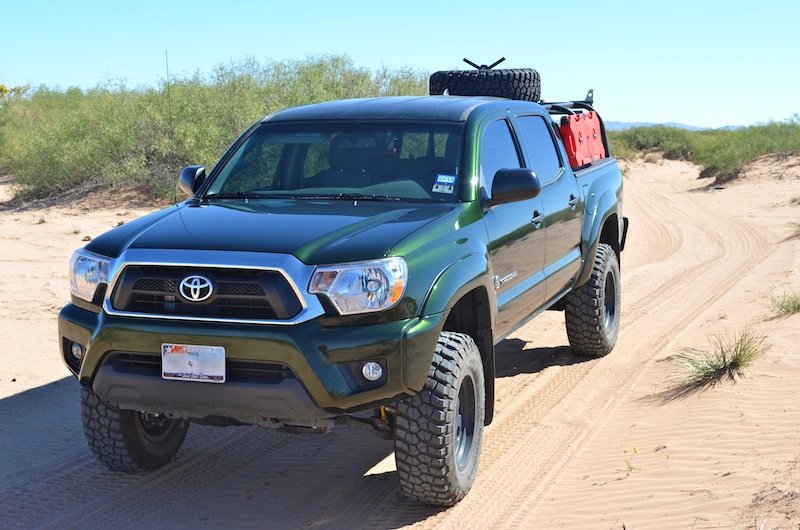

    These are 265/70/17 pre OME 3" lift.
    The first picture was taken on the White Rim near Moab.
    The second was after the lift was installed.
    I had minor rub issues and I would recommend at least a 2" lift with this tire size if you are going off road. There is little functional difference between 265 and 275.
