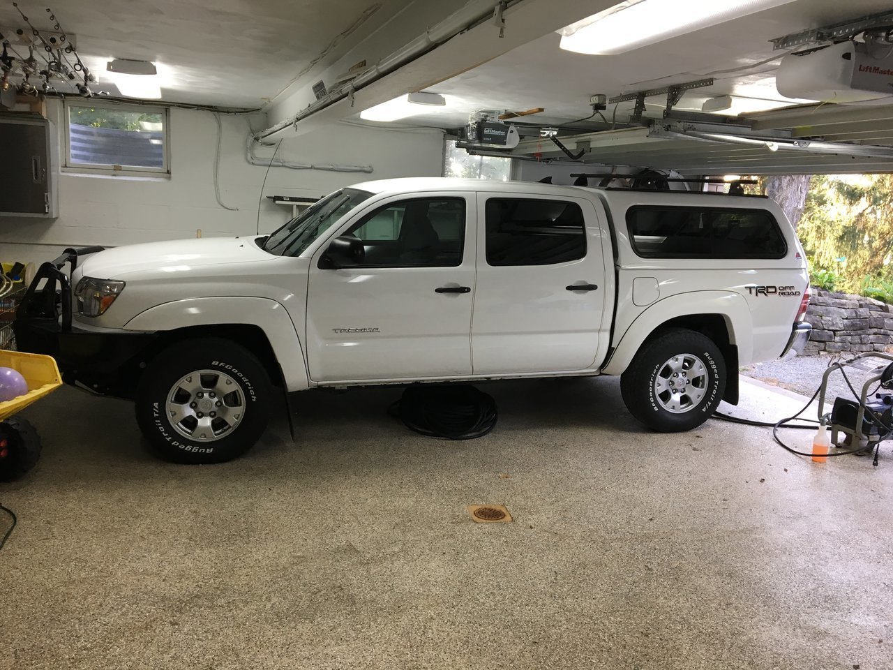

    I have a 2014 TRDO Dbl Cab with ARB Bull Bar, Winch, OBA,and Leer Cap.
    25,000 miles and the front struts are shot from the 220lbs up front.
    I want net 1" to 1.5" over factory and to support the weight. Old Man Emu 3" is out, don't want 3" and upper control arm correction.
    Also do not want entire spring packs or a block in the rear. A functional AAL that acts as an overload leaf that nets me an inch back there would be great.
    Money is not a problem. Prefer non remote reservoir setup. Prefer matching brand shocks front and rear.
    Honestly I've read so much BS I'm blue in the face.
    What front spring? What front shock/strut? What rear AAL?
    265x75x16 BFG ATKO2's are in the immediate plans to replace factory tires.
    Vehicle is used on OBX Beachs, used to tow tandem axle ultra low boy with kubota on it, for family camping/over landing trips, and to haul the dogs. No mud, no boulder dancing, and could possibly do a conservative canyon rim type trip where all bypasses and sneaks would be done. We have a JK4 door to beat up out there.

    With that weight OME is your best option. Run OME shocks all around with 885 coils and you will only get 1.5. For an AAL get the single leaf from toytec or the progressive pack from wheelers.

    King or icon with a 700# spring. If you don't want 2.5+" lift you can adjust them to your liking. Contact Marie @HeadStrong Off-Road

    The full OME kit has worked great for me. I have a front bumper with winch, and rear with a swing out.
    886 coils, OME front and rear shocks.
    Here's the thing about the AAL. I've had one on my truck, and the only constant weight I had back there was a hi-lift. The leafs were flat within a year and a half. If money is really not a problem, then I highly recommend looking at the full Dakar leaf packs. The constant weight of your cap + anything you put in there will make the truck nose high.The leaf pack swap isn't too bad.

    So the OME guys don't think this is a good setup because the shock is not riding at it's designed ride height where the static valve location is at? Straight from Buddy's King's tech guys they don't recommend this?

    You could do an icon stage 1 with standard travel coilovers, 700 lb springs set around 1-1.5" with matching rear shocks and Dakars in the rear and you're set.
    If you go OME - the 886s are specifically designed for your ARB bar. Pairing them with 5100 works too. Again, Dakars.
