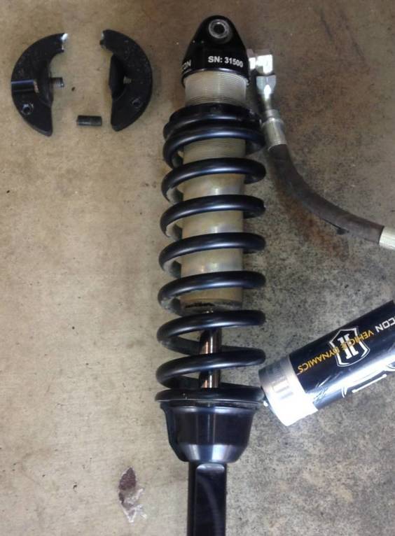

    To stray from yellow is probably my biggest struggle... is that a broken part in the top left corner of this pic?

    ChadsPride
    Nov 26, 2014
    #143119
    127,312
    Sponsored by TacomaWorld.com
    Poor top hat design

  9. Aug 22, 2017 at 6:50 AM
    #29
    ImpactAMS.com
    ImpactAMS.com [OP] Member
    Aug 21, 2017
    #227531
    13
    Aaron
    2014 TRDO
    ARB Bull Bar, Leer Cap, Winch, OBA.
    Warranty??
  10. Aug 22, 2017 at 6:51 AM
    #30
    ChadsPride
    Nov 26, 2014
    #143119
    127,312
    :notsure: I dont run anything Icon
