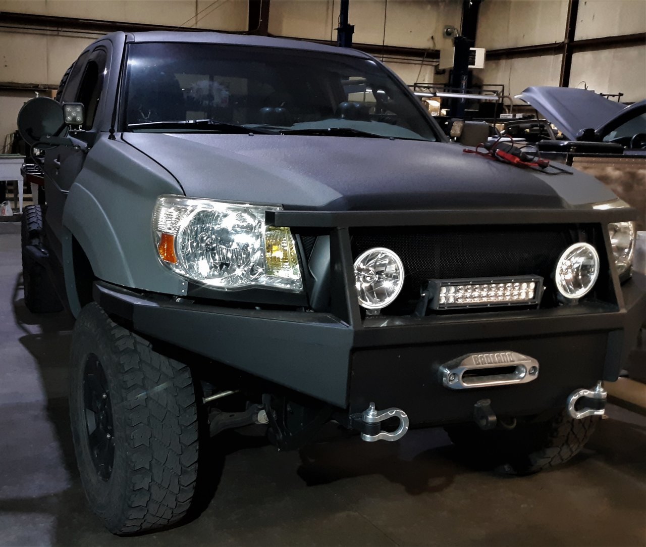

    As a public service, here is how I do it. Use the 3M kit below. You will need masking tape or electricians tape (my preference), and a cordless variable speed drill. You also need a spray bottle with water and a few drops of dish washing liquid. You will also need isopropyl alcohol. Also get a bottle of Maguires polish/cleaner
    https://www.amazon.com/3M-39165-Hea...adlight+restoration+kit&qid=1614734718&sr=8-7
    Tape carefully around the headlight to prevent hitting trim or paint with the polish wheel. I like electricians tape because it makes the curves easier and it's pretty tough. You can use two layers if you want. Follow the included instructions. Use the spray water to keep the surface wet and flushed of grinding debris. Wash out the foam polish pad at the end, and do one last step with the Maguires polish : https://www.amazon.com/Meguiars-Mir...uire+polish+and+cleaner&qid=1614735236&sr=8-2
    Once all the polishing is done, clean the lenses with water first and blow dry. Then clean again with the alcohol and let it air dry. DO NOT use the clear coat included in the kit! Use this: https://www.walmart.com/ip/Meguiar-...5ZXPl9z4exNVYyL9vaQ-Bw6SEpvjd3mAaAvyJEALw_wcB
    Mask off around the lights and apply two light wet coats with the recommended wait time between coats. Make one coat diagonal to the other. Allow to dry and you will be amazed! Don't use abrasive cleaners on the finished lenses, just mild soap and water. The headlight below was done 2 1/2 years ago, and at least 2 years of that was spent outdoors.
