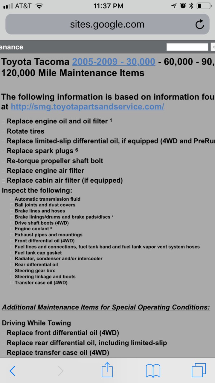

    I am looking at double cabs with 130-140k miles. What service should they already have had done?
    Water pump, timing belt, brakes, shocks, spark plugs, fluid changes? Others? Thanks.
  2. Jun 3, 2018 at 3:45 PM
    CBenfell
    CBenfell I don’t know sh*t about f*ck
    Feb 10, 2018
    #243983
    1,258
    Christian
    Western Washington
    21 DCSB TRD OR Midnight Metallic Black
    Crippling Debt
    mperl[OP] likes this.
