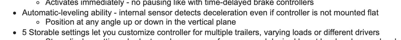

    How important is it for the P3 to be mounted "level"?

    It's not an issue.

    Thank you! This is great as a I can mount it to the curved dash near the fuse box
