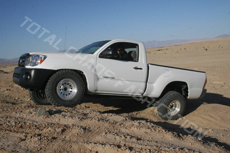

    I don't know... I'd have to measure the stock steelies to see exactly what we're running for width and backspacing.
    A "formula" to remember with alloys is to figure backspacing from offset, take the rim width and add one inch.
    Divide that by two and that gives you the backspacing for a zero-offset.
    From there, add or subtract depending on whether or not you have a positive or negative offset wheel.
    You know the tire calculator sites? Here's a wheel calculator:
    http://www.rimsntires.com/specs.jsp
    And I was wrong... 6mm offset may not be enough. Looks like the 5-lug needs between 20 and 40mm positive offset, so for a 7" wheel = 7+1 = 8 / 2 = 4 +20-40mm = 4.79 to 5.57 backspacing.

    3.18 centerbore is 80mm, so it's big enough in that respect, but what's missing from what you found is the stock width and backspacing or offset.
    The nice thing about using offset for a reference is that as you go wider, 50% of the added width is outside and 50% is inside.
    Using backspacing as a reference, as you go wider, all of the additional width is on the outside.
    Discount tire shows 15X6 5-4.5 +41mm as the stock steel replacement, so the stock offset is 41mm
    With a 6" rim, plus 1 is 7", divided by 2 is 3.5", plus 41mm = 5-1/8" backspacing.
    So the stock wheels only stick out about 2" from the mounting surface. They are tucked a bit, you've got some room to play, but not a whole lot.
    Moving up to a 15x8 maintaining the 41mm backspacing will stick out about 2-1/2"... easy fit. 9" wheel moves to 3", might start getting close with larger offroad tires, but you're going to want to keep the 235s on 7 or 8" wheels.
