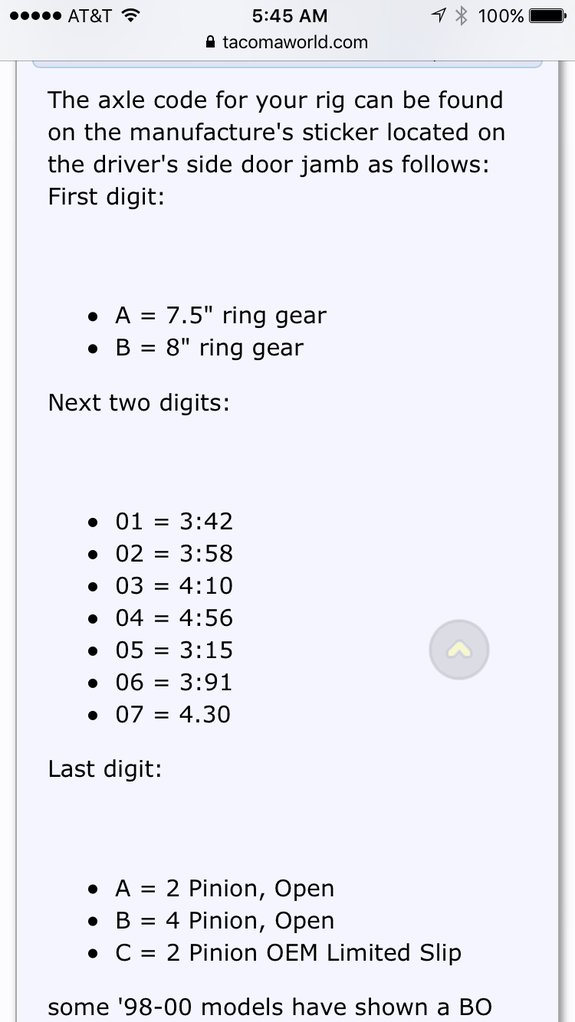

    It'll most likely be the 8.4" open diff, there's also an 8" diff with an elocker but I don't think those are as common on the '97. If it has the diff locker there will be a button left of the steering wheel on the dash that says "RR DIF LOCK". As far as gear ratios, there's a code on the sticker in the door jam u can look up. It'll be something like A03B or along those lines.

    Here are the codes. So you can decipher yours.

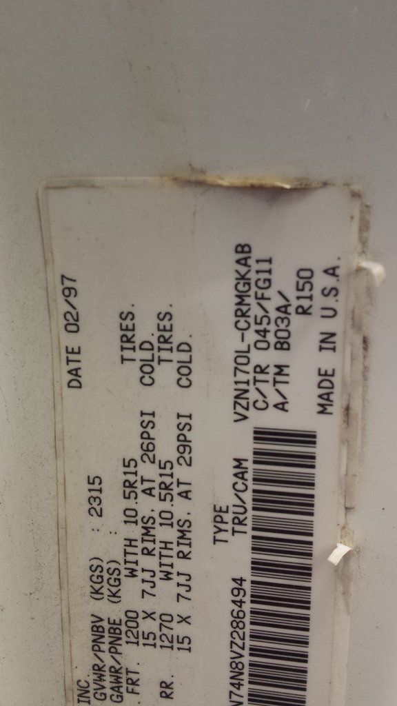

    This is what I have on my truck. Which numbers are the numbers I'm supposed to be looking at.

    Look above "MADE IN USA", you have B03A

    That make so much more sense thank you.
