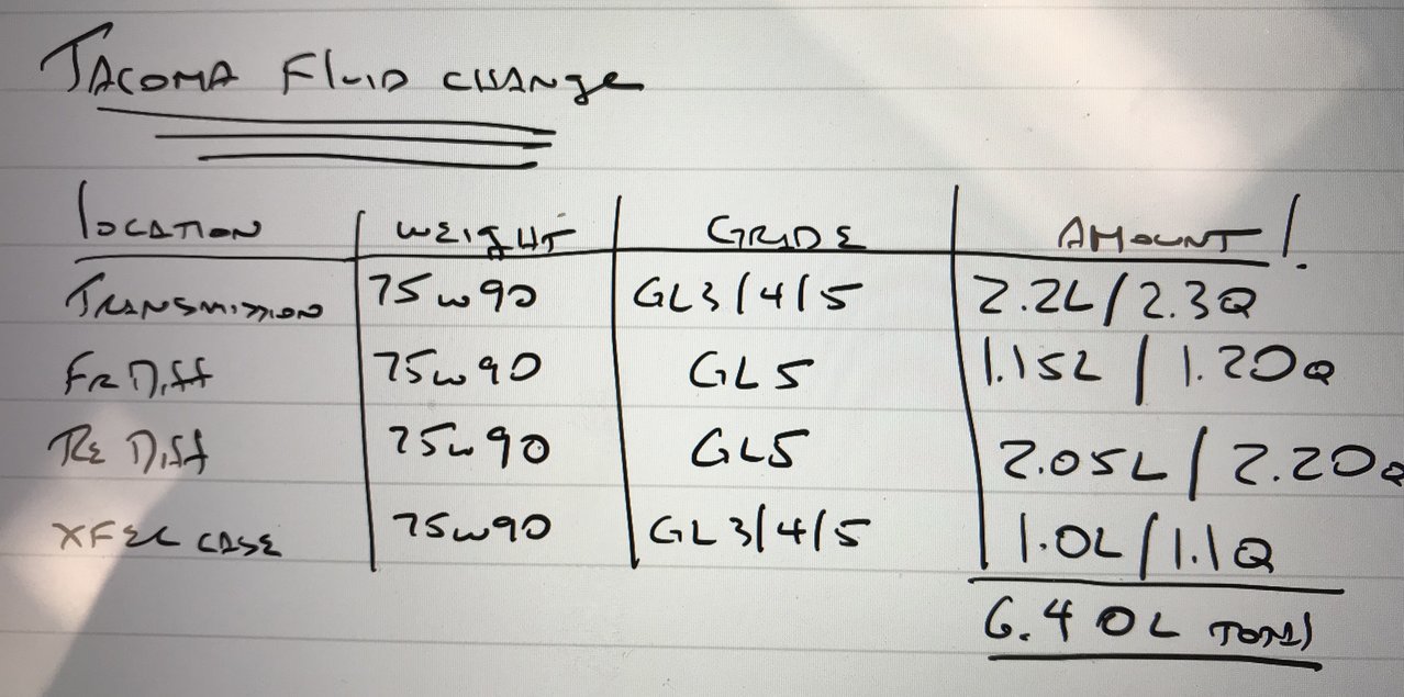

    Gents
    From my 1995 factory service manual I made this table which shows the types and quantities for the front and rear diff, manual trans, and xfer case.
    Hope it helps and I hope you can read my chicken scratch.
    Note that most 80w90 oils are rated for use in 75w90 applications - check the spec on the specific oil you’re considering.
    I did not need any friction modifiers (like you might need for a LSD) and I don’t think anyone should...but I could be wrong there.
    If our doing all 4, 2 gallons will do with about 1/3 of a gallon extra...you can use the extra next time, or use it to flush which is what I did.
    Also, Buy a hand pump hat screws into the top of the container. It’s worth the $10.

    So I should be using gl5 for the oil or gl4? Or is there much of a difference?

    According to my 1995 FSM, you can use gl5 everywhere.

    I got the rents to grab me some oil while they were in town but they got me gl4. Should I return it and get gl5? Or will in not make a difference
