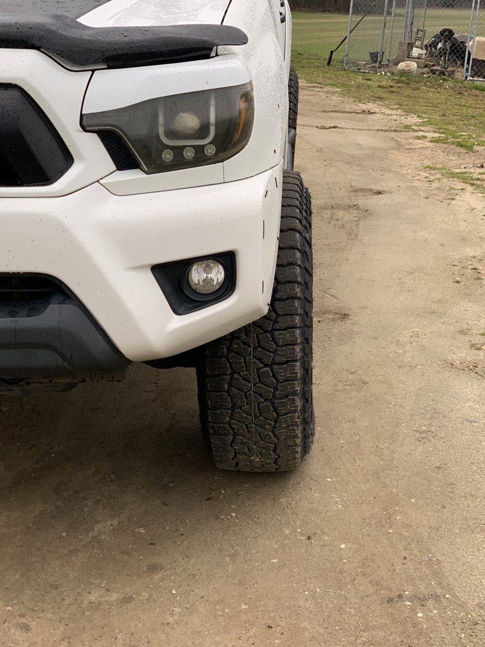

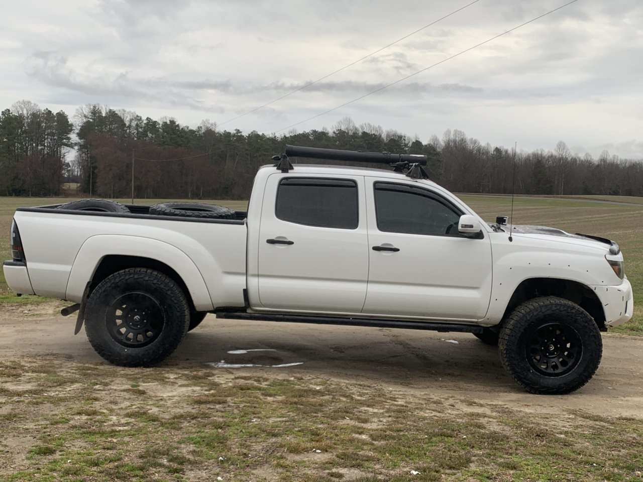

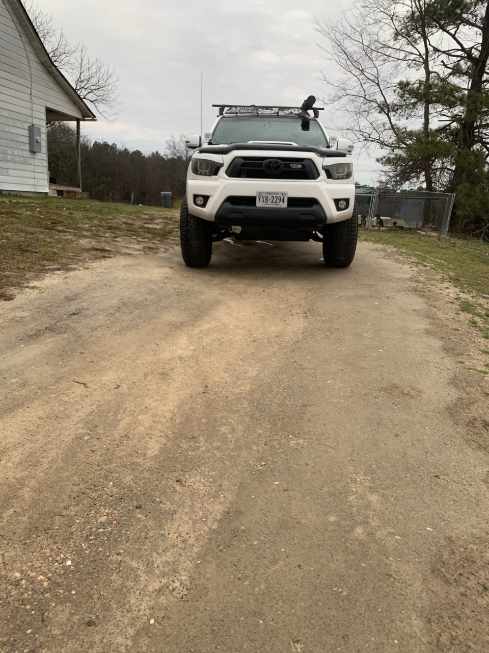

    5100s, OME 887 and 1/4" pacer, 285/75/17s
    3.25/1.5ish lift. Not exactly sure in the rear because I have firestone bags holding it up a bit to stiffen rear. 285/75/17s and I’m not on level ground but enjoy! I still need to heat gun rear mud flap and put front flares back on but I might keep them off. I like the stance up front without them.

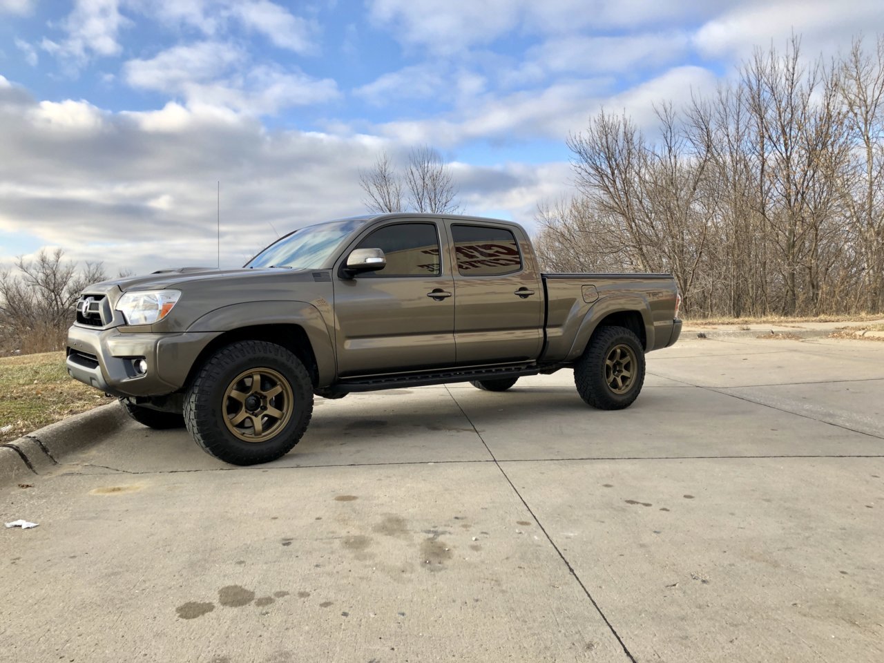

    I have a 3rd gen TRD OR suspension which raised the front about 1"-1.5" so not much for lift. I have 17x9 FN Six Shooters (9" wide is no longer available, I would prefer the 8" but got these used for good deal) and 265/70-R17 Goodyear Duratracs (P-rated, next time I'll go C-rated). I have never rubbed in full steering lock and full compression.
    I love the look of the wheels as I prefer a colored wheel over black, very light (21lbs I think) and I like JDM-ish look as that's the background I came from. IMO all black wheels look the same 15ft+ away, so why spend a lot on something that looks the same as a cheap wheel from a distance?? The tires have been absolutely the best A/T tire I have driven on! Especially in the snow!! Not very loud on the interstate, good in wet, great in snow, fantastic off road, doesn't throw gravel up like other tires and probably the best A/T tire in the mud if you run across that. This is all coming from a guys HATES Goodyear tires with a passion!! This is the only tire I will ever have from Goodyear. I researched for months trying to find a tire that was equal to or better than the Duratrac because I was so against Goodyear. But after wasting all that time in research I ended up with Duratracs and I've been happy ever since! A buddy of mine who has been an Advanced-Diagnostics Technician for 20+ years even ran them and loved them, he also dislikes Goodyear tires from a completely experience/real-world experience driven proof.
