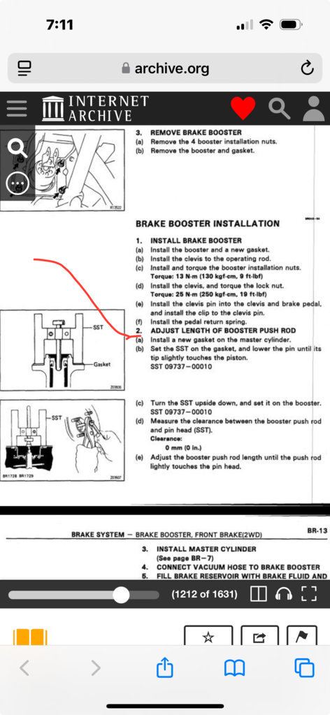

    The gap should be 0.5mm.
    You’re right, the booster does not need to be removed to adjust it. It just requires a specialized ”brake booster push rod adjustment wrench” (sst 09737-00020) which I currently see on Ebay used for $50, but won’t get here until the 27th at the earliest. It’s my only vehicle and I’m trying to drive home for Xmas so this doesn’t help as much as I would like it to.

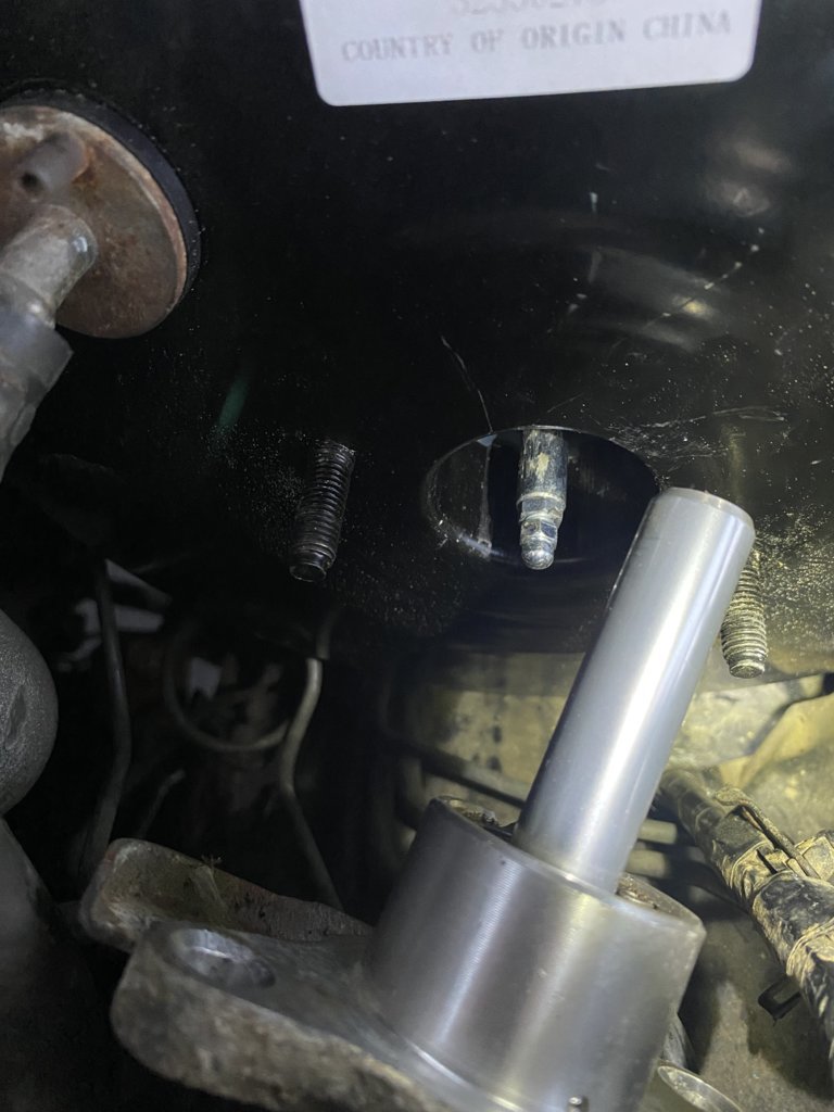

    Update: After taking a closer look at the aftermarket brake booster push rod, I see that it doesn’t need the same specialized tool that the OEM Brake Booster Push rod would need, but it can’t actually be adjusted any shorter on that end.
    I am at a loss for ideas as to what to try next. Any ideas would be greatly appreciated.
    Note that for this photo, I wedged a pipe between the brake petal and the seat, forcing the push rod to its maximum extension so it could be seen more easily.

    It looks like there are still some threads exposed if you back the jam nut off it should spin in more if not take the acorn off and grind/cut the shaft a little shorter or adjust the push rod on the pedal side it might be too long.
    As for the noise the "hitch" I as asking about do you feel anything in the pedal when you hear the noise?

    There’s only about 1mm of thread exposed. How big of a margin would make the difference between no pressure on the cylinder and the cylinder being permanently compressed enough that the brakes heat up and seize after a couple miles?
    On the brake assembly side of the booster, I can only screw in the nut on the push rod another 1/4” max before I would have to cut it to get it in further.

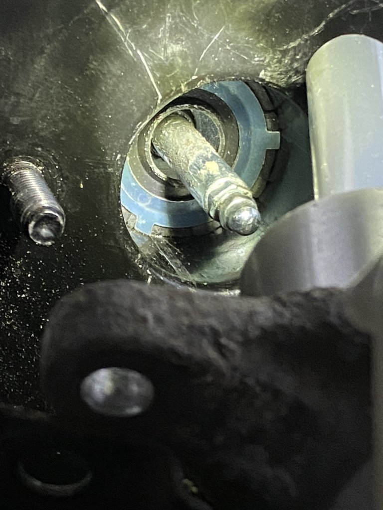

    Is that a pushrod already in the master cylinder in addition to a pushrod in the booster? Shouldn't there be just one?
    If you are considering using one over the other,
    have you measured the difference between the new and old pushrod lengths? Have you determined if the old pushrod will fit the new booster and backing off the nut 1/4" is enough to get the .5mm clearance you need? It seems if using the old pushrod then would need to make sure the OD matches the new push rod so it mates to the seal.
    Could also return this booster and get a different one that has an adjustable rod if the old rod doesn't fit it or is corroded.
    BTW the push rod in the booster looks really dirty or is that just new grease? It should be clean and smooth and slightly greased (check specs but perhaps with silicone grease) so the seal is not ruined. If the booster leaks then it doesn't do it's job. It needs to hold vacuum.
    What symptoms were you fixing when replacing the original booster? You said it had a "leak" so assuming it failed a vacuum test? Have you tested the new one to see if it is worth your trouble to install?

    I was replacing the booster because I got a lean run code and had an issue with the brakes feeling hard when I was accelerating (cruise control on going up a hill). My mechanic helped me realize both these were due to the brake booster having a leak. Check engine light hasn’t come back on so I think I took care of it.
    In the photo, there is a push rod in the booster, none in the master cylinder. The grease came off the inside of the tube going into the the master cylinder. It looks more solid than normal because it’s 10 degrees outside and the grease is cold.
    I unfortunately can’t return this new booster nor replace it with the old one because I had to chop a bolt off the old one and snip a bolt short on the new one to get them past the intake manifold.

    Thanks for the reminder. I ordered this tool earlier today on Amazon. Theoretically, it will be here on Tuesday. It will tell me if there’s any hope of adjusting the push rod and if not, I’ll have to get a different booster, unless I can swap it out for the old one.
    In the meantime, tomorrow I’m going to try adjusting the “clevis” on the other side.

    Hi all, here’s an update. I got that tool on Amazon, adjusted the push rod so there is a tiny gap between it and the master cylinder, took it for a ride, and it’s still seizing when it gets nice and hot. The push rod is at its minimum length, down to the acorn nut. To make it any shorter, I would have to remove tue lock nut or grind down the acorn.
    There’s still a tiny click half way down the pedal stroke when the master cylinder is connected. I’m wondering if that could be something inside the master cylinder. The strange thing is that when my brakes are seized and I disconnect the master cylinder from the booster, the brakes still release their pressure.
