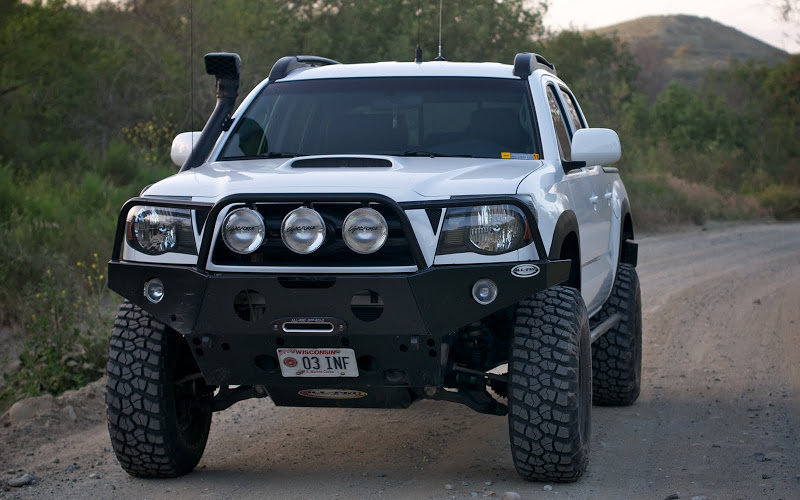

    I removed the plastic fenders and then patched up the holes. I should have welded the holes up but instead I put bondo. I also cut the actual metal part of the fender up 3 inches. Then I put some bedliner material where the stock fenders used to be.
    I might go back and weld up the holes and then finish it off with line-x.
    You can see in this picture that but removing the stock fenders that the truck is also a little narrower. Now the tires and front and rear bumper can take the hits instead of the body and plastic fenders.

    bedliner? wow what a concept
    thats great, I might have to do that!
    I suppose leaving the holes with bondo allow you to reuse them later if a flare product comes out that uses them.......
