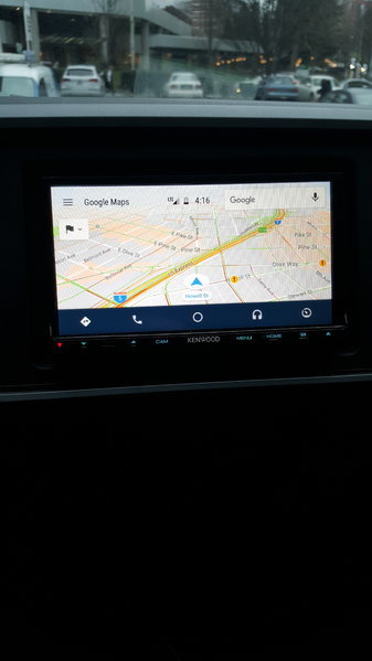

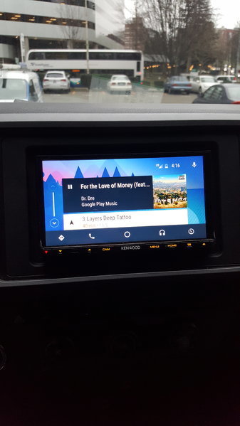

    kg206
    kg206 Active Member
    Jun 27, 2016
    #190697
    38
    Kevin
    Renton,Wa
    2016 Gray DCSB OR
    I need to get a thread posted on the whole build I am finishing it's fantastic.
    The Kenwood ddx9903s is an excellent alternative. We did a HDMI/USB flush mount for any HDMI input needs ( so I can change it between stiff without having to get to the back of the unit) and the android auto runs off the usb via phone. It's a pretty slick set up I highly recommend it. You do loose off the grid navigation since it runs off your phones Google maps but I can use a TomTom if needed

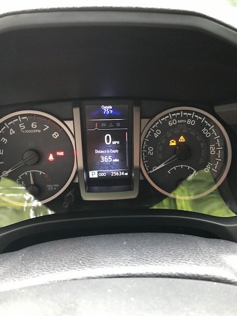

    I added a new head unit about 4 months ago with carplay. I love it. But i noticed 2 days ago that i dont have the song/radio come up anymore. I only have 4 settings.
    here is a pic. Is there anything i can do to get the other options back? What about being able to control how long my lights stay on or power door locks etc?
