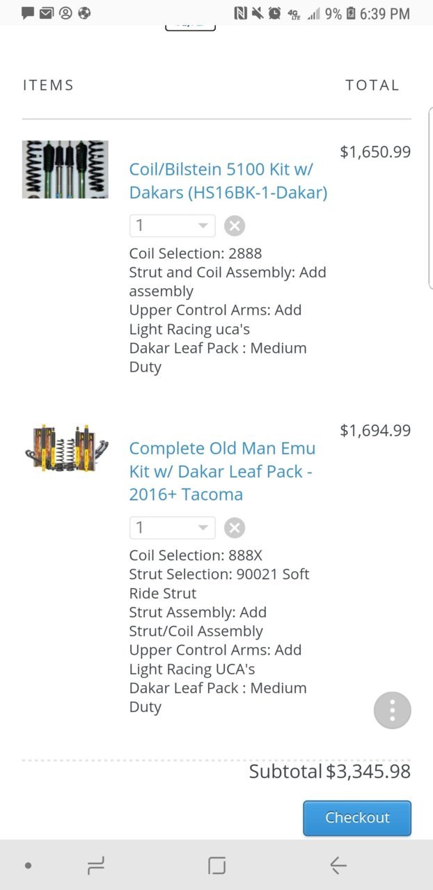

    im not sure if its in here but i have an 18 TRD OR. I didnt measure my stock height hub to fender. What is the factory measurement in that area?
  17. Jan 15, 2019 at 8:28 PM
    #3517
    SpeySquatch
    SpeySquatch Function over Form
    Mar 6, 2018
    #246516
    7,351
    2016 TRD OR DCSB
    C4Fab LoPro, BAMF Sliders, Ext ADS 2.5’s, 4.88's, OVTune (OG to KDMax)
    Front: 21”
    Rear: 22”

    First off, that’s overpriced. Check out Headstrongoffroad or lowrangeoffroad. They are significantly cheaper. I paid $1200 for the entire OME kit from Lowrange when I did it.

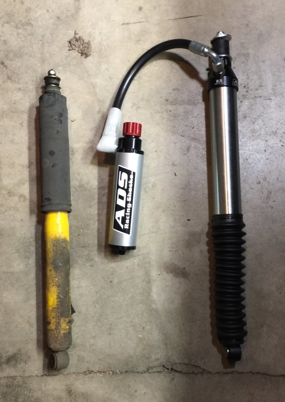

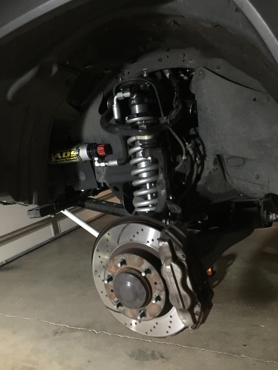

    Now for the advice part:
    Having done the OME whole medium kit the only thing I liked was the leaf pack. The shocks are stiff and jarring as hell because they are designed for heavy ass overlanders and not daily driving/trail riding. I also got new UCAs (SPC) and wore out the ball joints in under a year from how stiff the shocks were.
    If I were to do it again I would do the Bilstein 8112’s, 6100/5160’s, or stay stock.
    However, since I was dumb and didnt save a lot for the first lift and just went with OME. After really being pissed and putting up with shattered teeth. I ended up getting a second setup (ADS) and spent a hell of a lot more. Rule of thumb: buy once cry once.
    Stick with the Bilstein they are tried and true for what you are doing. You won’t like the OME compared to the Billies. The Bilstein will be much more comfortable
    If you want to spend over $2k on shocks down the road (only if you are really going to use them) go with something that will take a beating and that you can repair/get serviced if you are capable of doing maintenance and install/uninstall yourself. If not be willing to dish out $300 every time your shocks need servicing and waiting 5-8 days until they come back in the mail.
    Can you tell which one is the OME shock?
    I should have just kept my stock stuff on until it wore out then dropped $$$ once. Learn from my mistakes
