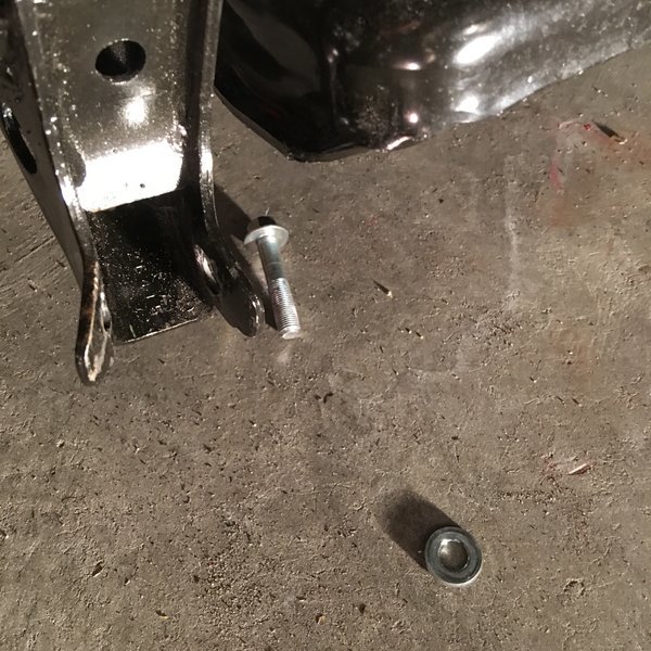

    I'm sick as I write this. Also a little embarrassed. Everything was going well until we got to the final corner. One of the spacers fell out before we put in the shock and we didn't notice until it was torqued. We were tired being the last one and we're just ready to be done. Well needless to say we found the missing spacer and the lower shock mount is bent to shit. This picture makes me sick. Any suggestions on getting it fixed? Torching it and bending it back? We have stopped trying to bend it back so as not to weaken it anymore.

    Hammer it back and then assemble with all spacers. Not a big deal.

    Well I guess I left off the detail that when we torqued the bolt for the lower shock mount it pushed in the metal and the bottom of the shock with the spacers won't fit in the mount....

    Put a 3/8" drive extension in the hole on the left in the pic. Use a 3' piece of pipe or something similar and bend it back. No harm done.

    I am not quite sure I understand what you mean. Can you draw a brother a picture?

    Use a 6" ratchet extension. Put it through the hole about an inch. Use a piece of pipe or a deep well socket on another ratchet extension as a breaker bar and bend it back. If you need more I can take a pic of an example in th morning and show you.

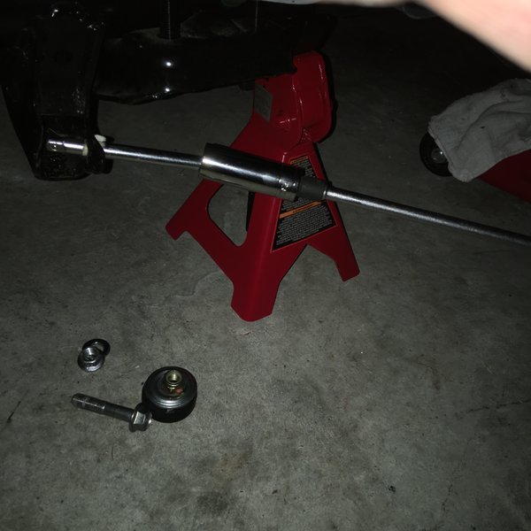

    I think I understand what you are trying to say. Something like this? We have a torque wrench off to the right of the picture. It really just wants to bend the outside of the mount and not all of it. The right side of the mount is the side that is bent in so much from torquing the bolt without the spacer. image.jpg

    That should work. Just takes a little patience and finess. Put a tire on the ground under the truck in case it falls. B careful.

    The frame is supported ahead of the axle so I hope we are ok. We cranked the heck out of it and even tried different angles. The extensions were flexing like crazy. The metal would move a little but bounce right back. We will try in the morning. Thank you for your help.
