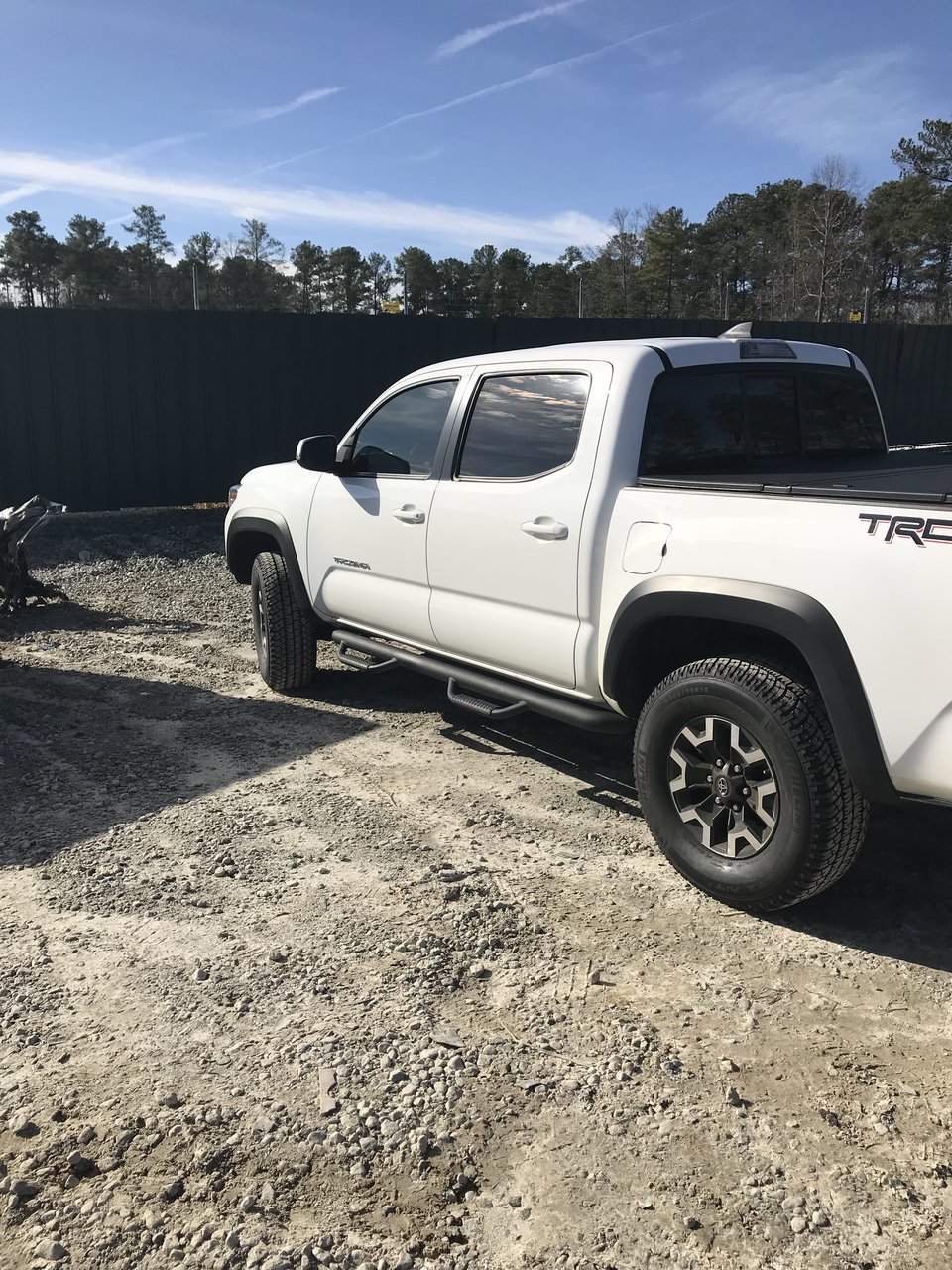

    If you're actually interested in street performance, this is the only answer. Obviously, it doesn't look as good as a KO2, but what you're asking for is impossible. Those looks come with a cost. I think the AT2s look good. Here's mine at the scrap yard the other day.
