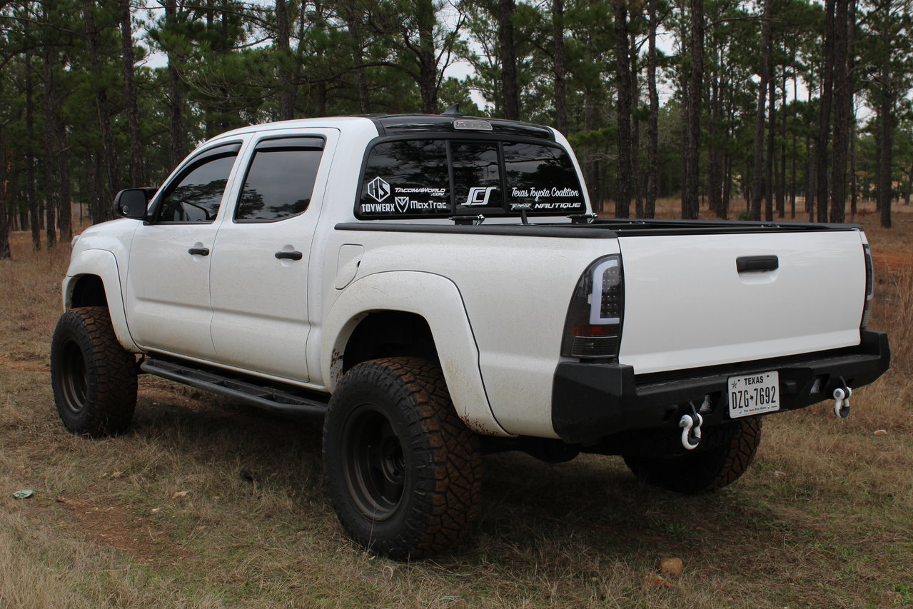

    Nitto Ridge Grapplers. Zero issues balancing, great on and off pavement.

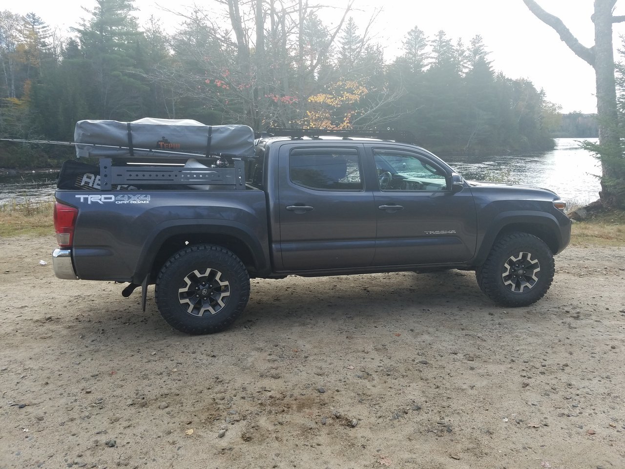

    I enjoy my duratracs. 265/75/16 c load20171015_091217.jpg

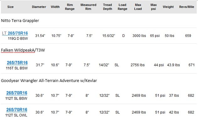

    Very informative. I will be replacing my stock 16 inch Goodyear with 265/75R16. This will be just a bit taller than stock 265/70R16.
    Seems like top votes for daily commute that look "aggressive" are Nitto Terra Grappler and Falken Wildpeak A/T3W. Notice the Terra Grappler G2 is not on my list, they don't offer it in 16 inch :(
    I'll go with Falken Wildpeak A/T3W, its lighter at 44lbs. I threw in the stock Goodyear just for fun. Not sure if the truck came with BSW or OWL. White letter add 5 lbs :confused:

    ^^^ TRDpro yeah it kinda sucks the new gen 2 terra grapplers don’t come in 16” wheels. If they did I would have got them again, I love the look of them and they do good for everything I do. Highway/city/snow/dirt and do pretty good mud.

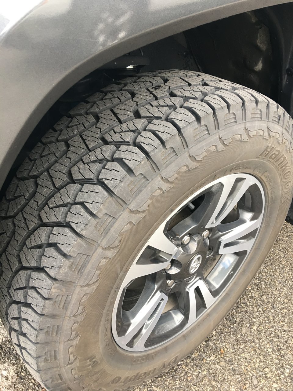

    I’ve got a set of Hankook DynaPro ATMs which I love. Had then on a 4Runner years ago. Still an awesome tire. Not overly noisy. Great in snow. Stock size, good looks.
    Very generic photo, sorry.
