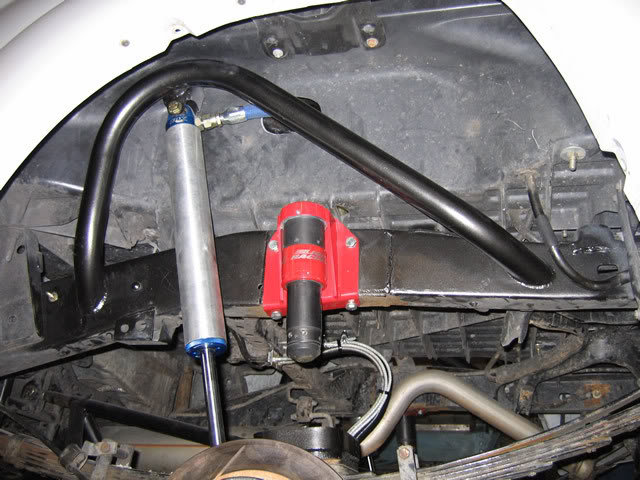

    Those Kings will not bolt up in the rear. You'll need some custom fab work to fit 'em. Most likely some custom shock hoops. You'll also need to modify the valving to work with your setup.
    You're looking at a performance shock designed to be used in custom applications. Set up properly they'll kick serious ass, but it'll take some work to get them set up right.

    For reference, here's the custom shock hoop I ran when I was running 2.5" 12" travel Fox shocks on the rear of my truck:

    how much did the custom fab run you?
