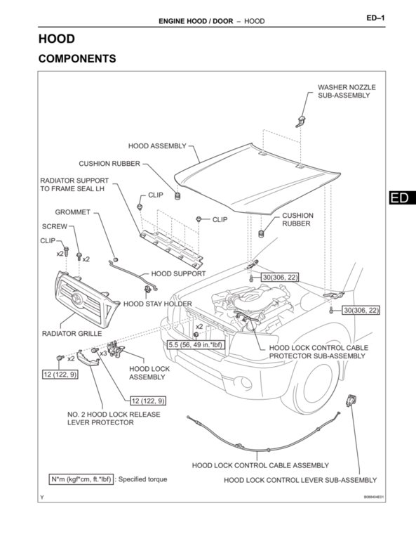

    On the hood itself on the corners, there are little cylindrical black rubber pieces that you can rotate to adjust the hood height. Lower the one on the passener side and see if it makes a difference. My money is on improper height adjustment

    There are two round, black rubber bumpers mounted on the underside of the hood. They adjust by turning. Try turning the driver's side CCW to make it longer.

    The part attached to the underside of the hood..."Cushion Rubber" in this diagram.
    Edit: Oops...posted too late...see the under-hood photo above, better perspective.

    If nothing else, a good body shop could adjust not only the rubber cushions, but check the adjustment of the mounting of the hood hinges themselves. Long shot, but, hey, you never know...

    I would be tempted to get a friend to hold one corner while I held the other and gave it a twist.
    But the right way is stops and hinge bolts. It’s not the grill.

    Yeah, it's the hood that's a bit out of adjustment, NOT the grille. Just diddle with the hood bumpers and you'll get it right...
