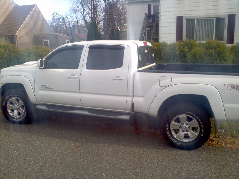

    Here's mine with a 2" spacer lift and tsb rear with new general grabber at2's 265/70-17
