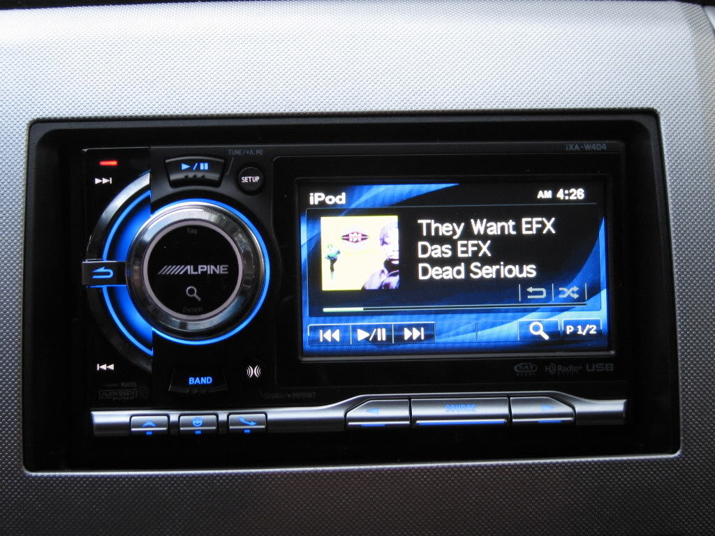

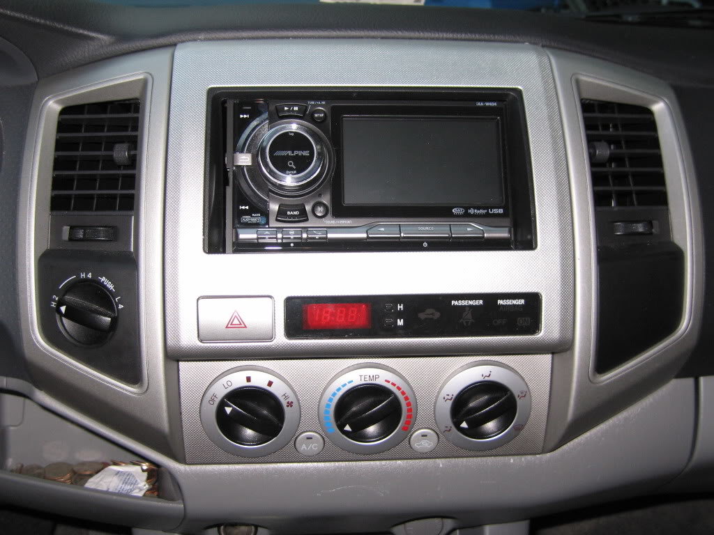

    I have the one from cruthfield also. It also vibrates to, and has small gaps on the sides.

    That Crutchfield kit looks to be made by Metra. There is a gap on the left of the HU and plastic mold flash at the top where it meets the dash just like a Metra...

    There are 3 choices that I'm aware of. Scosche which attempts to match the darker silver colored trim, but not well. Or the Metra textured in either silver or black.
    I've tried all 3.
    The Scosche fits ok, but uses plastic braces instead of the stock metal ones. With a heavy double din it will of course vibrate a bit and I found the edges of the face starting to squeak/rattle. Bothered the hell out of me. ...and the color matching is noticeably off.
    Metra Silver. As seen above looks pretty decent if you want to stick with the stock silver texture. But...the texturing is not a perfect match either. You'll notice that it's different than the texture below it on the stock A/C controls, but it's close enough that nobody will notice unless you point it out.
    Metra Black. This is what I finally decided on.
    Also, the Metra kits allow you to use the stock metal brackets which will hold the heavy dbl-din better. No squeaks yet.
