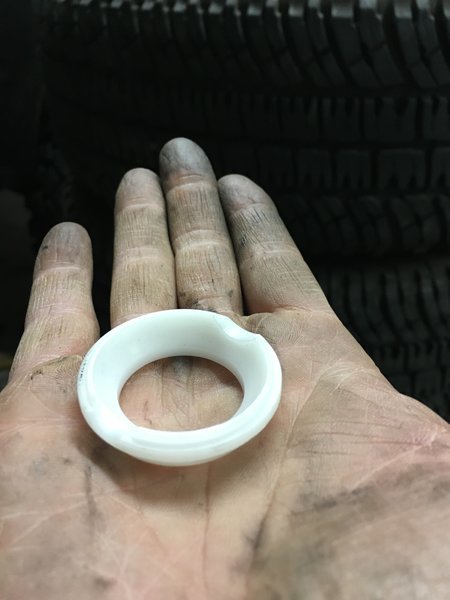

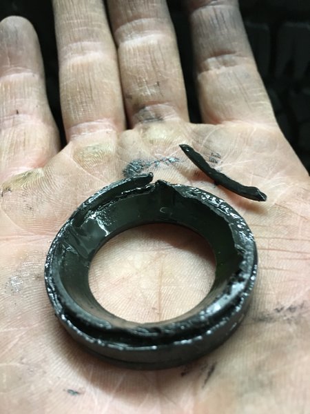

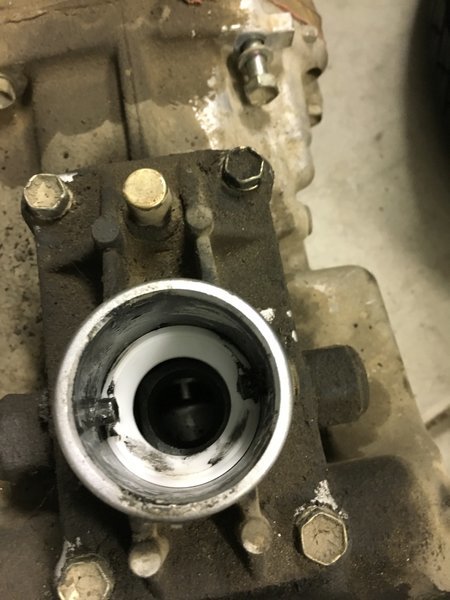

    Replacing the shifter bushing was helpful.

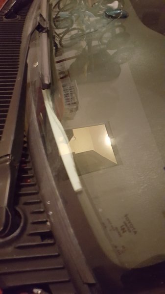

    Paper towel mod which fixed the last dash rattle

    Hey I GOT THE SAME WIPER blades man, what are those rainex?

    Hmm I sitting here thinking could we use a small rubber tube and slide it down there? For the dash rattle. It would be a black hose and match.

    I used backer rod. Works great and blends in perfectly

    What size did you use?

    I want to say 3/8". It's been a while though so I'm not 100% sure. Tomorrow I'll see if I have some lying around the garage still and measure it

    Oh im sure we can but i did this in 2013 or 2014 and its still working...so ive been a little lazy with it
