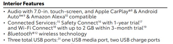

    Retrofit a 2020 Tacoma SR Entune unit that has CarPlay.
