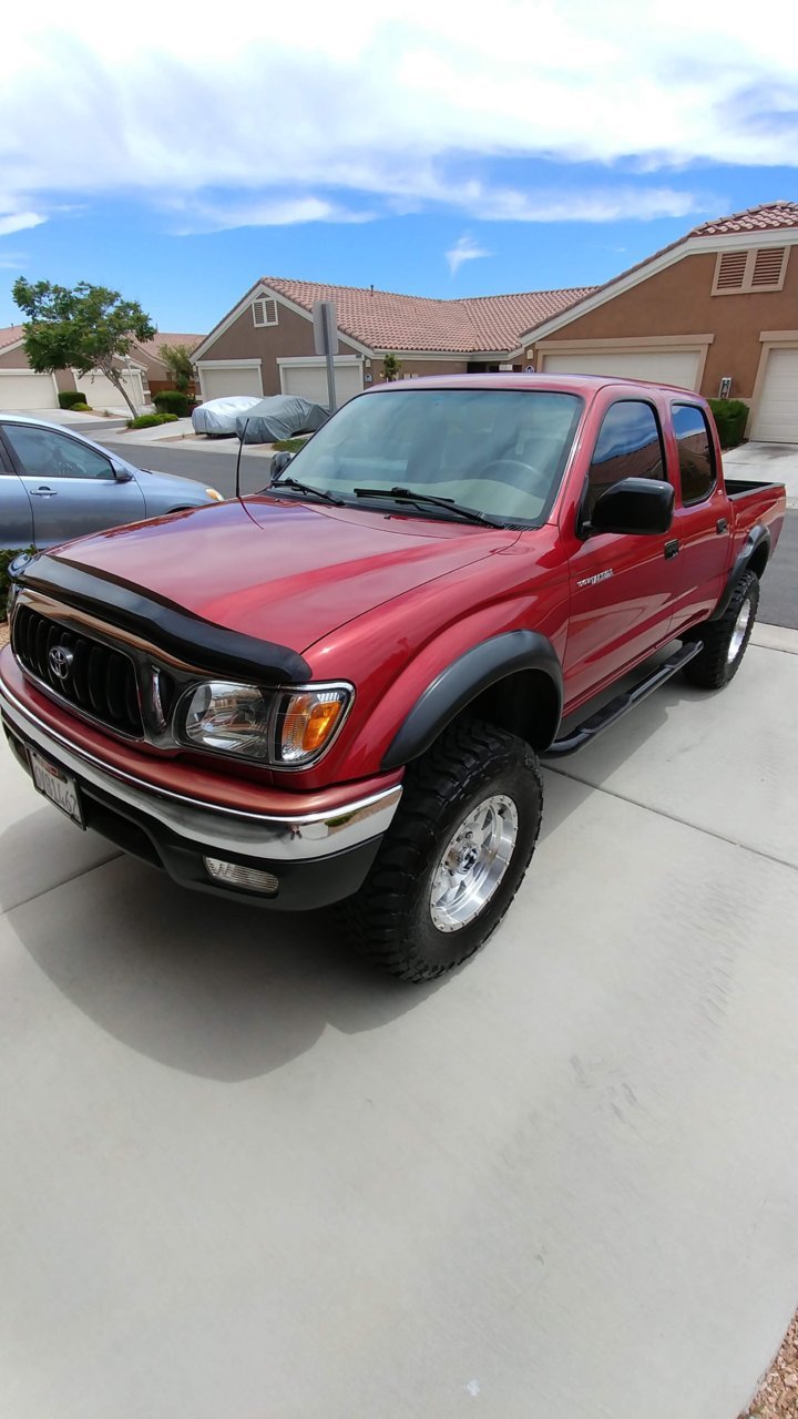

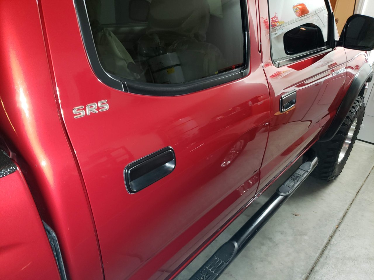

    No issues with paint on my 17yr old 74k mile Tacoma , this is the OEM paint and has a deep glossy shine

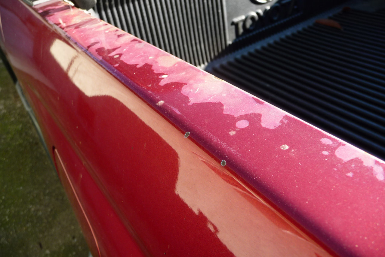

    I'm having clear coat issues on the bed rails. I'm not sure if I should scrape off the pealing coat to keep water from spreading the issue. I have no idea how to contain this small issue before it becomes a whole clear spray. The rest of the truck looks amazing as I clay bar it and use high quality wax twice a year along with spray wax/detailer in between. It does sit in hot Southern California sunlight year round.

    I had a clearcoat on a shell fail from high pressure washing in an automated car wash and it looked exactly like that but the paint could be restored. I had to clean up the flaking clear coat with 600/1000/1500 wetordry and magic erasers then used the rattle can spray on 2k clearcoat with a respirator and it came out nearly perfect where I bothered to feather the clearcoat edge perfectly and was visible where I didn’t. You can find that clear on Amazon for around $25 per can. The failing clearcoat was progressing and needed to be fixed as it was worsening monthly.
    Adding some duplicolor first would likely get that back in shape.

    I bought my truck a few years back from a dealer and pretty sure they sprayed the clear coat way too thick or at least it looks as though it was. I do notice when it rains the trapped water between the clear and color coat spreads it quicker. I'll try your technique before my idea of pulling the plastic bed liner and rolling on a liner which I would coat the the tops of the bed rails with the roll on liner paint. Are the magic erasers the kitchen types. Thanks for the tip.
