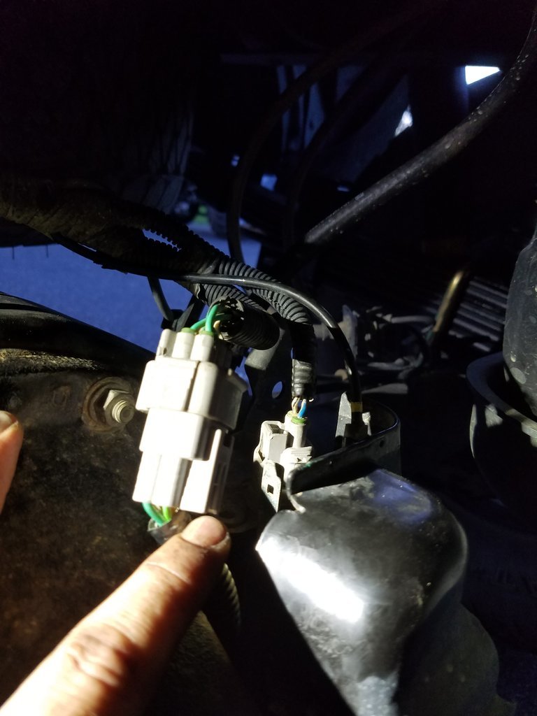

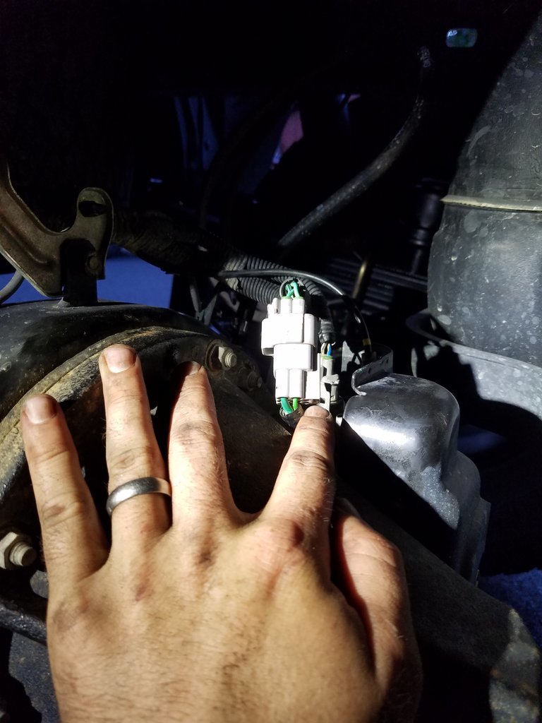

    Came across this plug while putting in my new suspension. It was unplugged and I've never messed with it. Took a picture after plugging it back in to verify what it is20170819_200030.jpg 20170819_200026.jpg

    Do you have the off road package? Could be the e-locker

    I do and that would make a ton of sense because the last time I tried to use it in couldn't figure out why it wouldn't kick on. I've so rarely needed it I didn't really think too much about it after the fact

    its the connector for the rear diff lock up, I tell me customers to push the button every couple of weeks to keep it free and lubed, just like engaging the transfer to keep it lubed up
