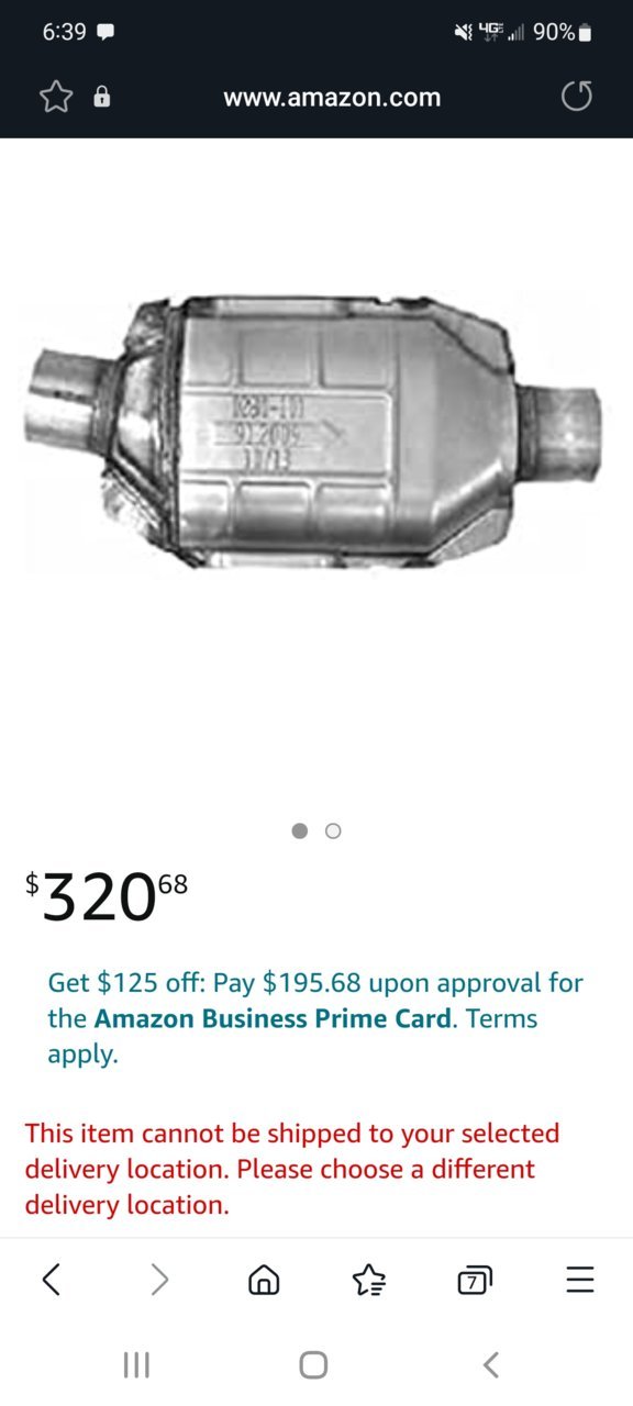

    A quick CARB EO search and shows AP exhaust part number 912009 should be stamped with EO#D-280-101, not D798-7.
    See link: https://arb.parts/Vehicle/2001/Toyota/Tacoma
    When search CARB EO#D798-7, it shows that number is approved for AP exhaust use but don't list an associate part number or what is for. Meaning the EO# is CARB compliance but not tied to any aftermarket AP exhaust parts yet.
    But a search with autozone with AP exhaust part number, it shows 912009 is not compatible with your 2001 5vz. When searching through what fit, autozone don't list AP exhaust as having a CA legal front cat. And Amazon won't ship that AP part number to California.
