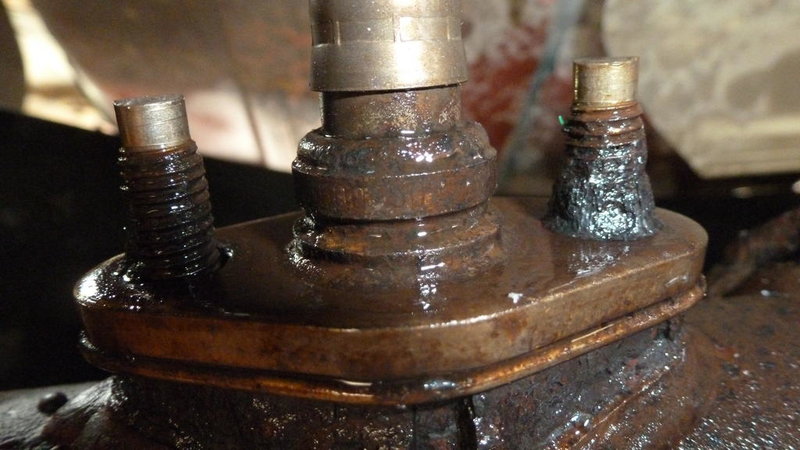

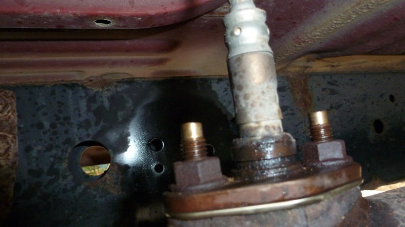

    The first Photo shows #1 Oxygen Sensor, it's missing one Nut and the other is almost gone. I need to take it out so i can clean it or replace it, the 2nd photo shows #2 (all normal). I'm afraid to start working on the 1st before asking what and what not to do. Any Advise? Thank you!

    Wow I'd say that nut has had it! I imagine if your careful enough not to damage the threads you could try some slip-joint pliers (aka channel locks) and try to take it off and hope it just falls to pieces. Does'nt look like much is holding it, good luck!

    depending on the miles on your truck I would say its time to replace. i believe its a 10mm nut, if not its a 12mm.
    http://www.lieblweb.com/o2replacement.html
    here is the step by step i did mine, it made a difference on how she runs.

    I just replaced my front one because it was throwing a code. It was 12mm
