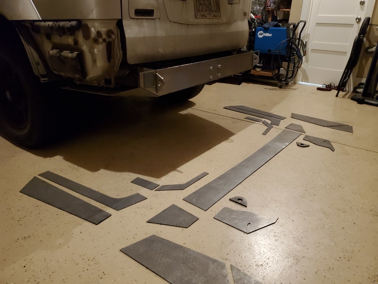

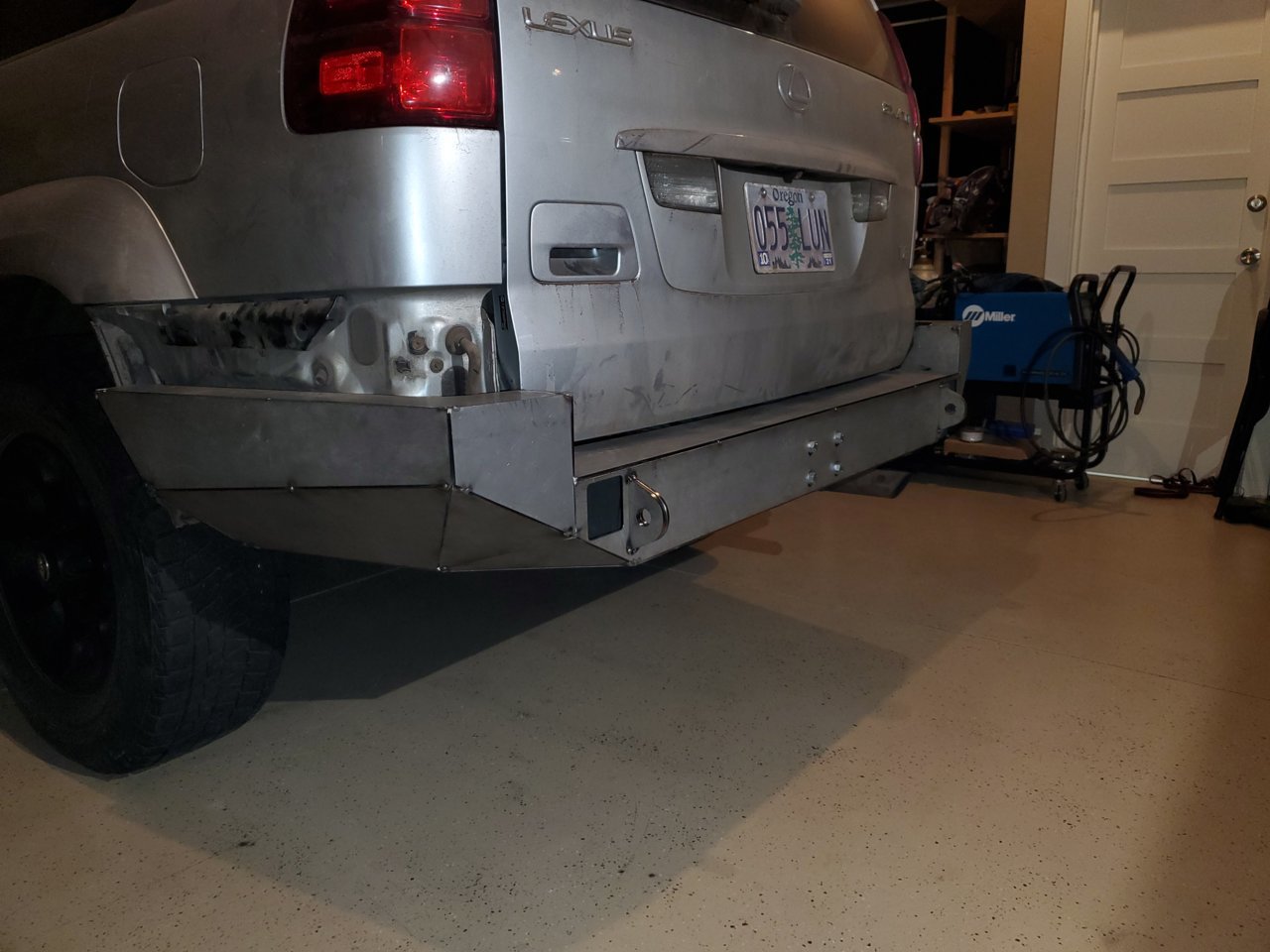

    Spent the majority of the day in prep (chasing all existing holes with taps, drilling/tapping new holes, compressor relocation, grinding frame smooth etc). Finally got around to laying some glue toward the end of the day. Starting to look like a bumper...

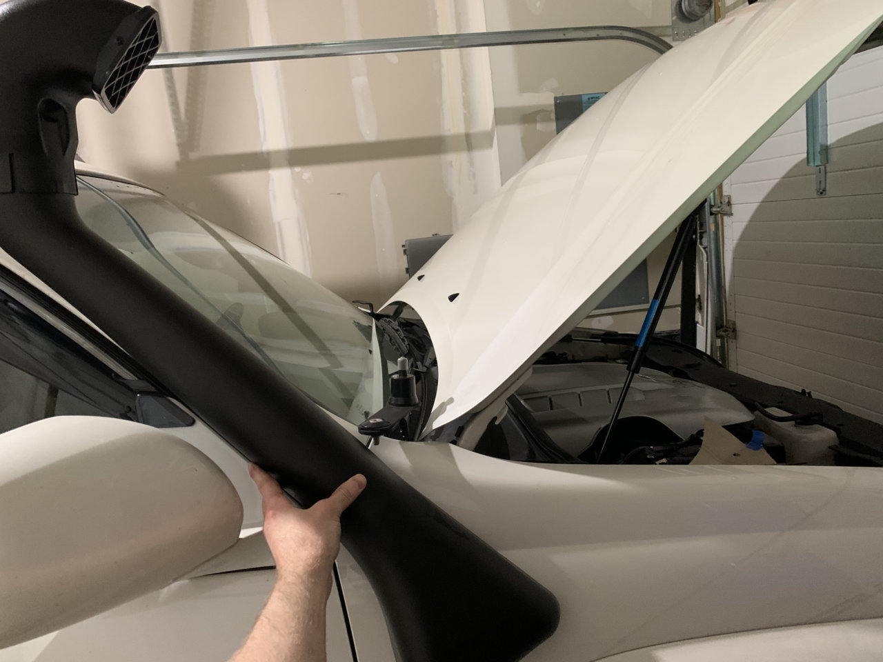

    2nd gen
    1st gen Taco/3rd gen 4Runner
    I like this design compared to the prado type
    I’m running into some very much expected clearance issues but have a low profile type connector and some upgraded intake pipe on the way to bridge the gap from the snorkel to factory air box.

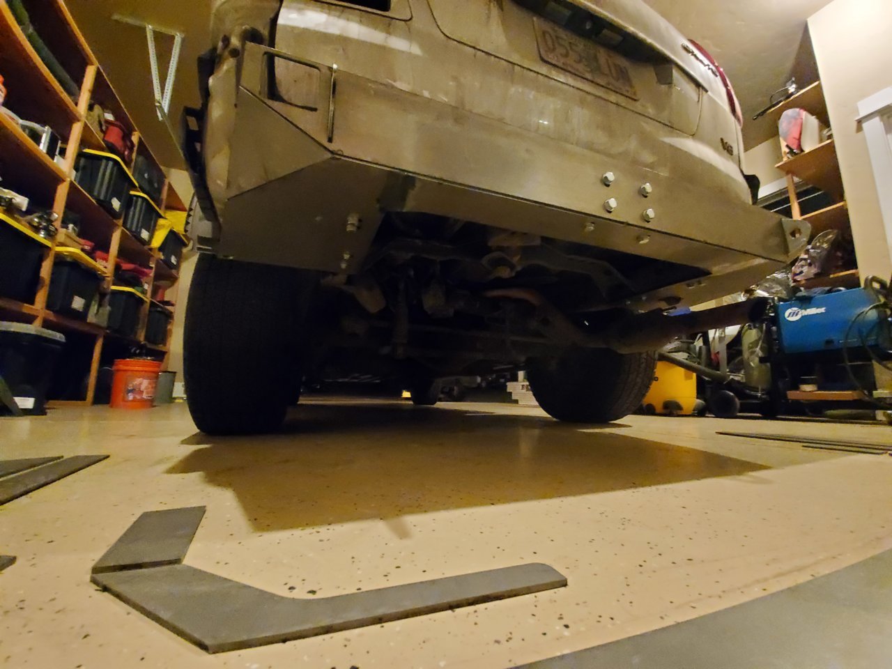

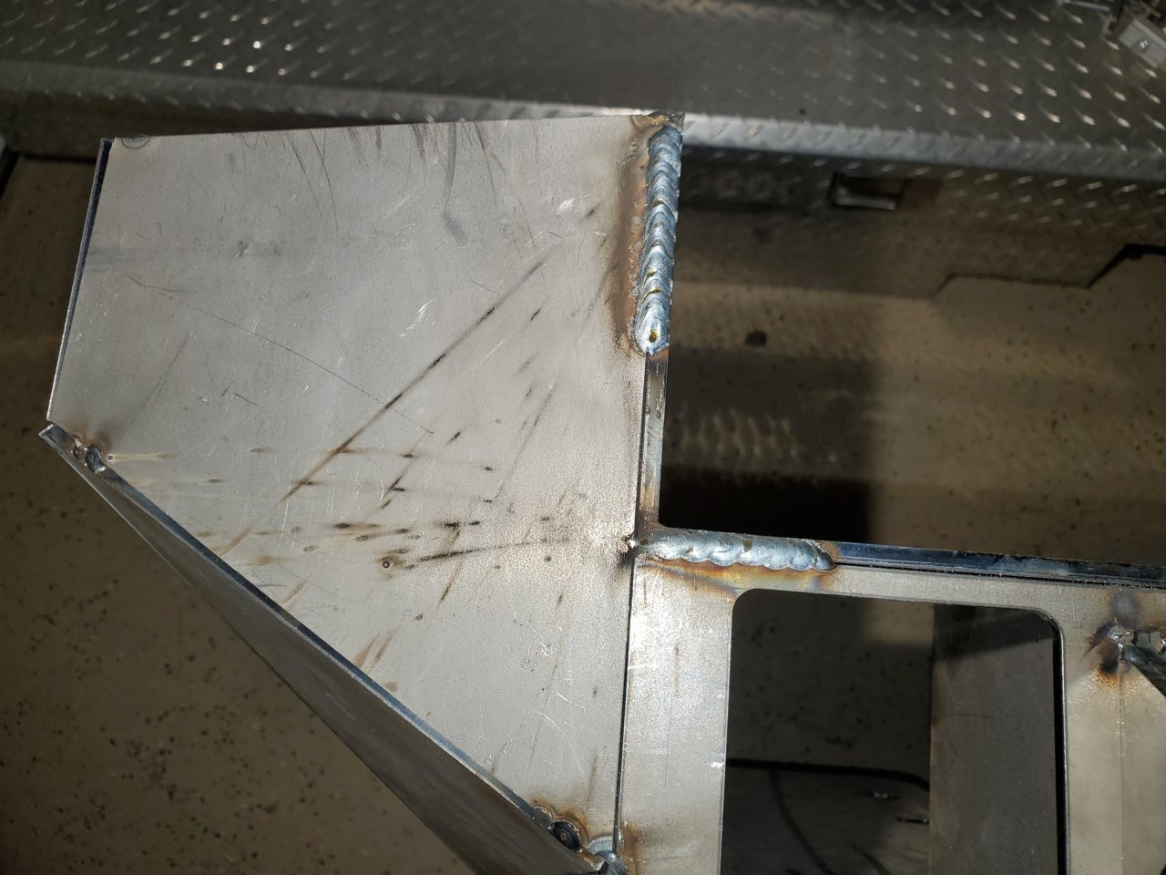

    2000 Tacoma 3.4 TRD "Stock AF" & 2006 GX470 Sport

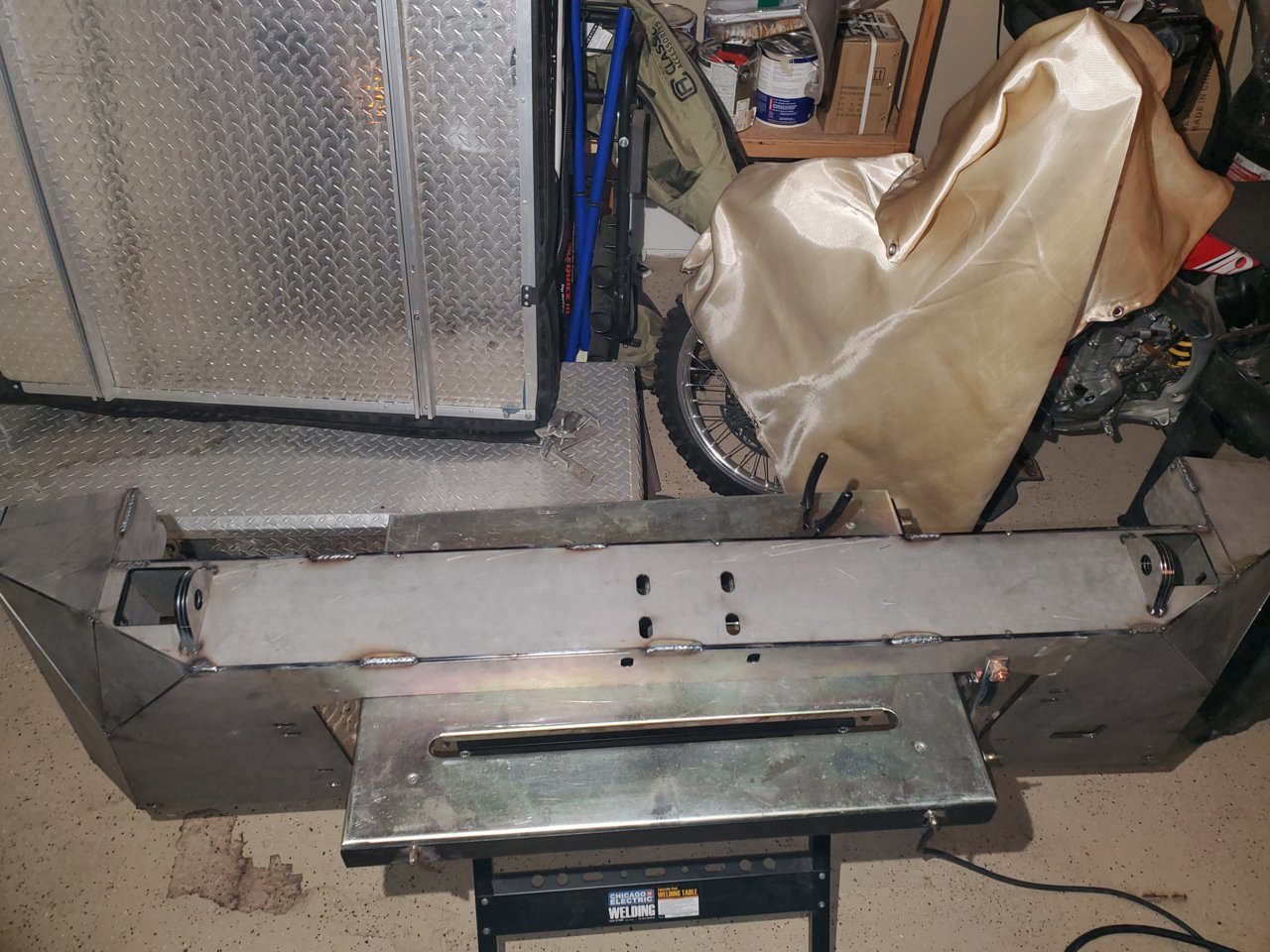

    Bumper is all tacked together. Got it removed for the final welding...
    wvlexus and w.adventures like this.
  14. Jan 1, 2021 at 5:34 PM
    #274
    w.adventures
    w.adventures Adventure is out there
    Nov 28, 2013
    #117482
    11,482
    Nowheresville, SC
    2005 Lexus GX470 Family Hauler
    Good looking welds!

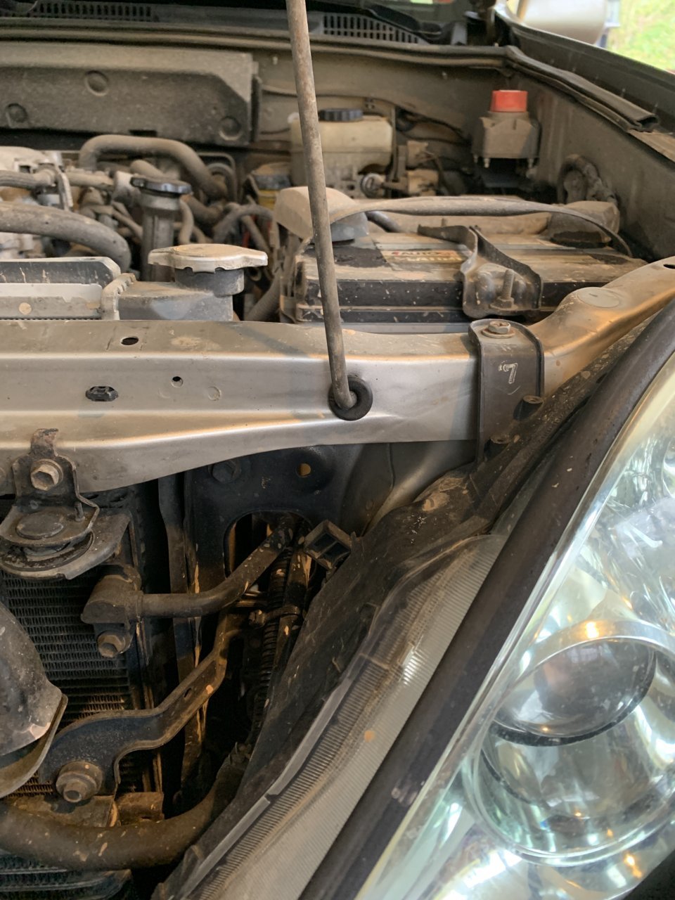

    E7D42AA8-AF41-41A8-BB44-FE9A04DD54FF.jpg E7F836D8-EA08-430F-9365-08632DD61650.jpg 7696ECF0-8781-4DA3-B8DE-70D7BBD18932.jpg No more hood struts.

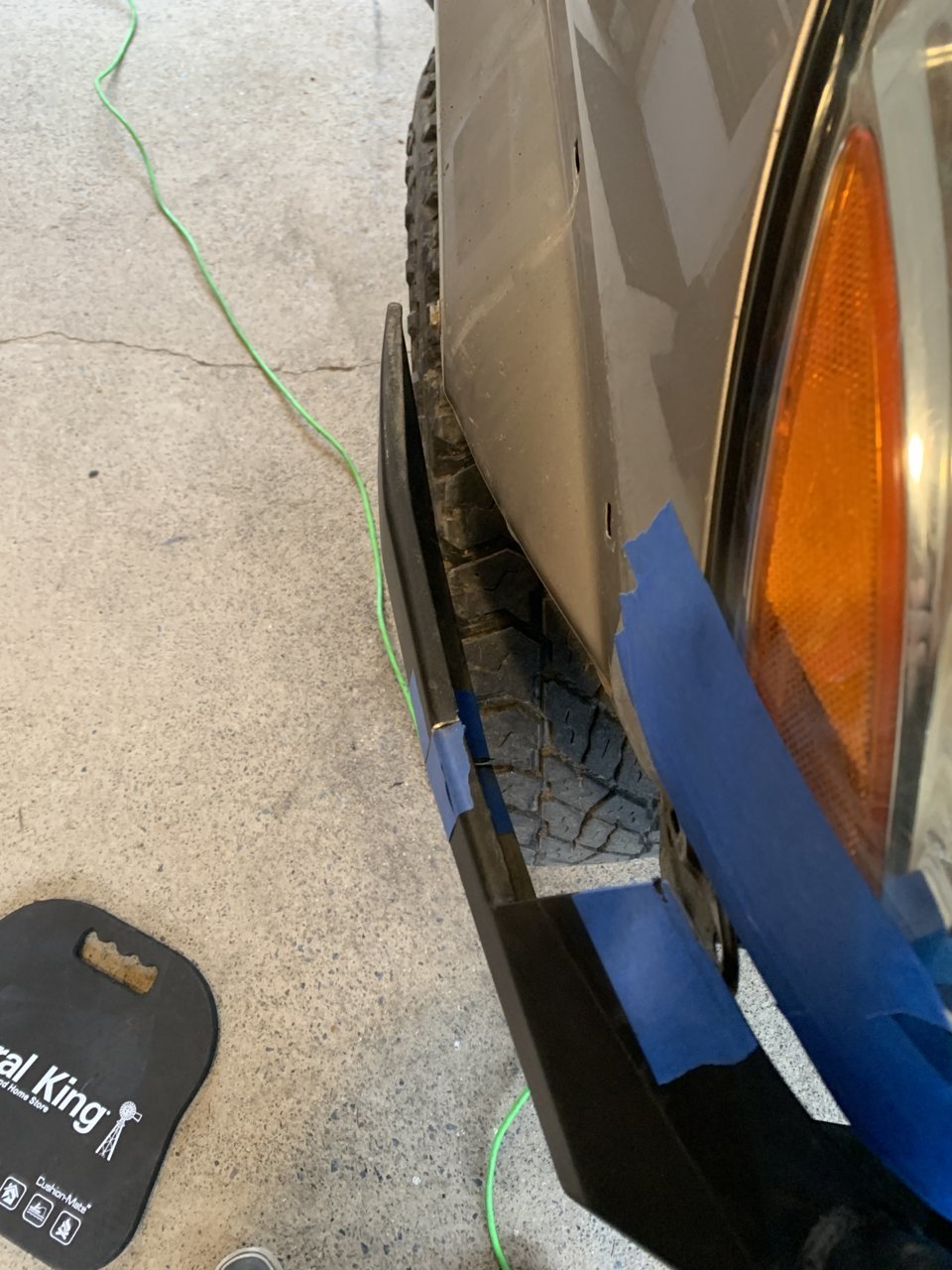

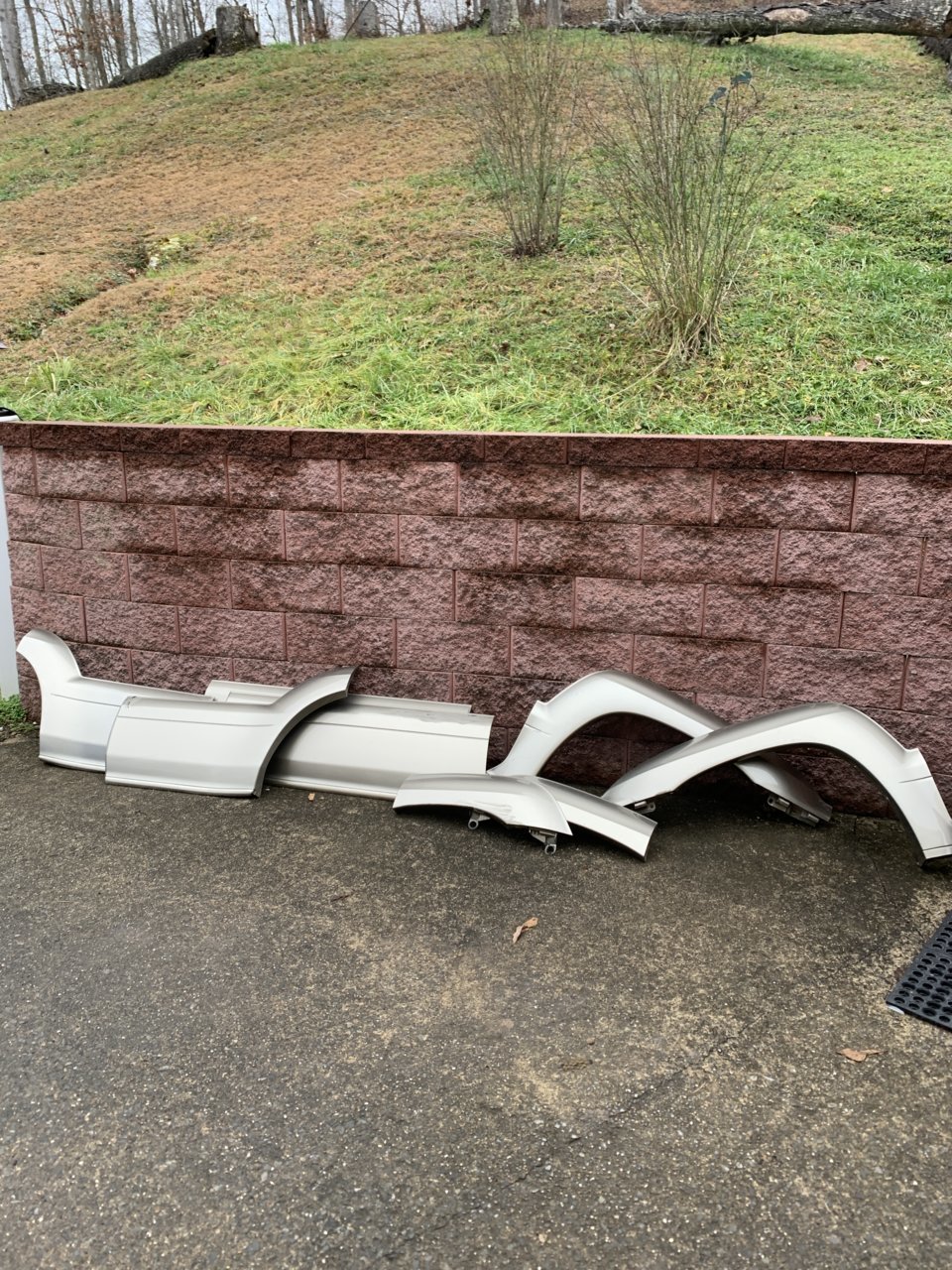

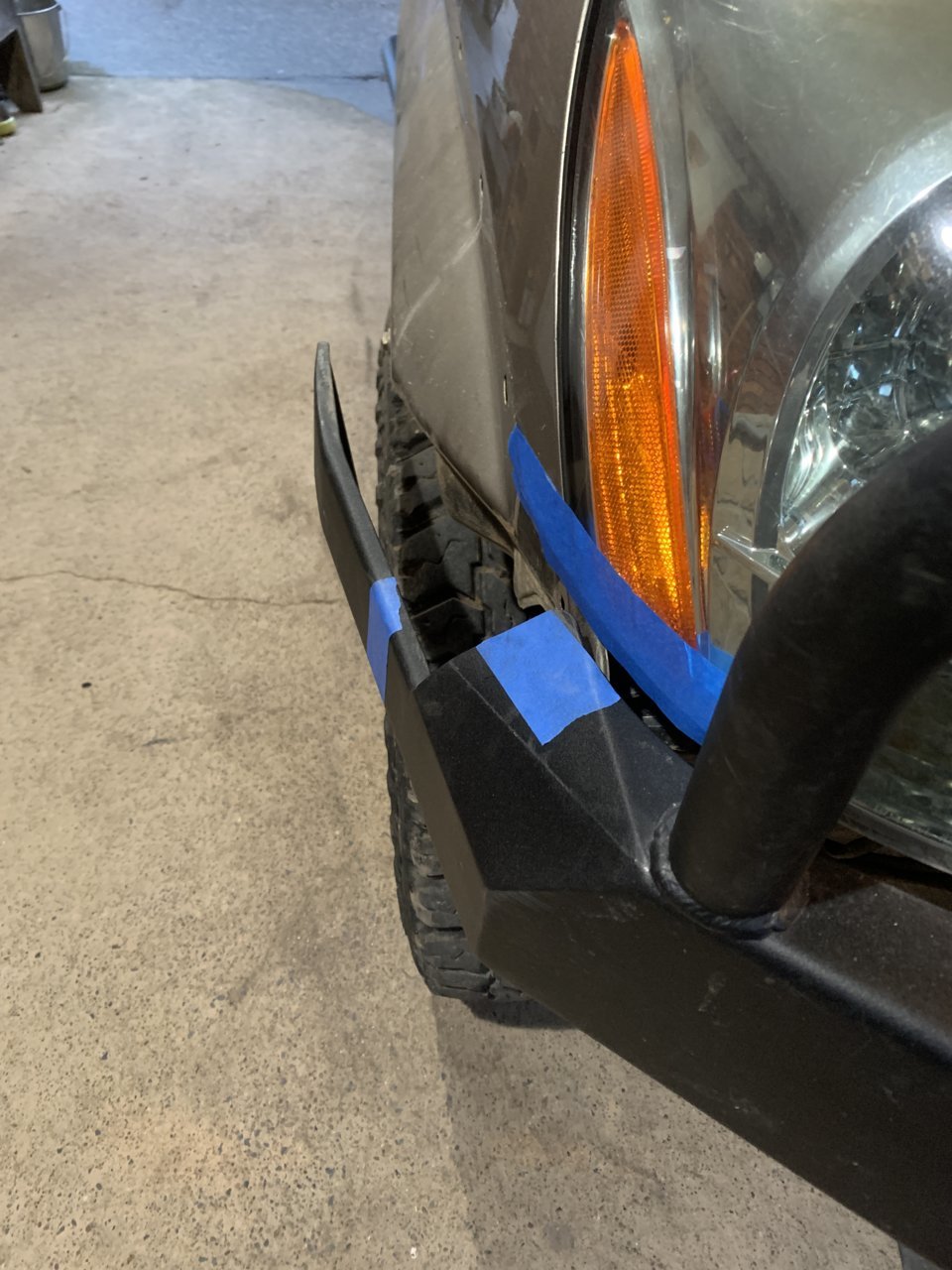

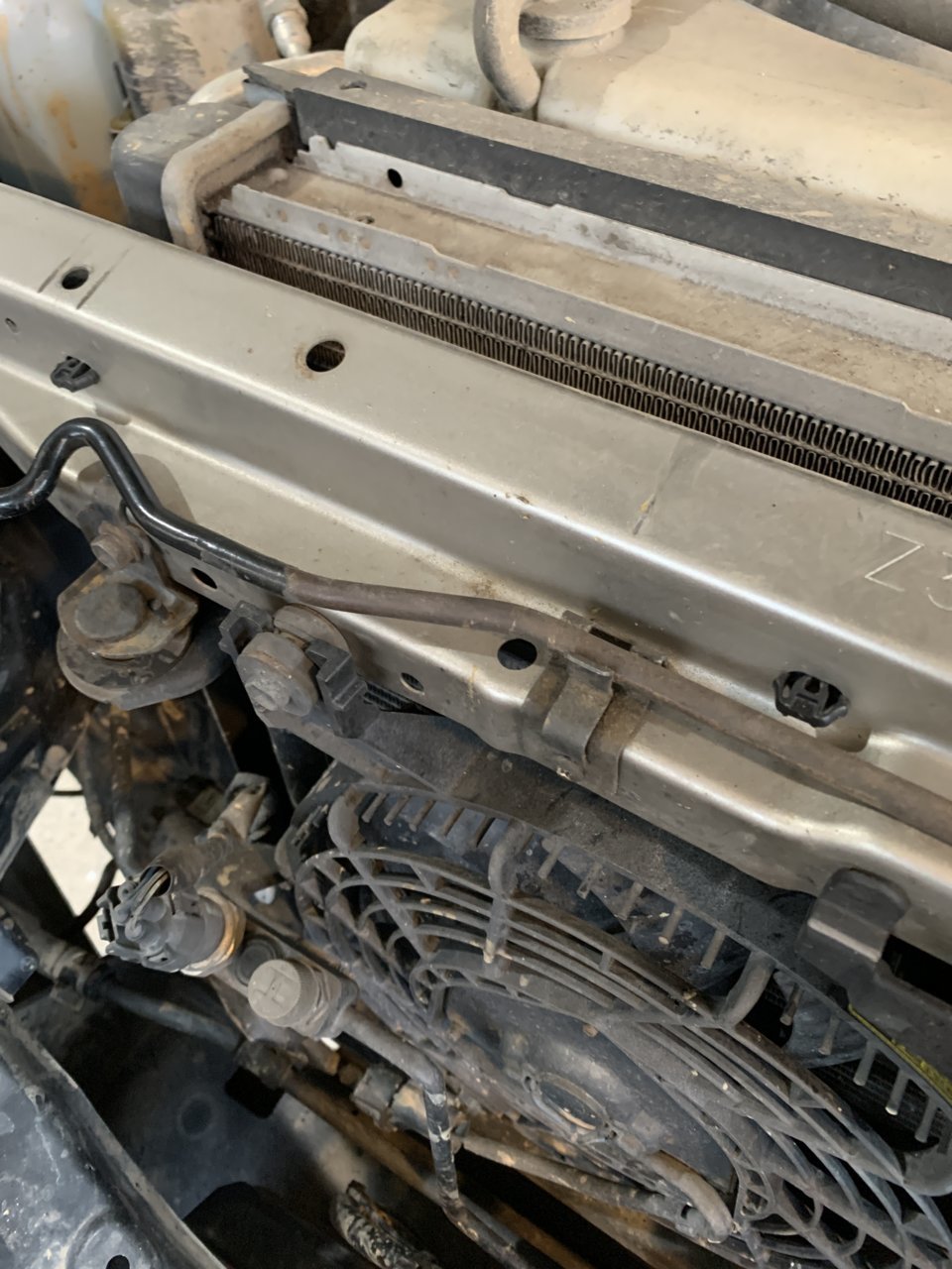

    Landwagon

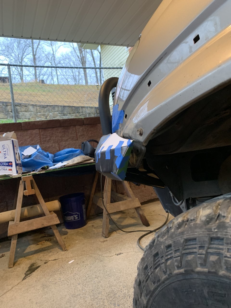

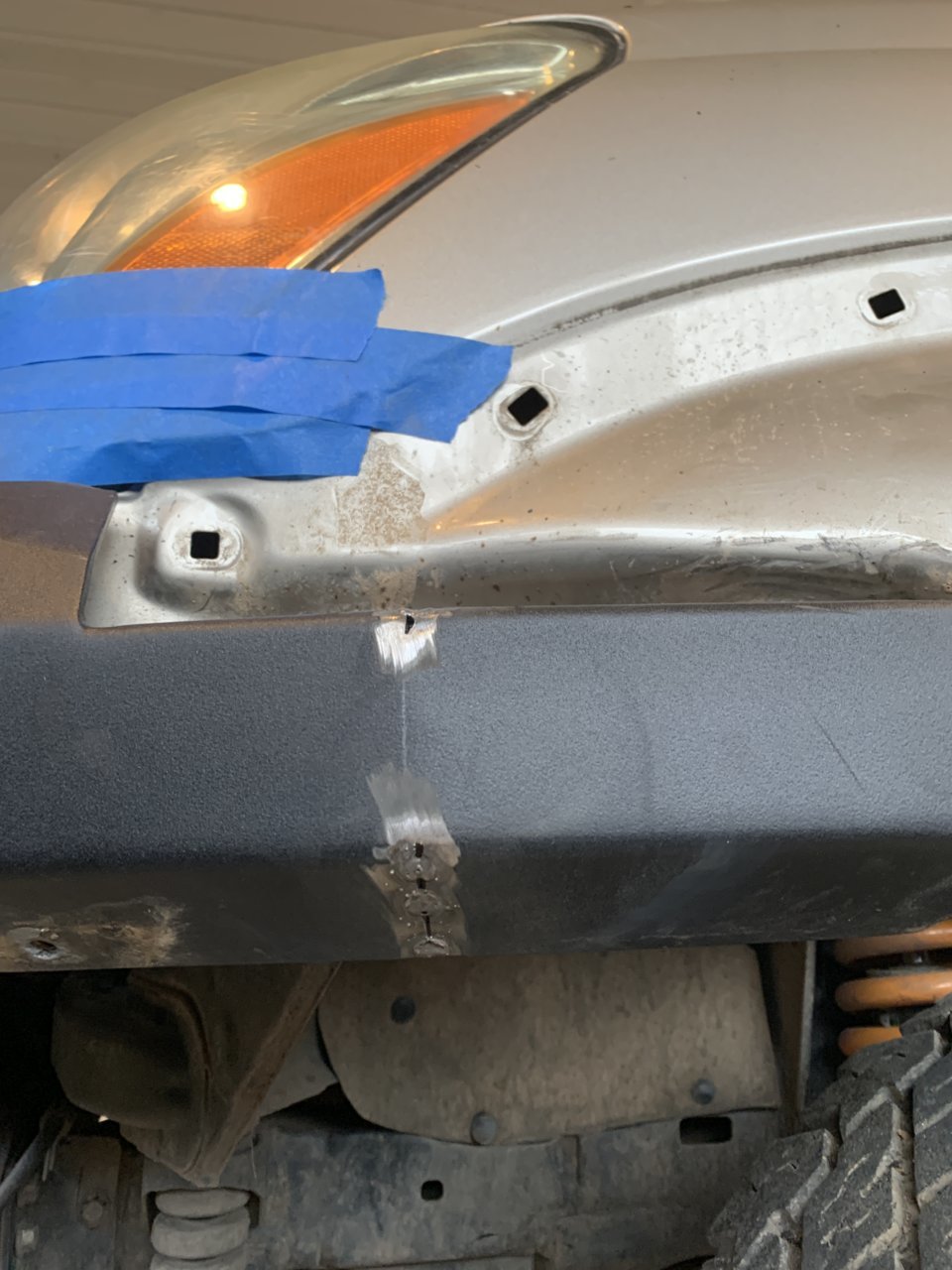

    Started making the front bumper closer to the body since the flares are gone.086C259C-862B-440A-B601-0AAF03EEAD76.jpg7BABC35F-4053-4C0C-81AD-955DEAD9FD63.jpg7FECE0E7-9C56-44C4-AB67-373D2FAD39AA.jpg

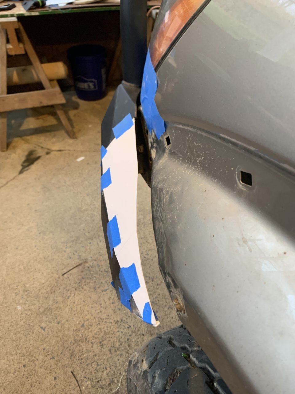

    And got the templets made F5909489-D7D4-4C0C-9878-C82DFE7347F1.jpg1FB4041A-5268-41AF-9E59-30416F8D2FAF.jpg
