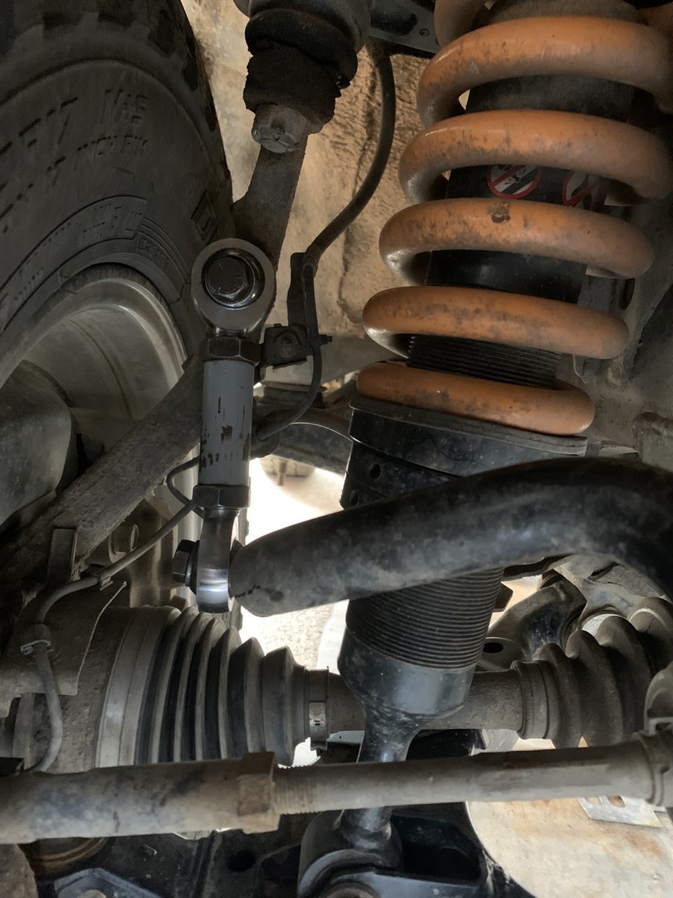

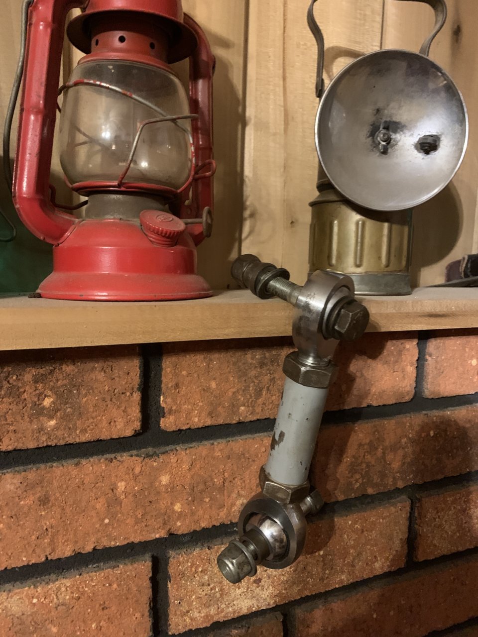

    1CCCE77B-0EFC-4A71-A75D-6E3C676086FE.jpg Getting ready to put my front sway bar back on so AllPro Off-road link maintenance and cleaning today.

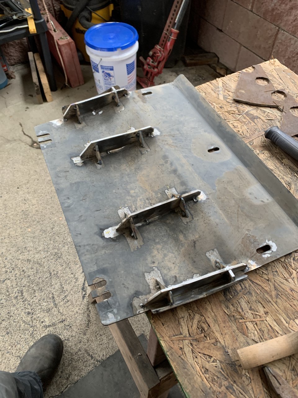

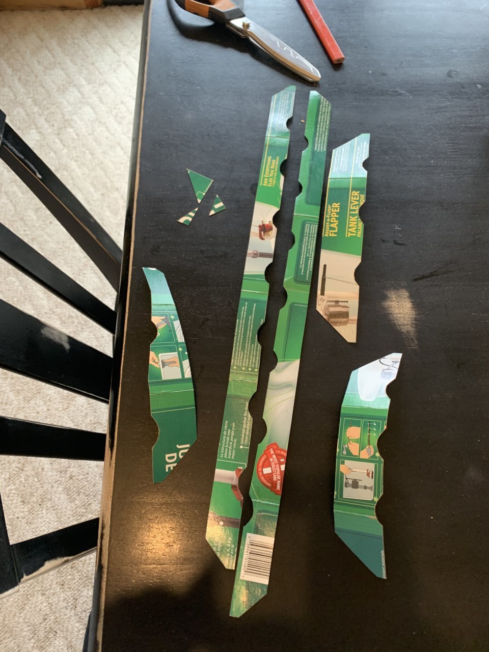

    Since every time I go to a TLCA event I bend my skid plates.359396EA-57DA-4C5E-AEFB-1952CF64C277.jpg I’m going to gusset them up good.

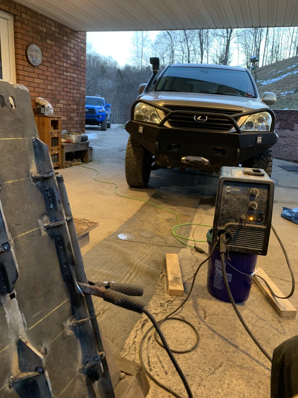

    Transfer case skid 1B3EDCD6-2CE1-45F7-91EB-82795F7D8DA0.jpgF1E9651B-A9DA-46F8-8C61-E6ECFA3261B9.jpg

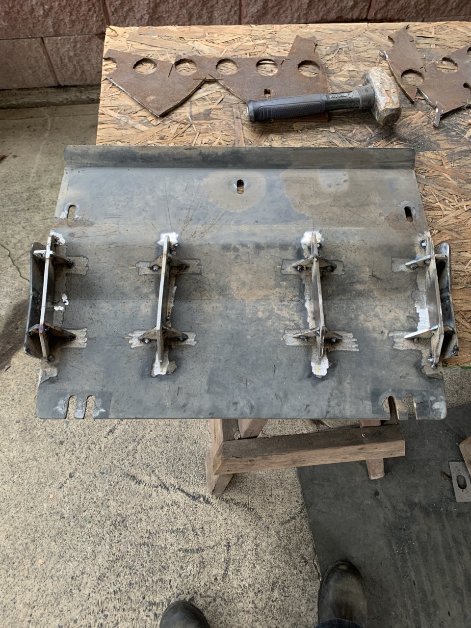

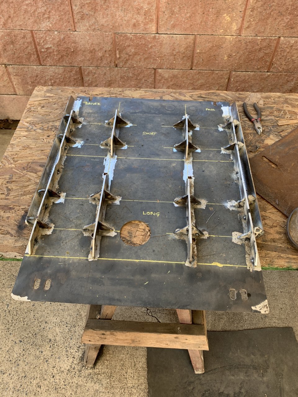

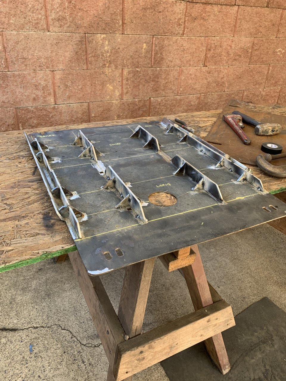

    987FA5E0-0D65-4B8E-9C8F-4A579A5BEE35.jpg D2B7825F-9D99-4598-931A-E6EFBF432C0E.jpg Transmission skid tacked up.

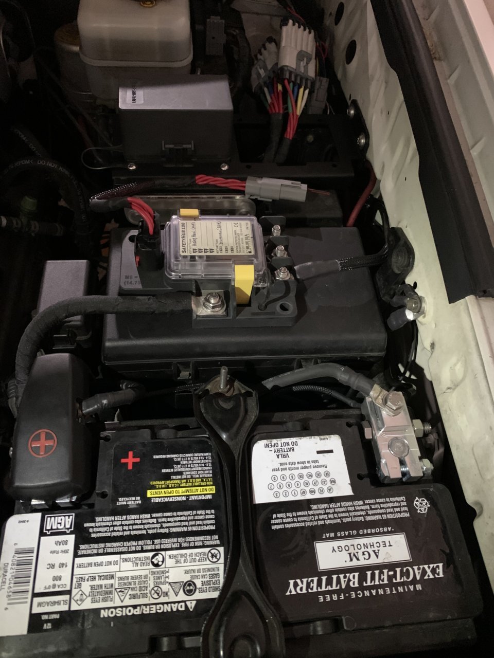

    Getting the electrical finalized. Probably will swap the metripack connectors to a Deutsch bulkhead connector to keep things cleaner. Plus I can make it so it mounts to a blank I’ll cut out for that empty spot next to my RTMR. Will look much cleaner.
    The safety hub is my higher fuse distribution block. One wire goes off to the Bussman.

    What skids are those?
  20. Feb 3, 2021 at 6:03 PM
    #340
    wvlexus
    wvlexus Well-Known Member
    Oct 15, 2017
    #233088
    182
    Landwagon
    RCI I bend the crap out of them all the time.
