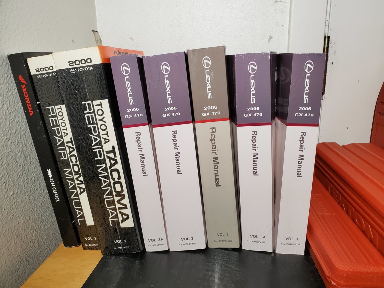

  16. Jan 13, 2020 at 6:54 PM
    #36
    Gen1FTMFW
    Gen1FTMFW [OP] Well-Known Member
    Feb 20, 2017
    #211192
    2,686
    2000 Tacoma 3.4 TRD "Stock AF" & 2006 GX470 Sport
