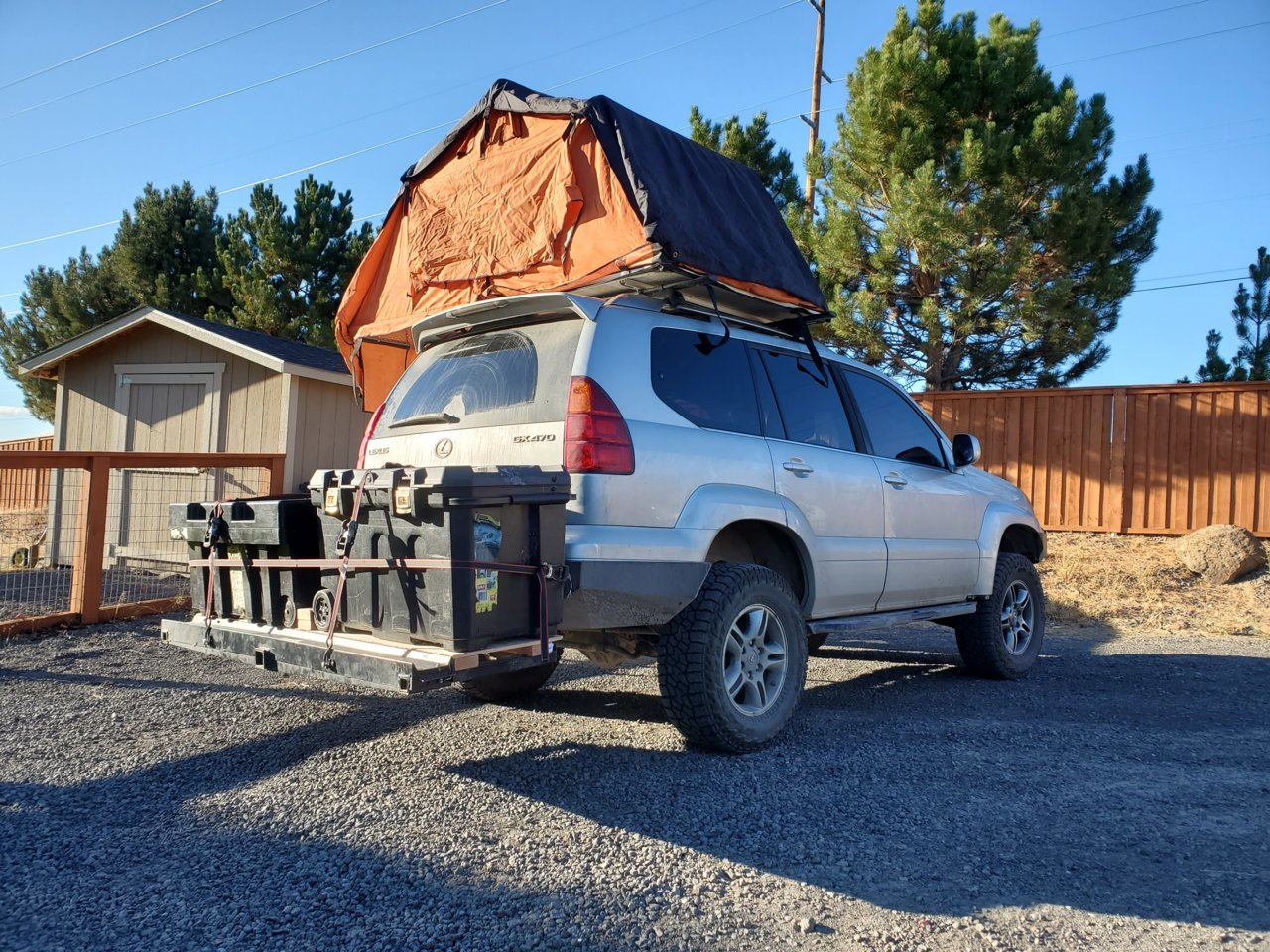

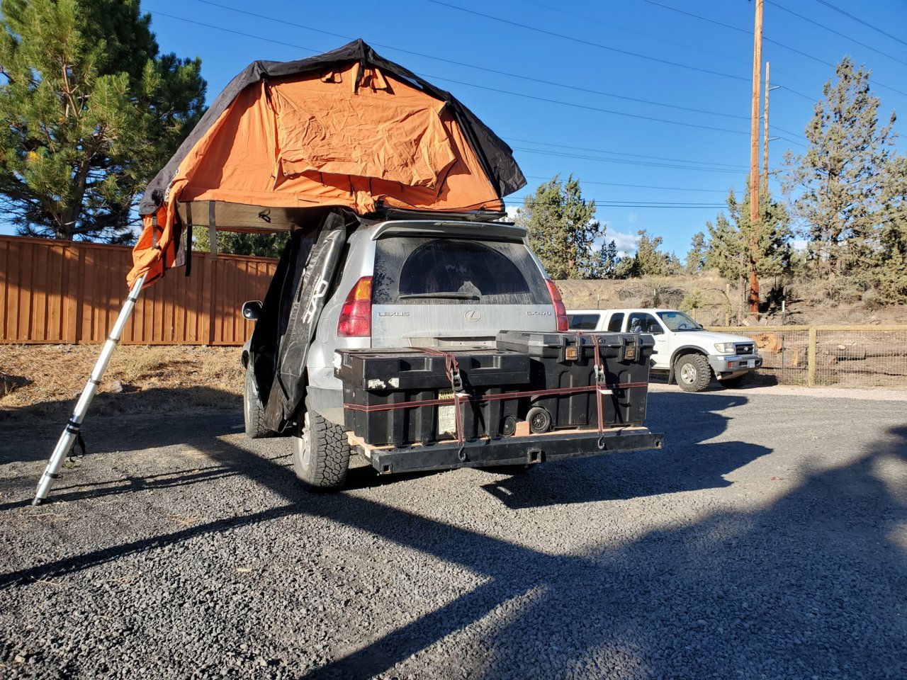

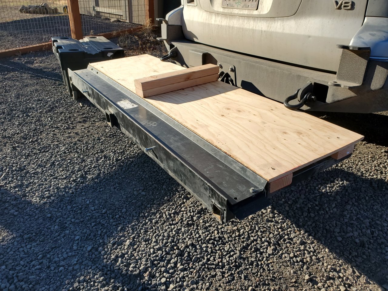

    Ordered a hitch mounted cargo carrier for an upcoming trip, but it got delayed and won't get here in time. Ended up spending most of my day making a platform for totes out of a motorcycle carrier. Came out pretty solid, looking forward a week on the road through some beautiful country...

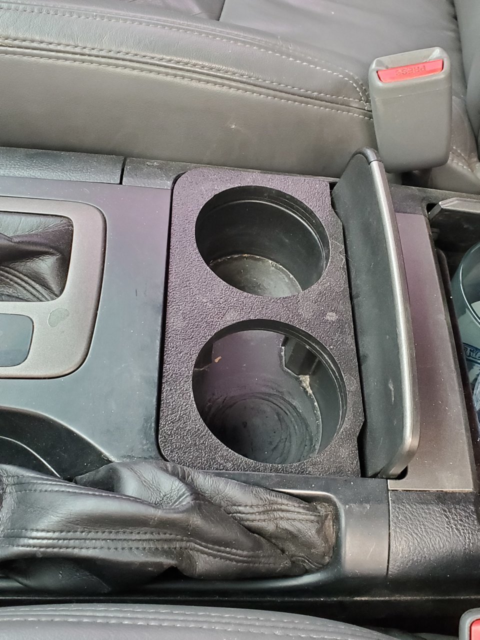

    I've seen a few people on IH8MUD that have done the prado console swap. As far as the cupholders go, I bought some online that work pretty good...
    Can be found here...
    https://crafted-by-matt.com/collections/frontpage/products/gx470-drink-holder-insert

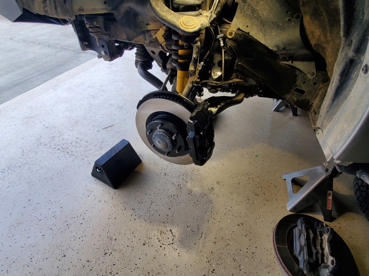

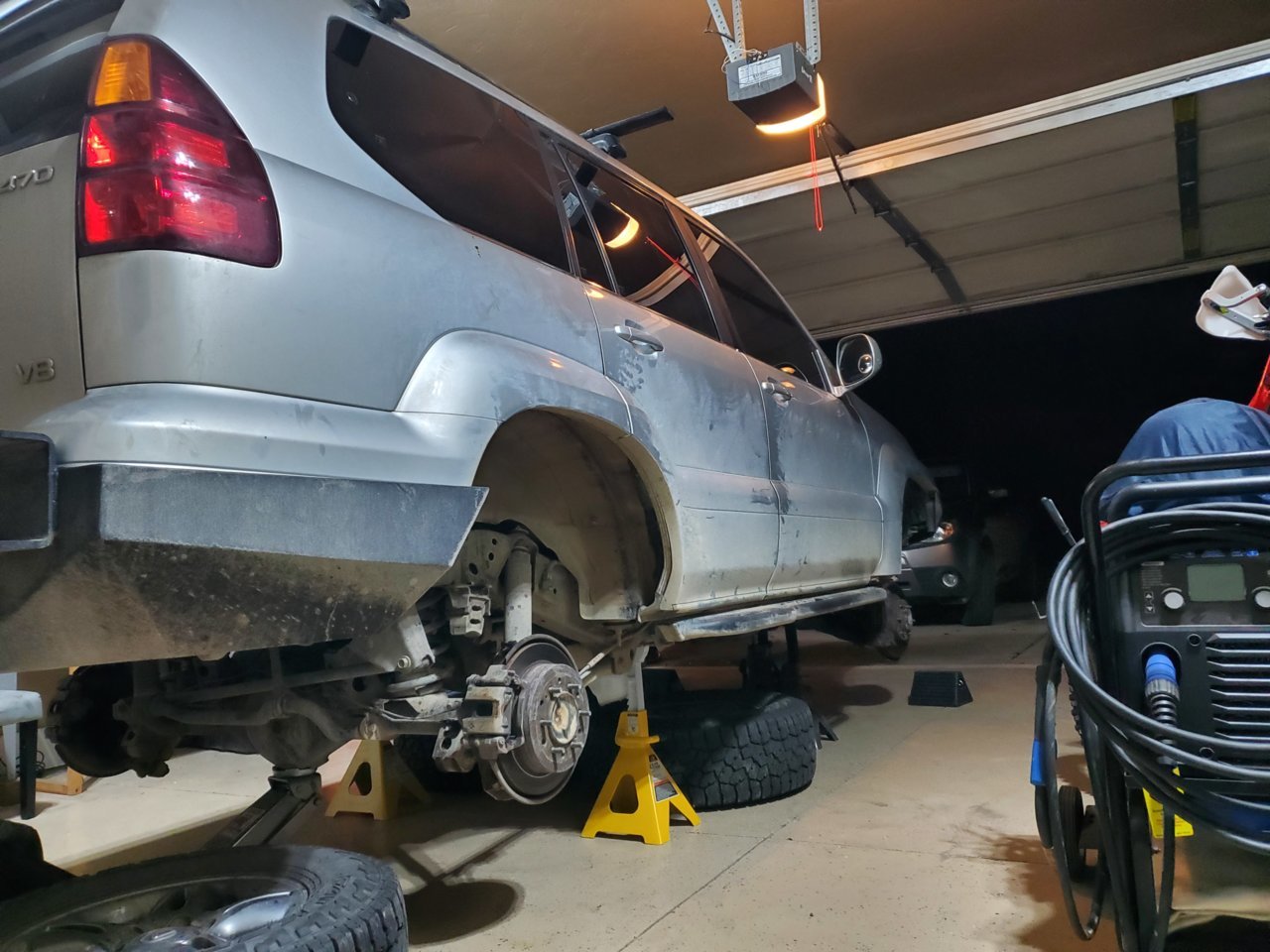

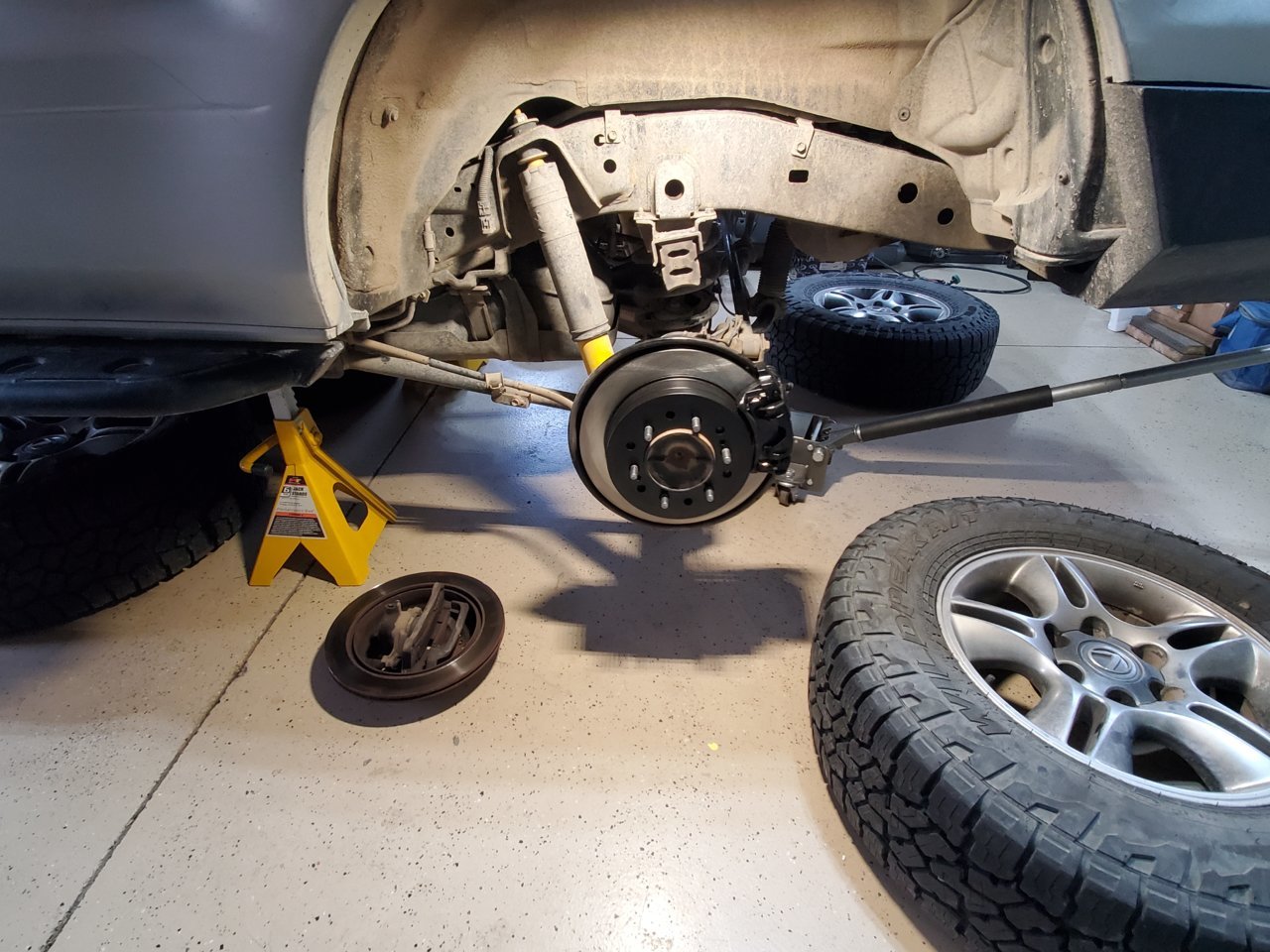

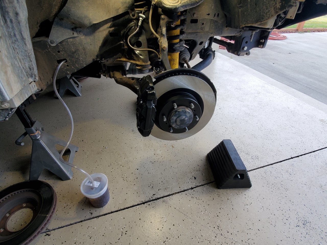

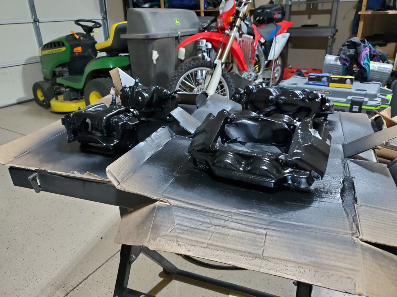

    Have brakes ready for all 4 corners. Doing the 460 swap in the front thanks to a deal from @SearArtist. Got her up off the ground and getting ready for install...

    One corner done...

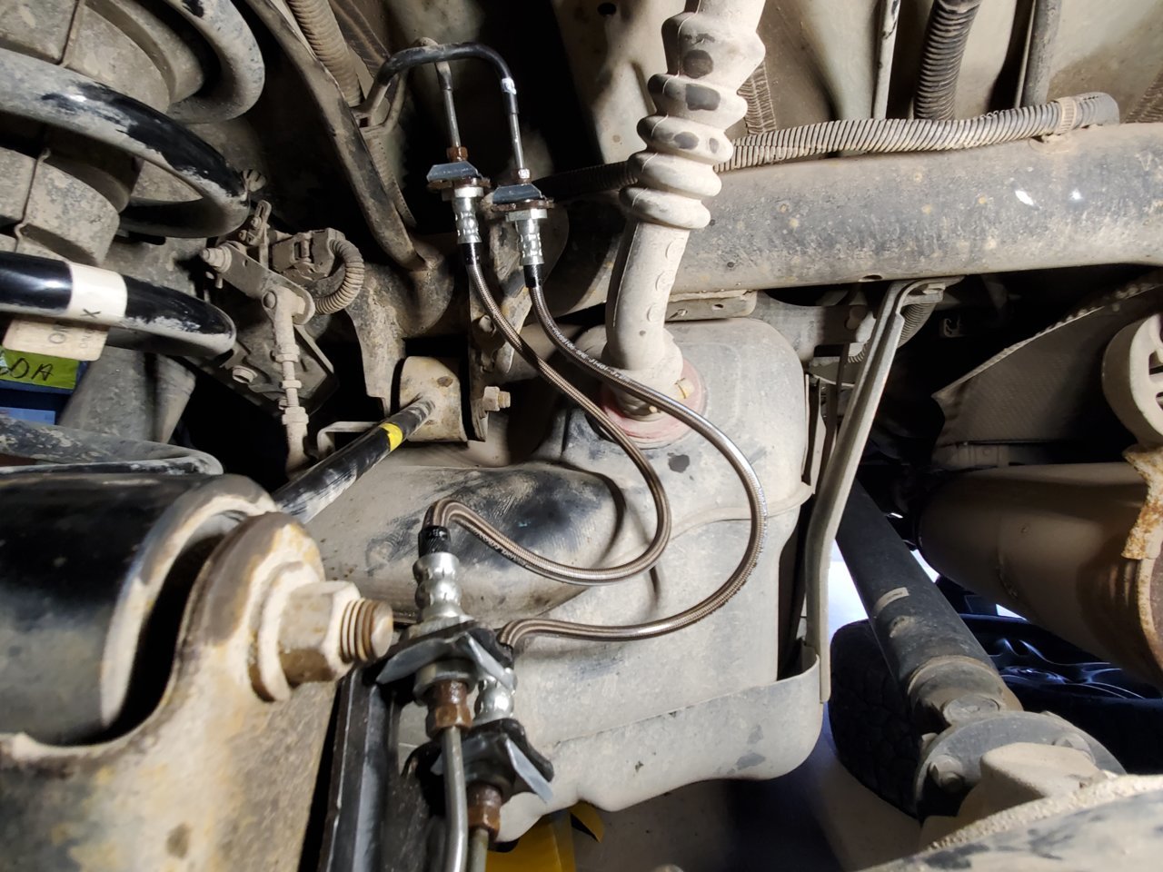

    Other side done along with extended rear lines. Gonna keep an eye on them and may move them around a bit if they hang up on the tank.

    Pads/rotors/calipers/lines on all 4 corners complete...

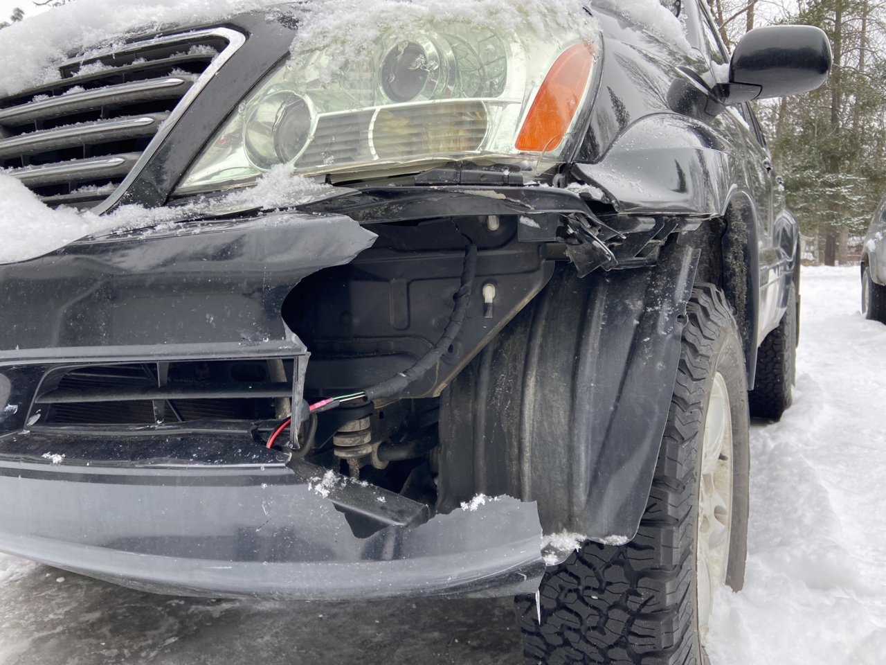

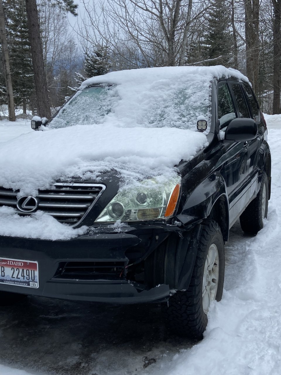

    Thanks to super icy roads we went from this
    To this
    FIRE74, jlemmond and Gen1FTMFW[OP] like this.

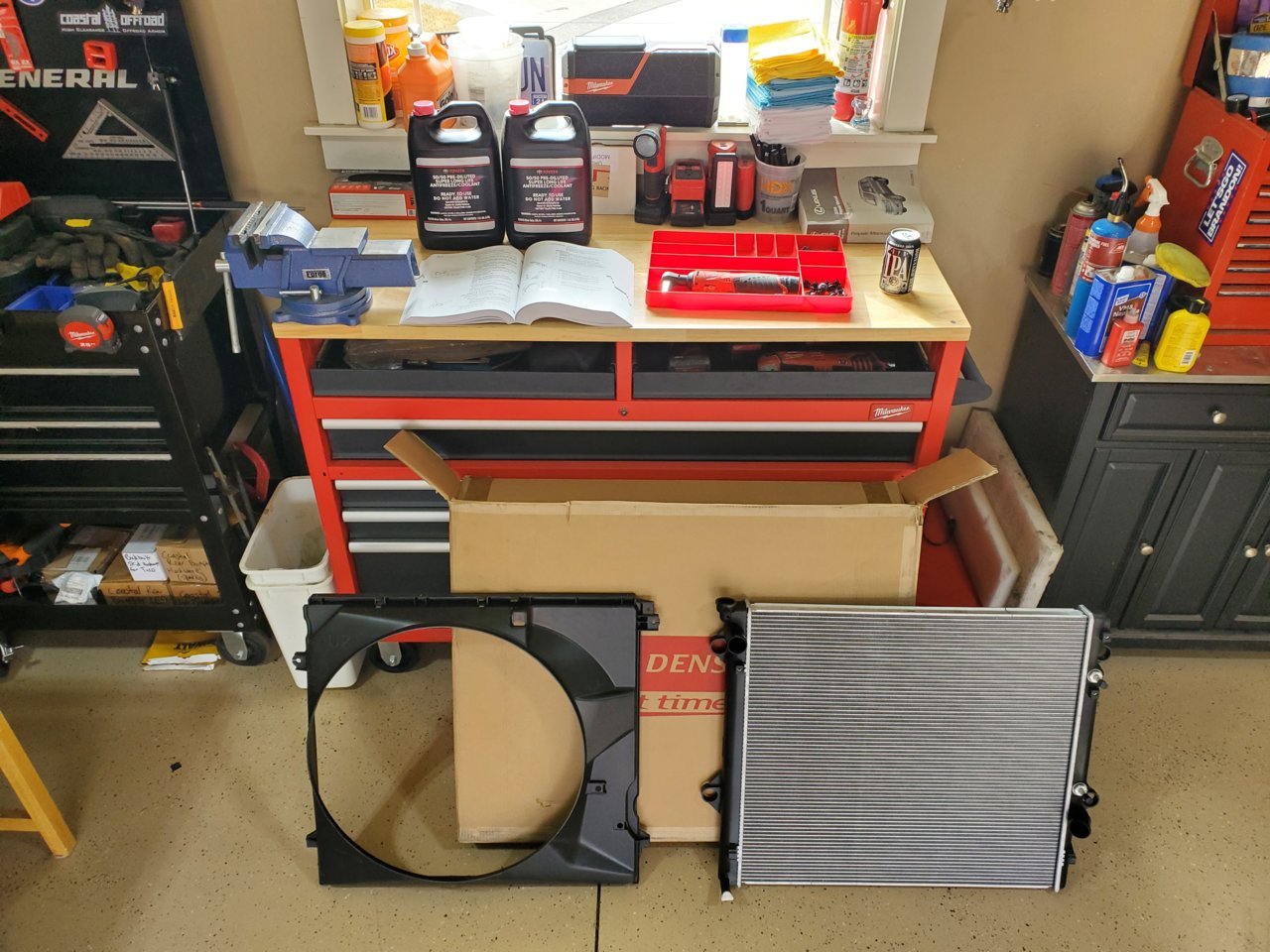

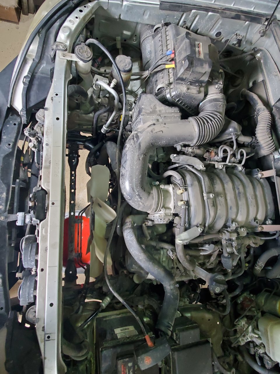

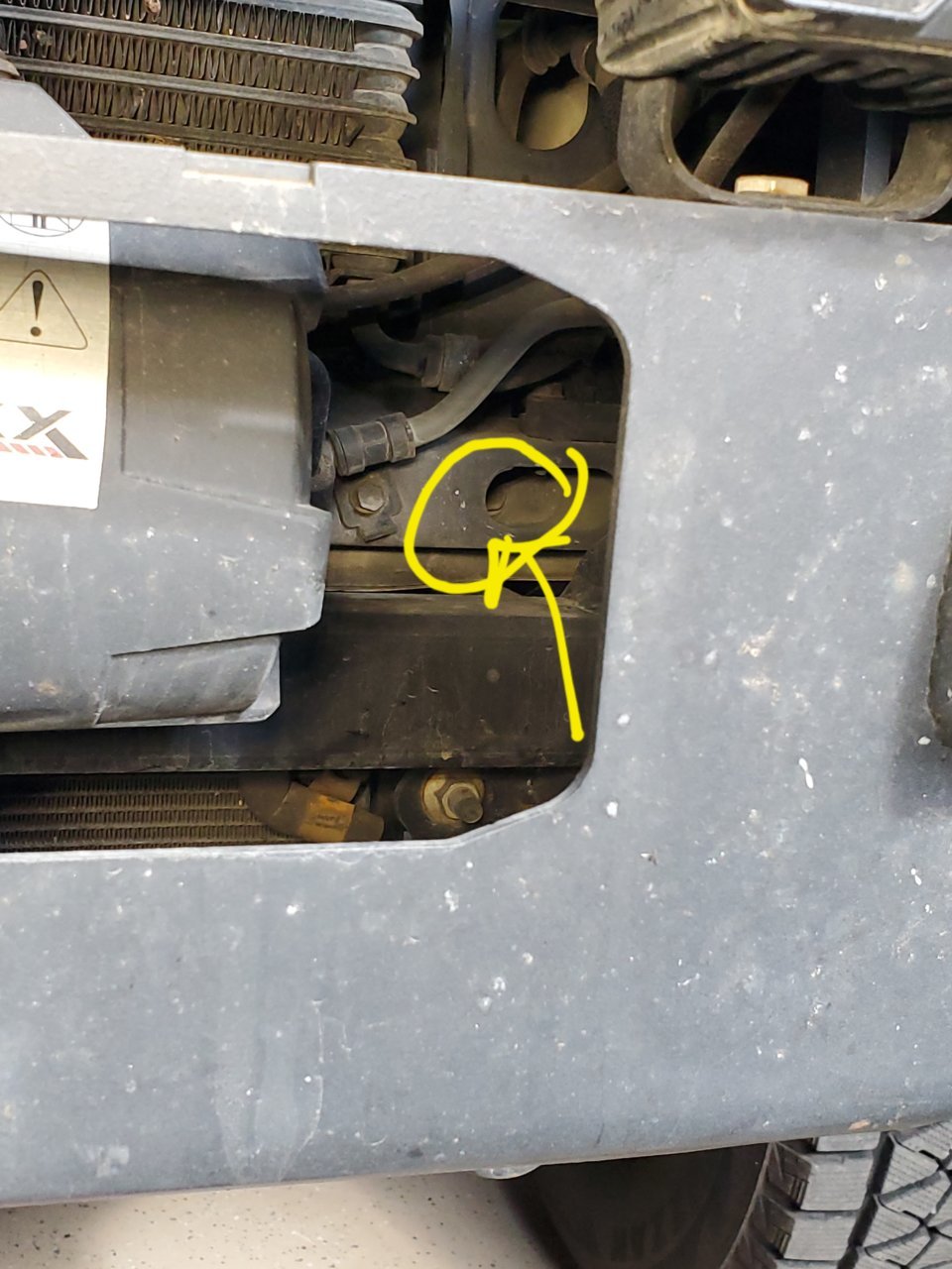

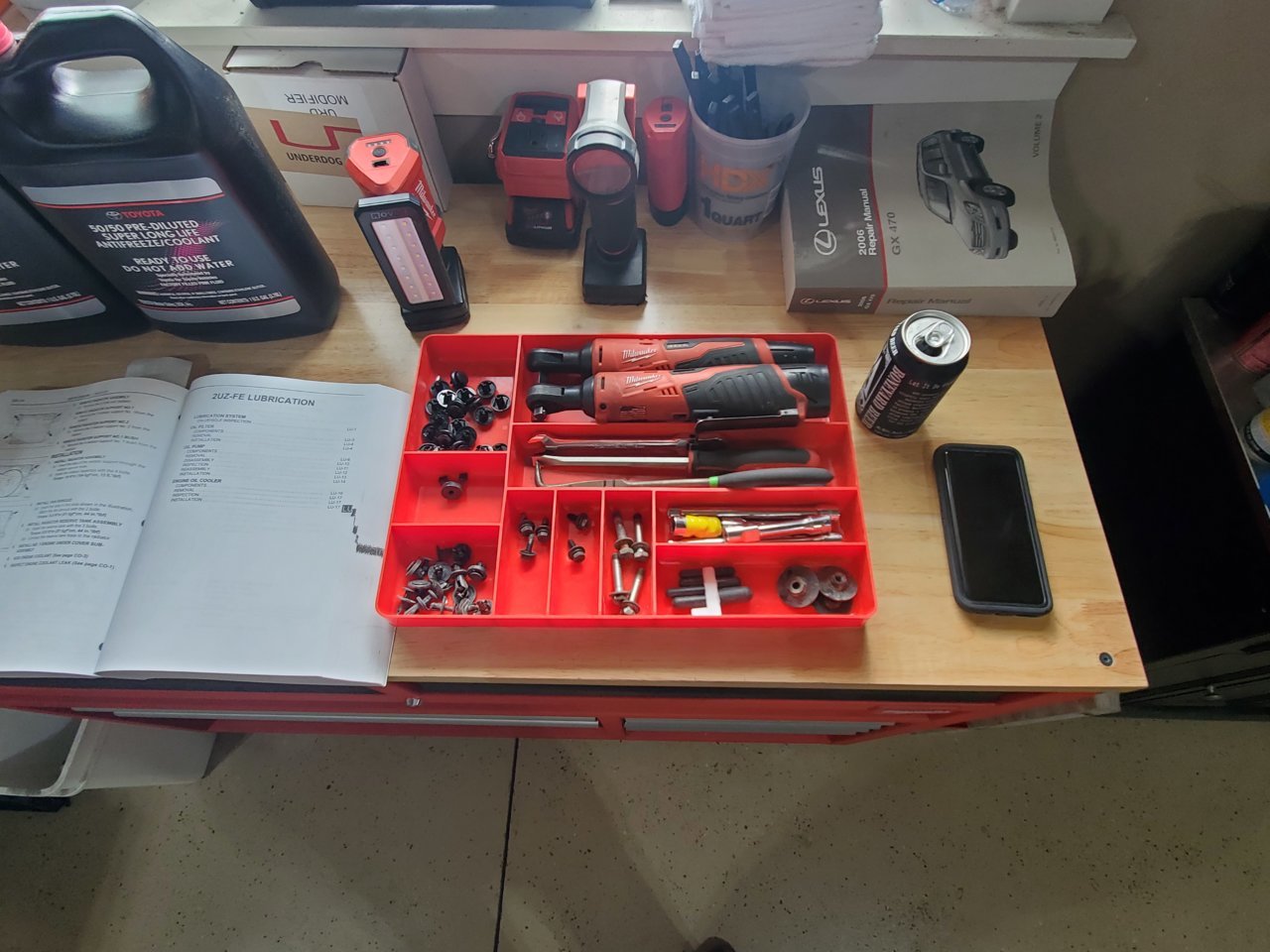

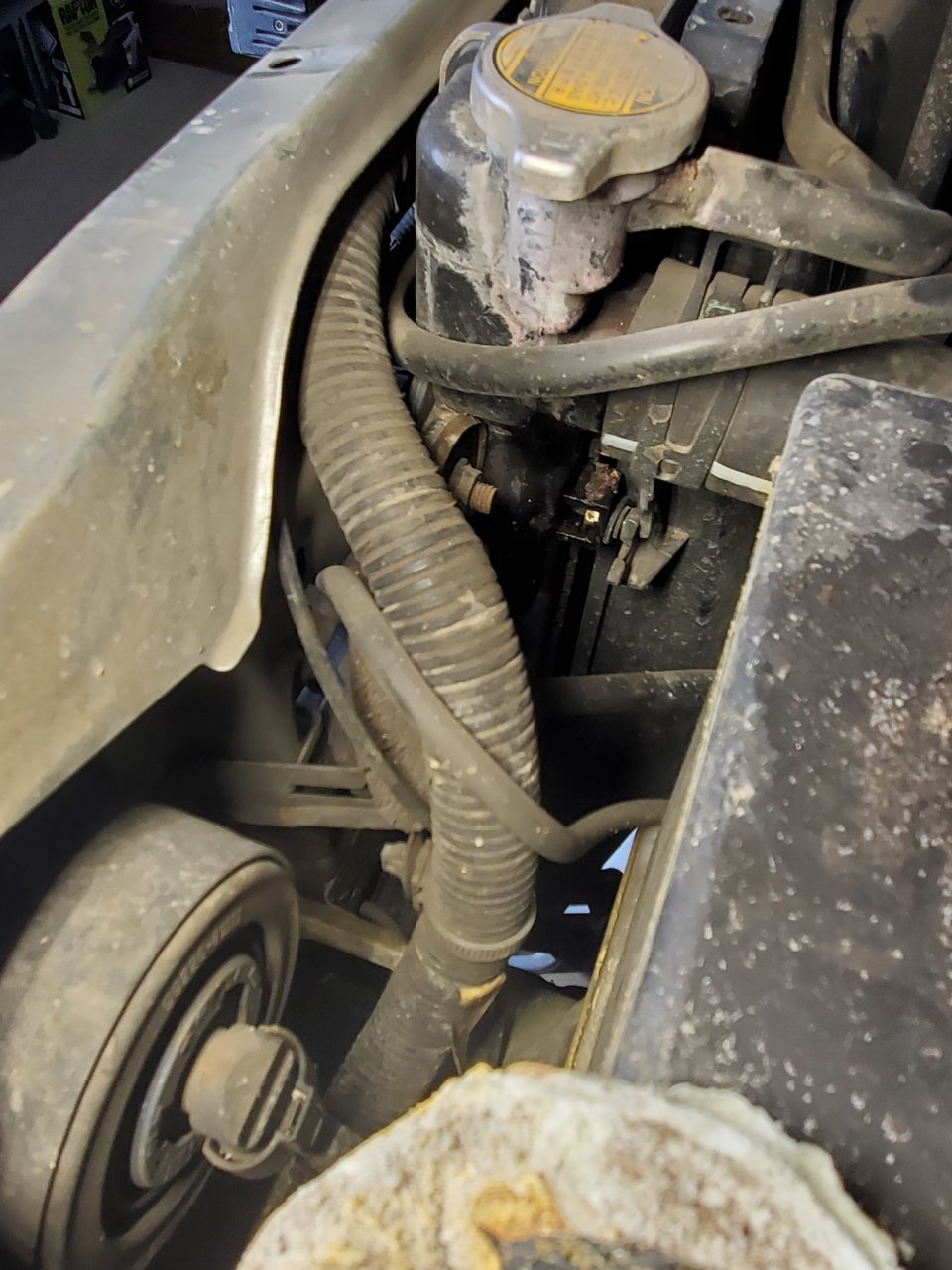

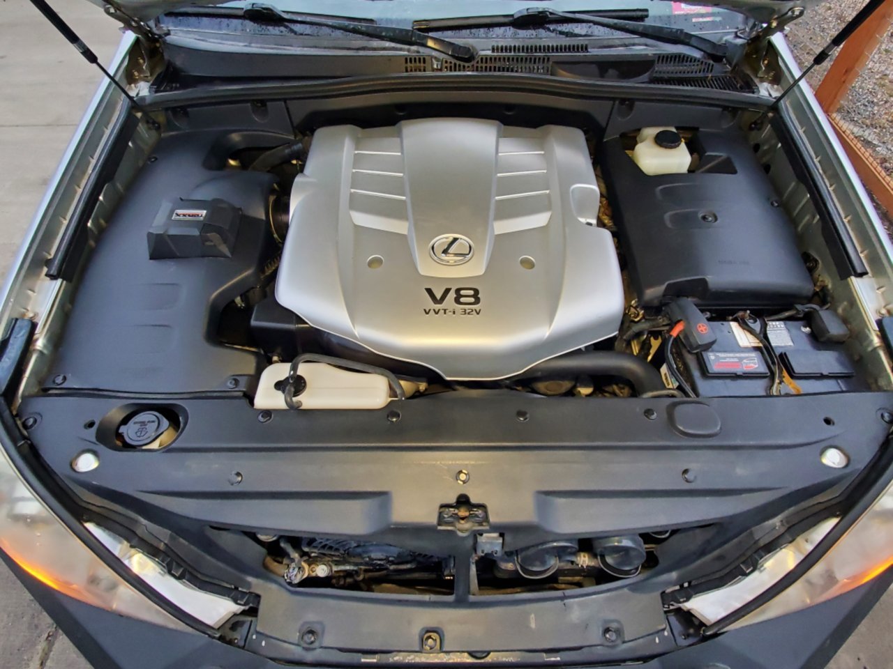

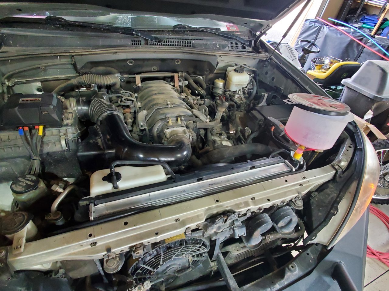

    Had a slight leak somewhere with the radiator. Not sure if it was due to a faulty radiator or just a bad hose/radiator connection. Decided to just replace the whole thing instead of messing around with troubleshooting. Upon disassembly, I noticed that the shroud was broken too. Might as well replace that too.
    Leak...
    Parts inspected, tools/coolant/manual/beer gathered...
    As with most things Lexus, some parts were way harder than they need to be. My bumper made the lower radiator bolts an absolute bitch to reach. Ended up using the 3' socket extension and a couple wobbly's mixed in to get it...
    Radiator/shroud removed...
    Replaced/burping...
    This new organizer tray came in pretty handy...

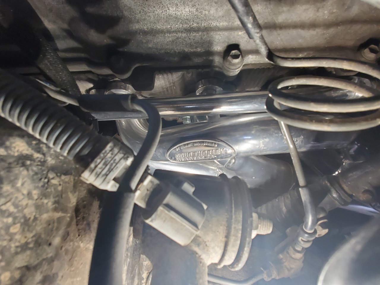

    Also, not today, but recently had my leaking exhaust manifolds replaced with Doug Thorley headers. Still need to put in my O2 simulator to cancel the CEL's, but that's for another day...

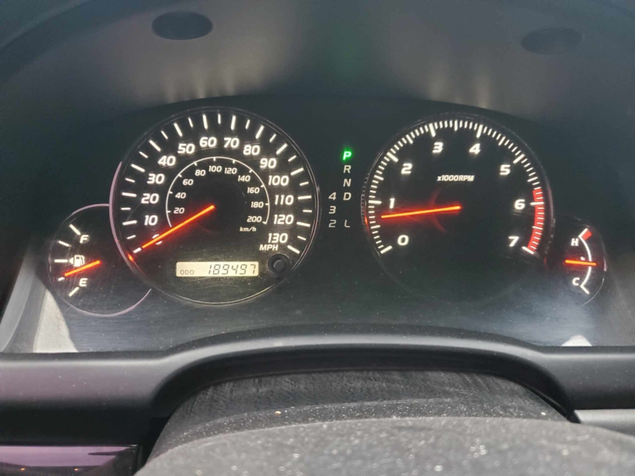

    Installed the O2 simulator that came with the headers/y-pipe from URD. Install was straightforward, tap into 3 wires, splice 2 others. Used an OBD2 reader to see that the banks seem to be balanced.
    While I was there, I followed a write-up on IH8MUD to disable the TPMS light in the dash. Was also easy, just cut the blue wire on the harness to the TPMS module and ground out the harness side.
    Boom. First time in months without CEL (due to cat delete and header install) and first time since I've owned the rig that the TPMS light is off. Feels so damn good to have a cluster that doesn't look like a Christmas tree.

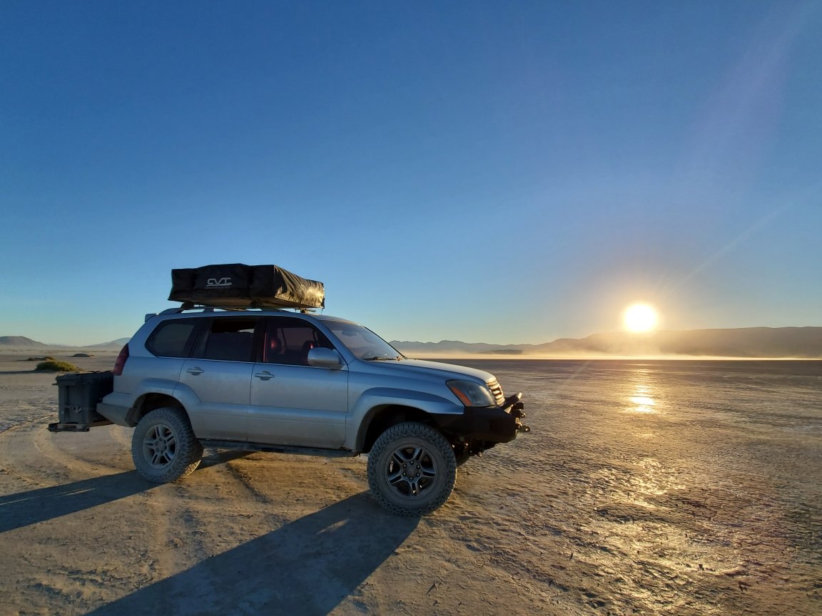

    Took a short trip to the mountains to cool down a bit from the 105+ degree temps lately. Felt good to stretch the legs a bit, even though it was pretty tame. Pictures don't do the scenery justice...
