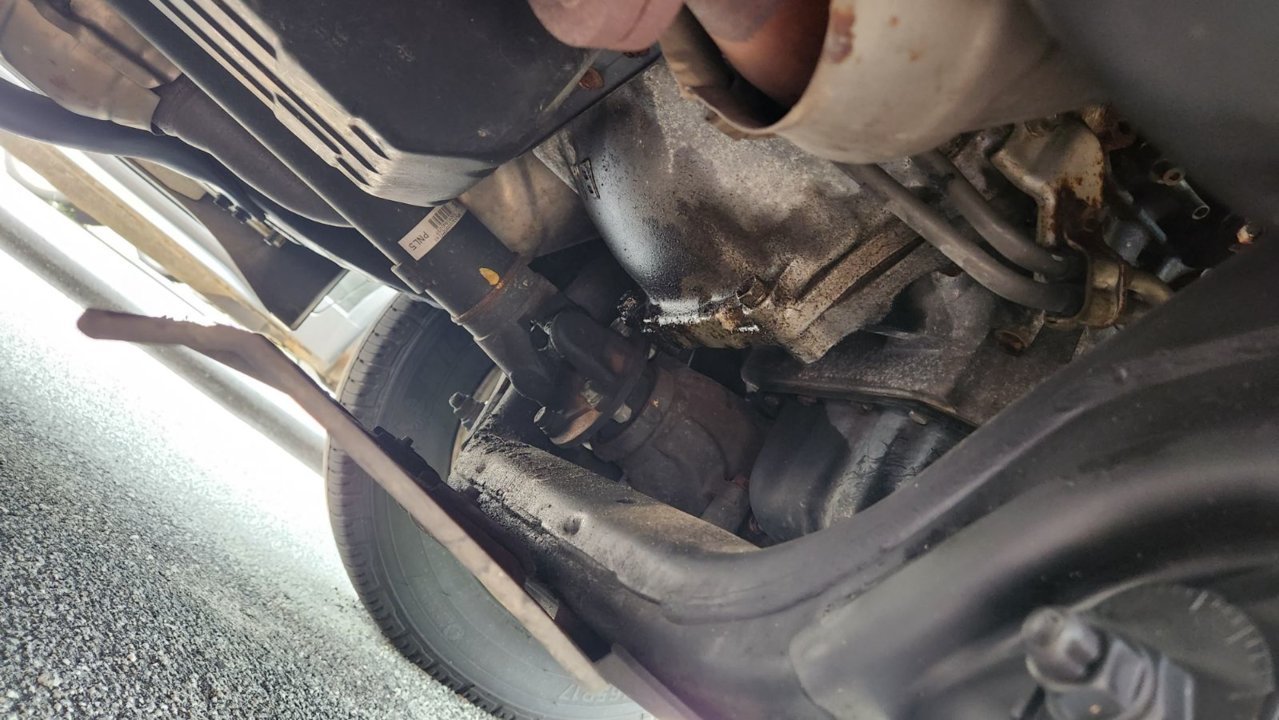

    My Brother in Law in looking at getting a GX. currently looking at an 04 and 06. Should he be concerned with these leaks? Is there any advice I should give him? Years to avoid etc?

    That’s a rear main and tcase actuator seals gone bad. Tcase is easy. Rear main not so easy.

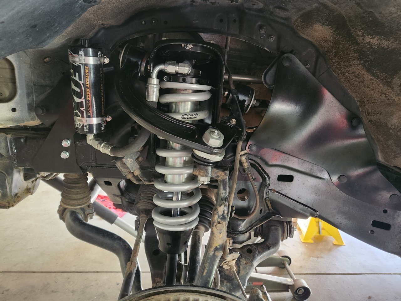

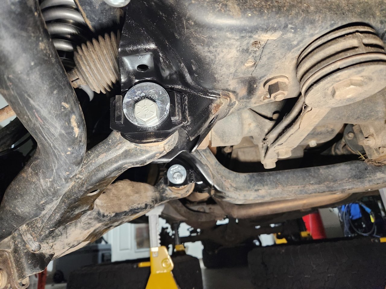

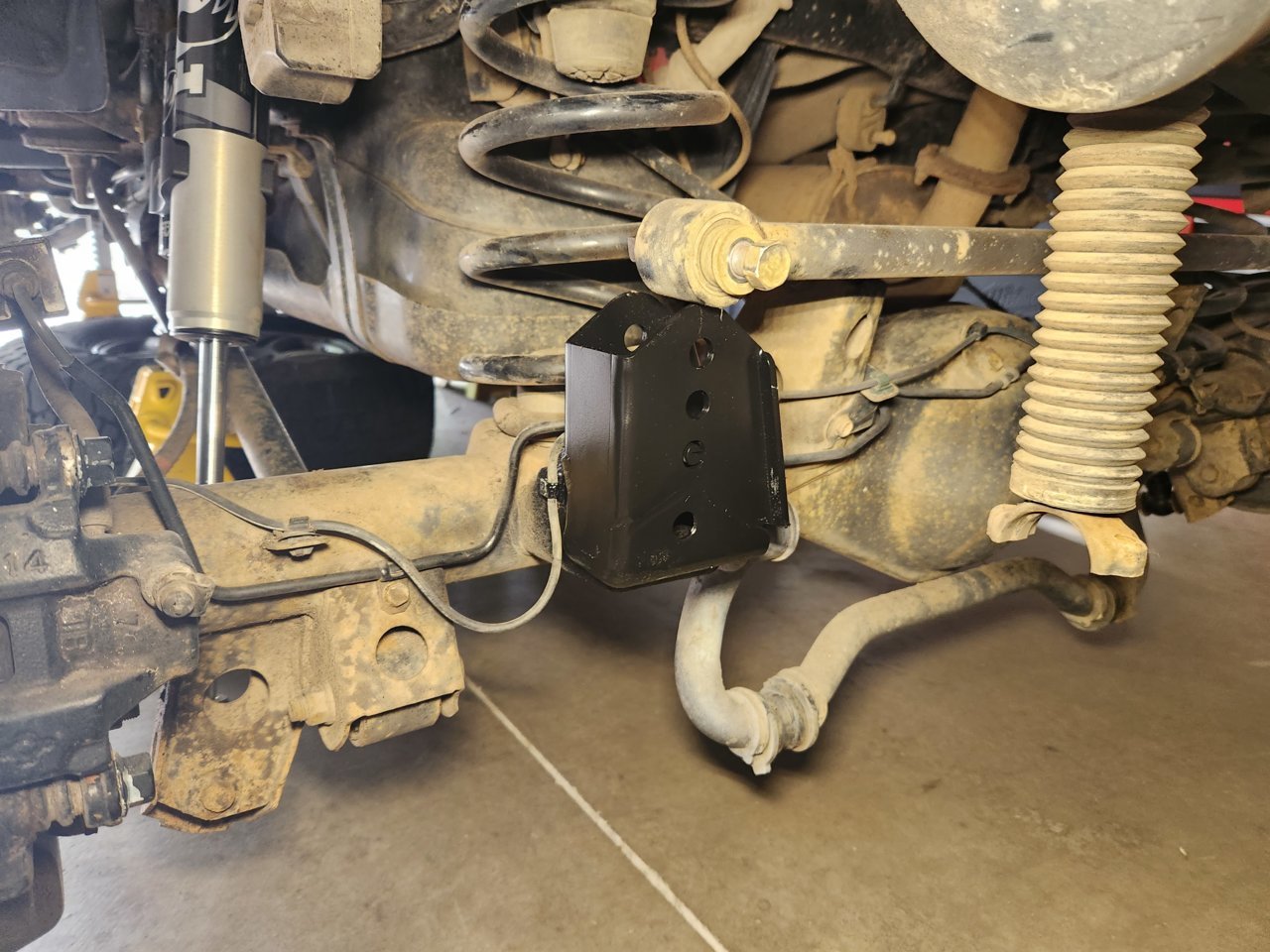

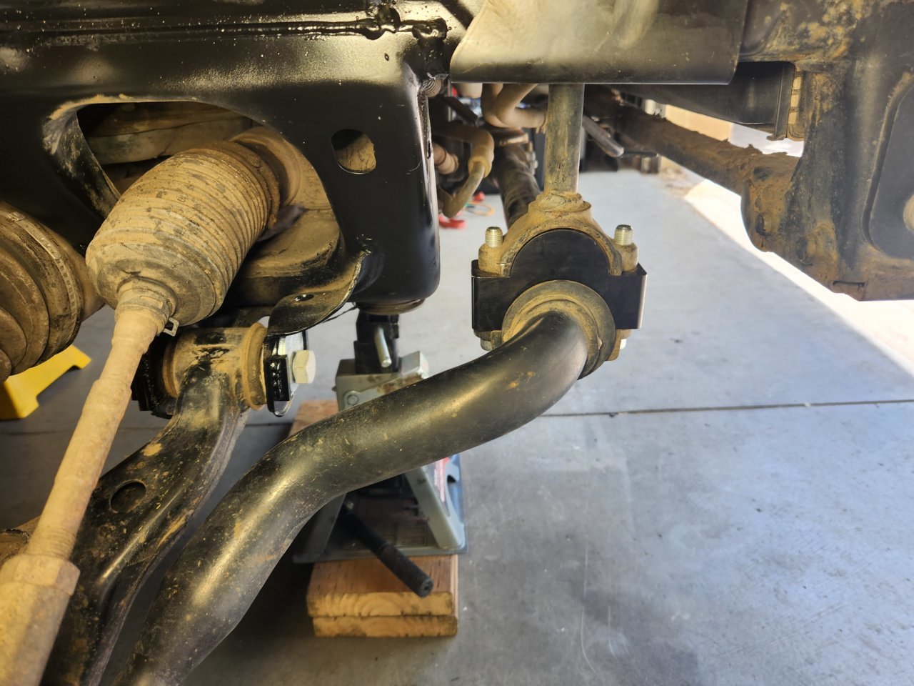

    Finished a bunch more on the GX over the last week. Completed the cam tab mounts, panhard bar correction kit, CMC and pinch weld mod. Got the frame cleaned and painted in a bunch of spots. Coilovers are in, resi's mounted. UCA's / LCA's, spindles and swaybars are installed. Waiting on some new splash guards and various clips. Just have to give it a rough alignment and get it to the shop.
    Cam Tab Mounts, new hardware...
    New Coilovers/UCA's installed, resi's mounted...
    CMC...
    Panhard Bar Correction Kit installed...
    KDSS spacer (no pics of rear yet)...
    w.adventures and jlemmond like this.

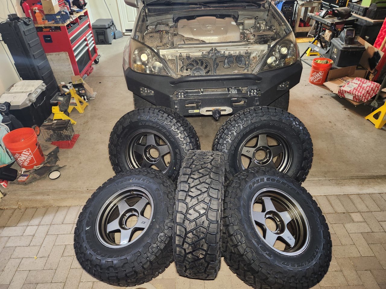

    Got everything buttoned up. Suspension in, everything torqued and back on rubber. Got new rubber and shoes mounted today. Alignment scheduled for Friday. Replaced the front output shaft seals and did a drain/fill on the transfer case as well. Just need to mount the wheels/tires and front driveshaft. Absolutely ready to test out the new upgrades this weekend.

    Got everything installed and got an alignment. Tested it on the trails this weekend and it performed well. Still need to trim some wheel well liner as it rubs a bit when flexed, but overall pretty happy.

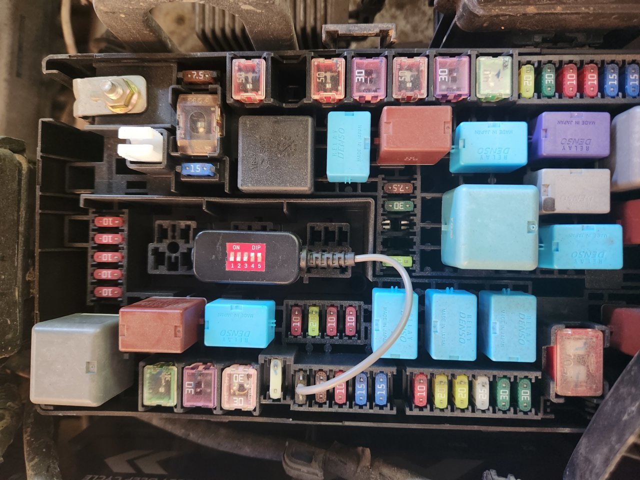

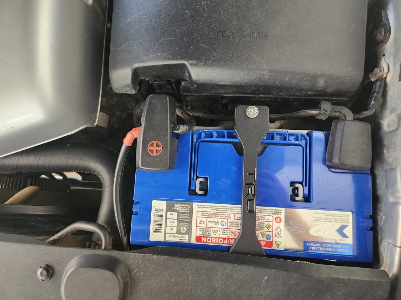

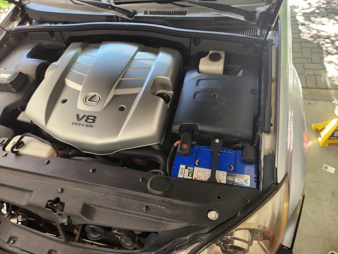

    Finally starting to get wrapped up. Splash guards installed to finish out the wheel wells, new X2 AGM battery, new battery hold down thanks to @Coupe and an adjustable voltage booster based on recommendation from @crashnburn80 in one of his threads. Keeping any eye on voltages over the next little bit to make sure I'm in the optimal range.
    Splash guards:
    Battery/hold down:
    Voltage booster:

    Cold starts in the cold will see the highest voltage spike right after startups. Be sure to retest in the winter or preemptively adjust down to 0.4v. :thumbsup:
    Also, nice meter.

    Thanks for the heads up. I live in Reno and it's not going to be dropping below 60⁰ for a while. Will definitely take another peak in the fall.
    I'm an electrical testing tech and the meter has definitely seen some shit and been through the ringer. Retired this one years ago when I got a 289 and 430. This one now just does house duty.
