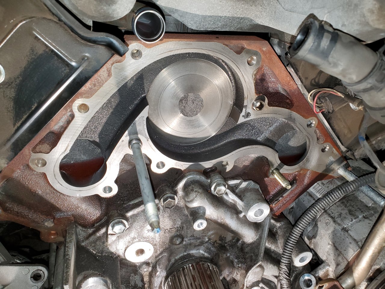

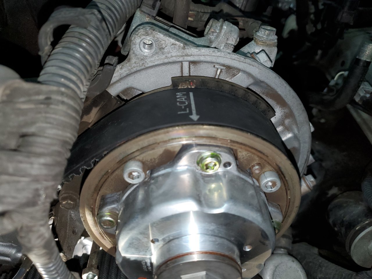

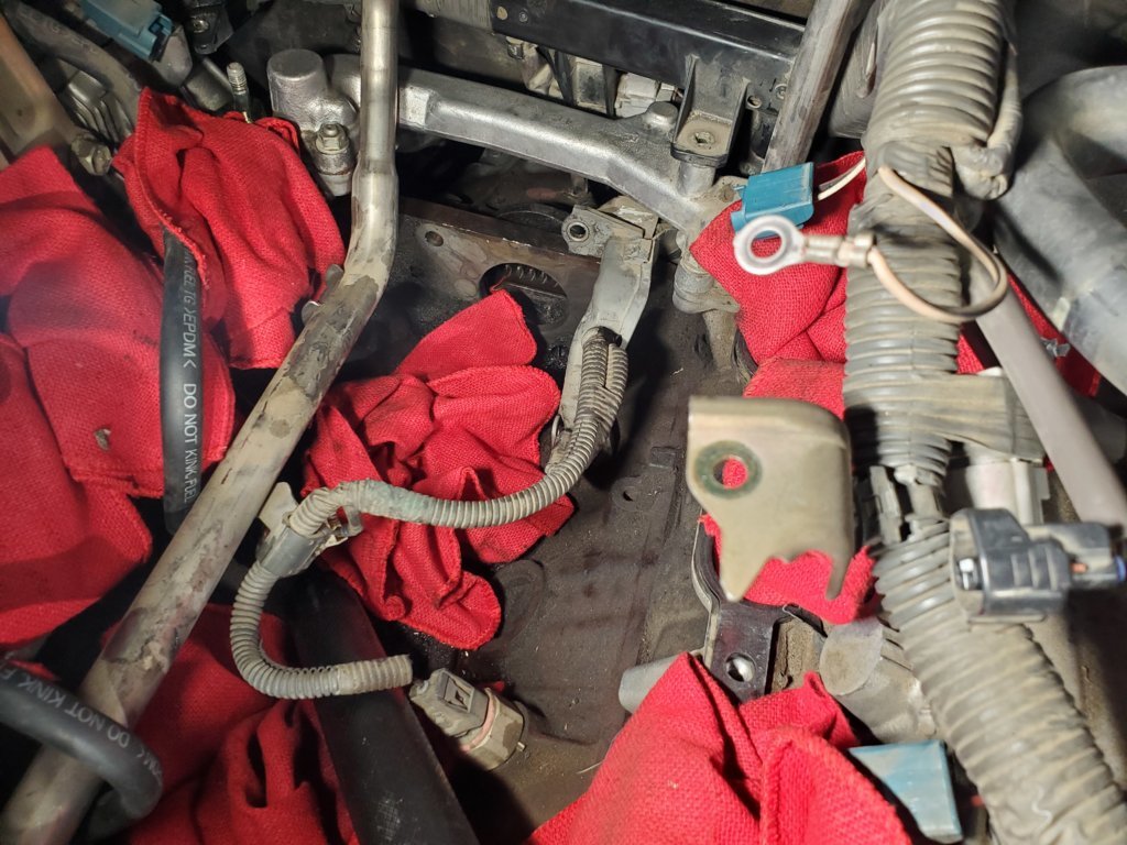

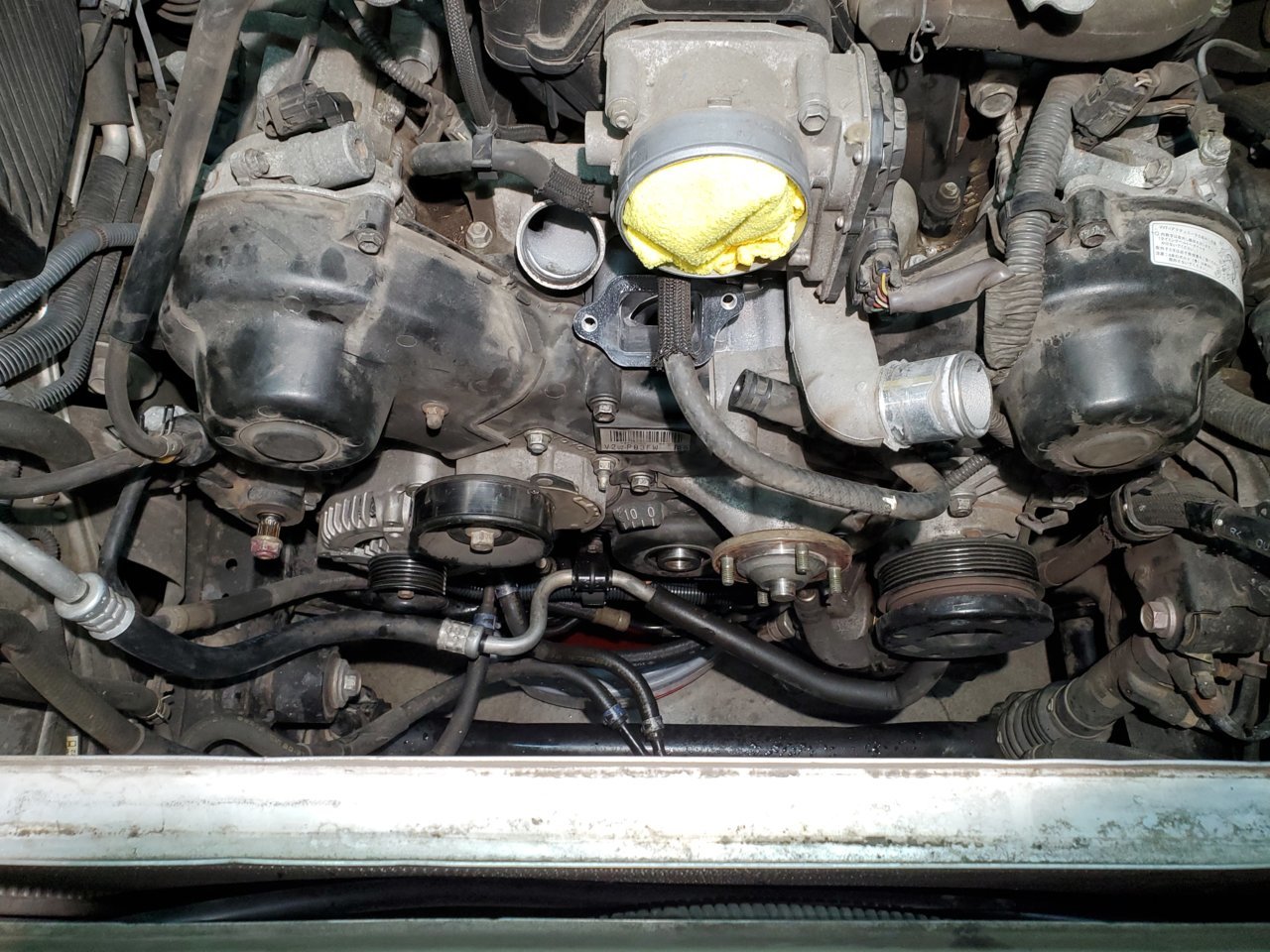

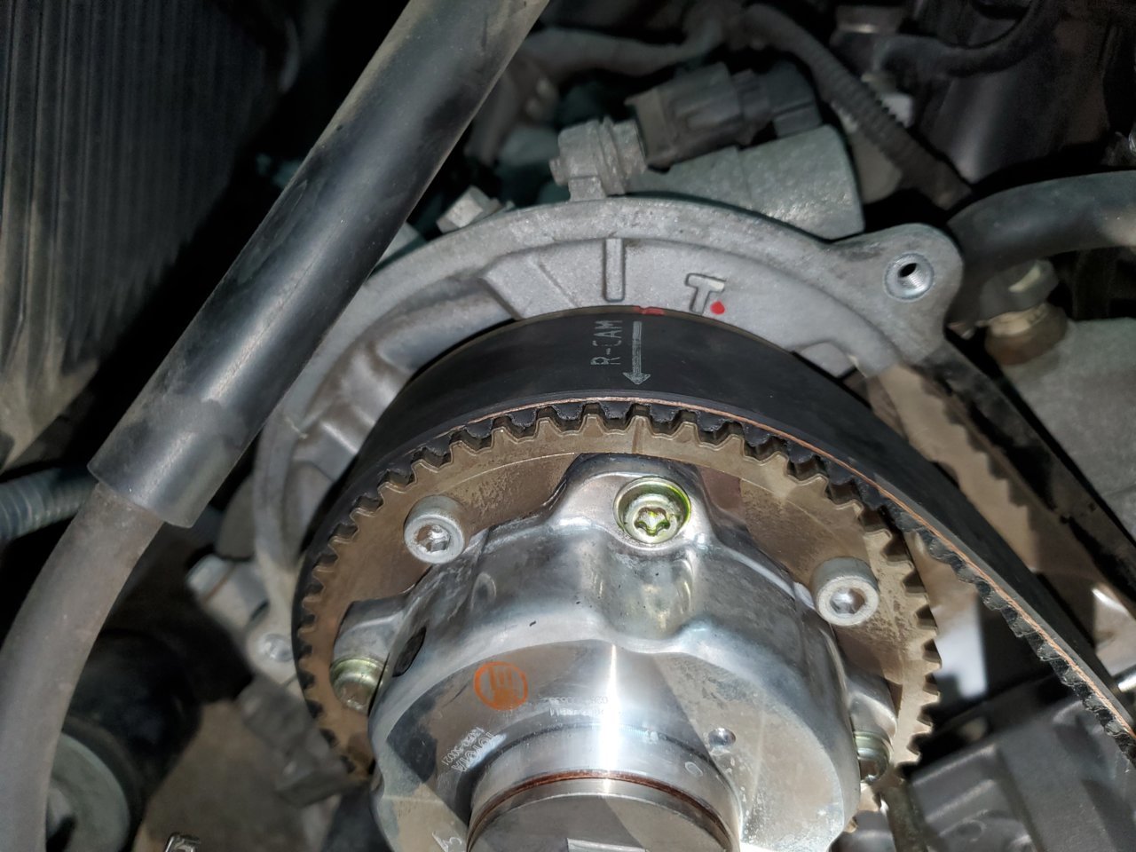

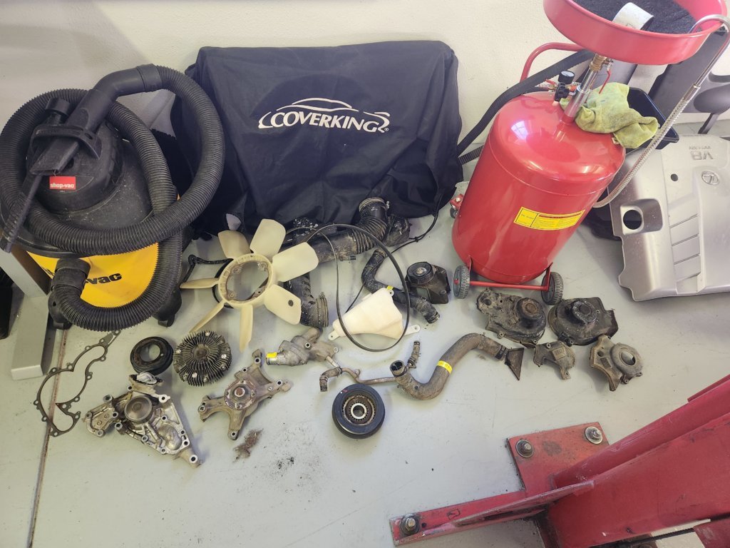

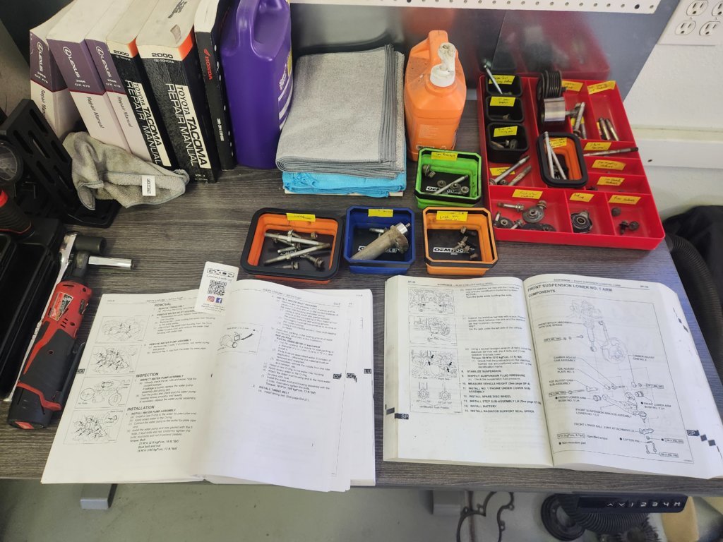

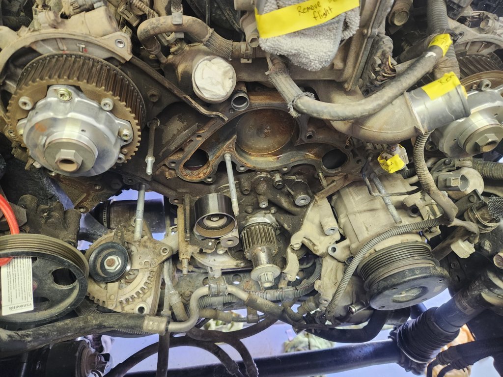

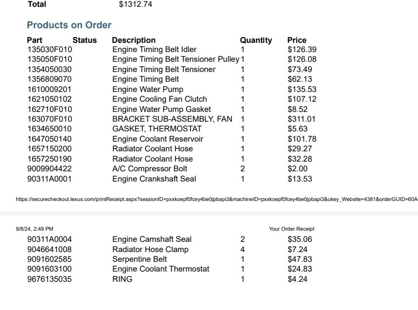

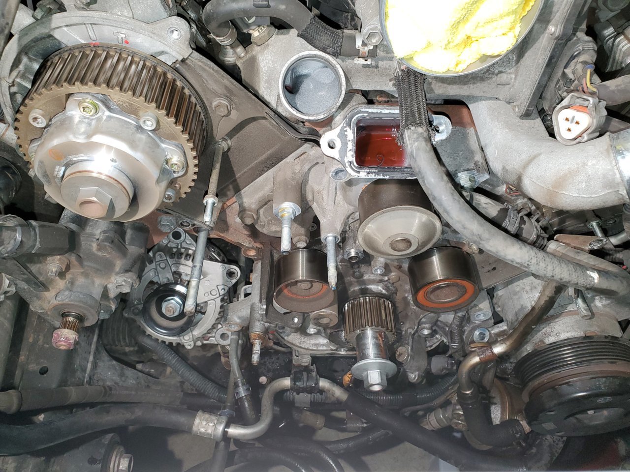

    Well, time to do water pump and timing belt again after 90k miles from the first time. Purchased all parts from Bell Lexus. Decided to do the fan bracket and clutch this time. Everything apart, hoping to have it back together by tonight. Anyone else OCD and need to label everything, haha.

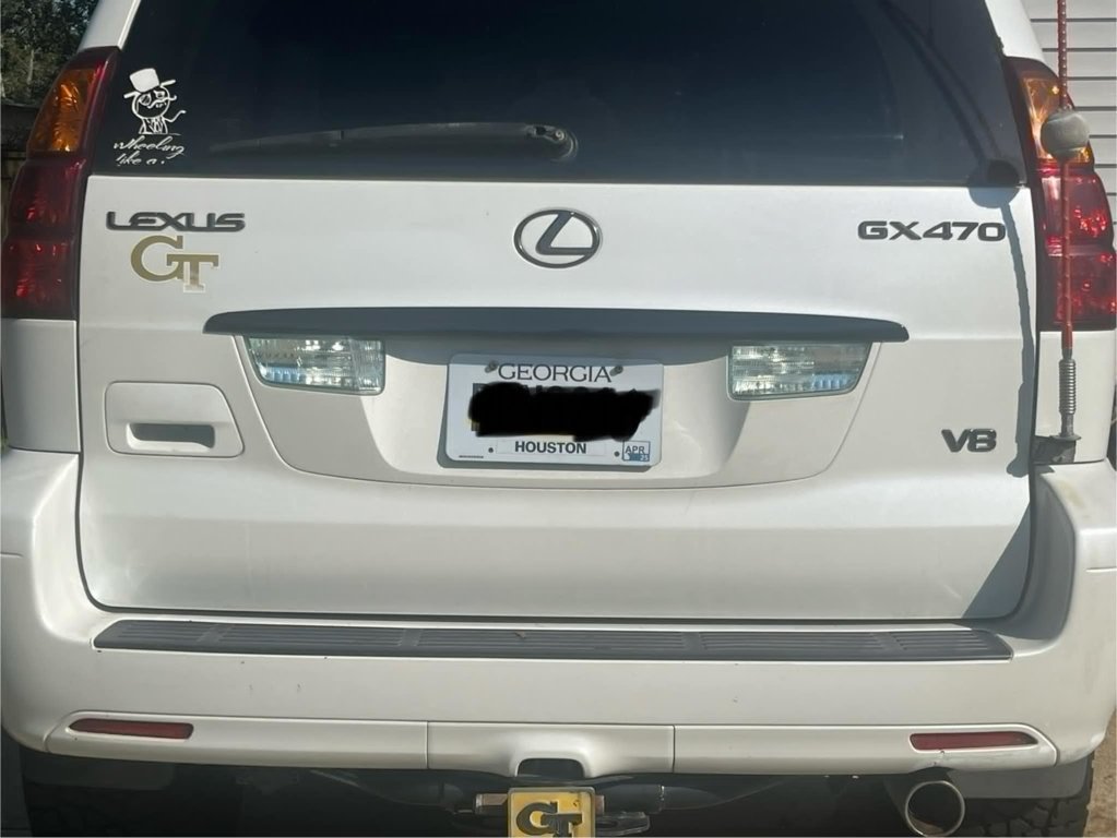

    got rid of the chrome above the license plate. used 3m gloss black vinyl. turned out ok. looks better in person than the pic.

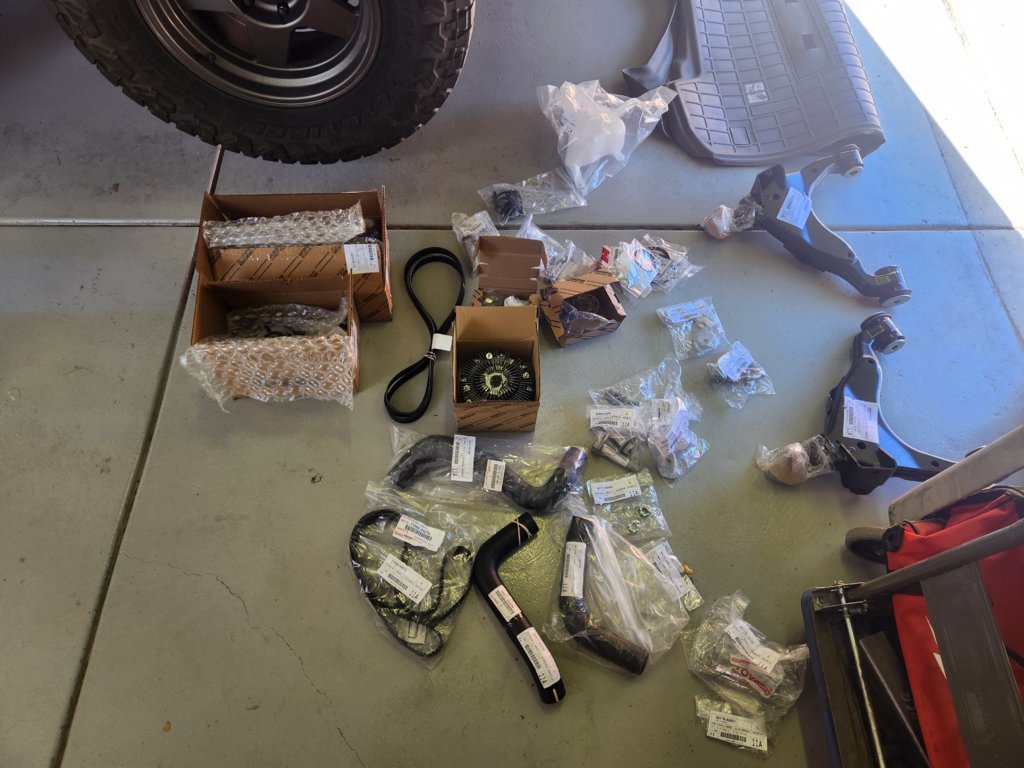

    Got a new seal driver from Cruiser Patch today. Fully set now to do rebuild the front end with OEM parts. New CV axles, LCA's and all new cam bolt hardware. Front end will be like new in no time...

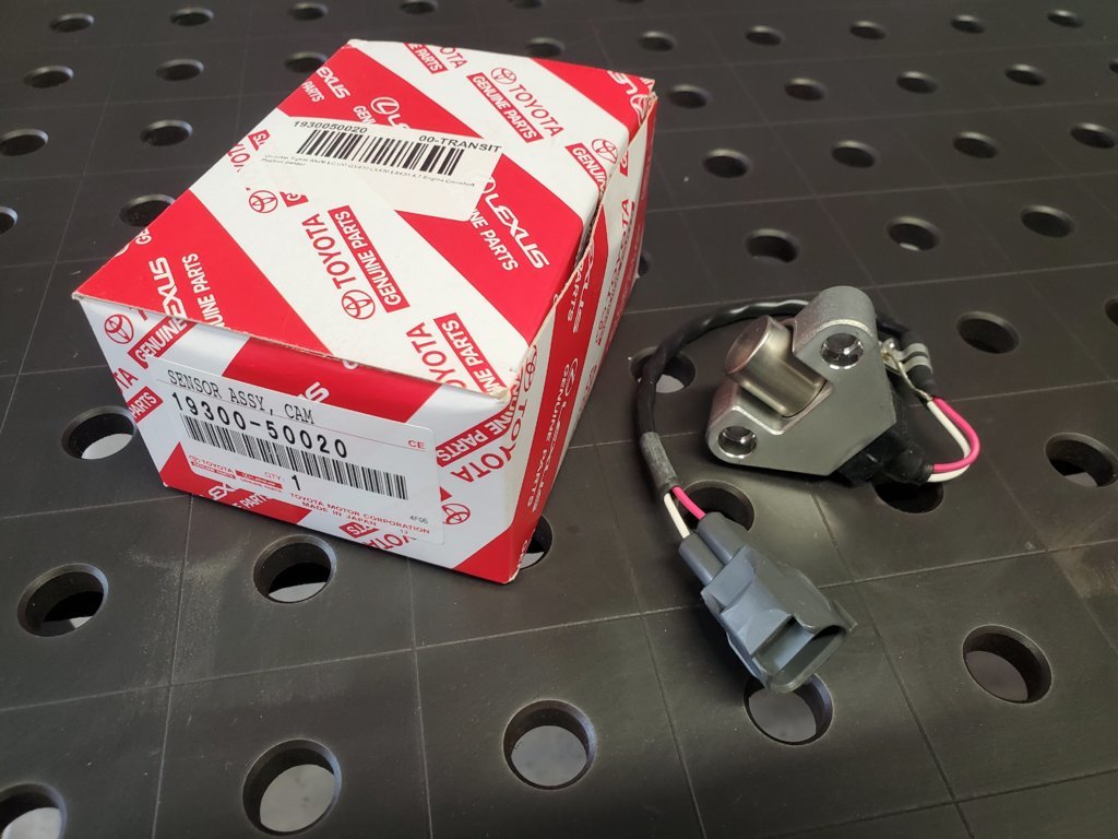

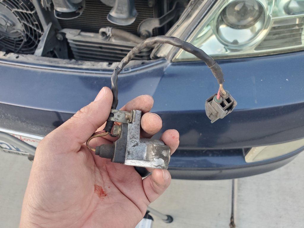

    Popped a P0340 just recently, and drew a bit of blood while I worked my way to replace it.
    Kind of a bitch to get to but at least there's not much to remove to get there.
    After yanking out the old one, I put her back together only to get a sort of weak cranking.
    Shouldn't have been the case since I had pulled the battery and left it on my charger.
    Then suddenly while cranking over it quit.
    Cause? Starter died.
    First time doing a starter on a 2UZ and I have to say, if you've got any physical disabilities, you're going to hate life (bad back).
    Got her replaced and buttoned up same day fortunately and that fixed it......until I pulled a P0330 code.
    This is for the knock sensor (passenger side). In a haste to put everything together, I'm pretty sure I must've hit the plug or something and probably broke it so I've got parts on the bench waiting to be installed.
    I've got a new knock sensor and knock sensor plug to install because I don't want to go back at it again.
