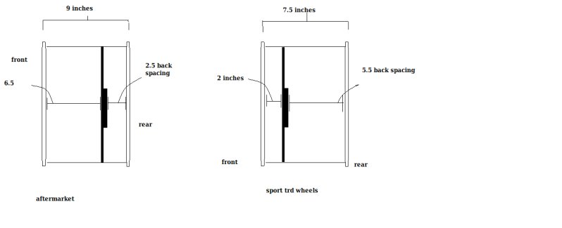

    !7" should have no problem clearing the calipers (I've only heard of problems with some AM 16"s). But the inside of the wheel will be farther out (3" if you have TRD wheels or 2 1/2" if you have steelies) than it is now. And the outside will be farther out (5" if you have TRD wheels or 4 1/2" if you have steelies) than it is now. It sounds like your problem will be rubbing the fender wells unless you have a 6" lift (and then it might still be a problem)

    drew this up real quick. right now on stock trd sport wheels with 1.25 spacers the wheels are almost an inch out of the well and looks perfect. where will these aftermarket wheels sit?

    awww common sense just hit me. They are gonna stick out too much. :(

    Yeah you wouldn't even be able to turn :laugh:
    Even 4.0 BS is too little for a 2nd gen. It makes you cut a lot more than 4.5.
