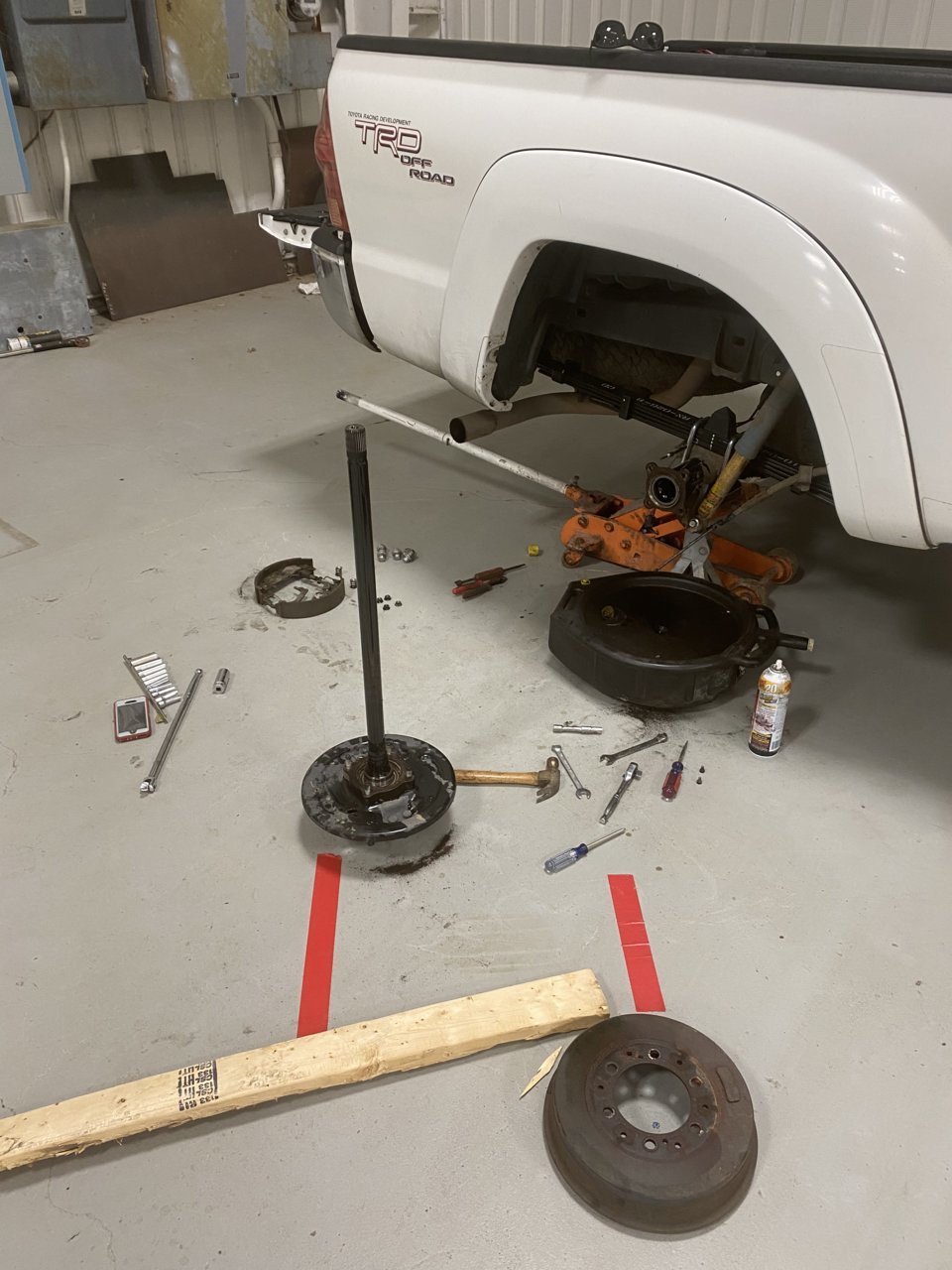

    I'm going through something very similar. Many people think its tires, but if you imagine some sort of cross between tire noise, burring, and a hum, then it could be a bearing. If they are truly "shot," then you can jack up the truck, grab the top and bottom of the tire and try to shake the tire. If it moves, probably a bad wheel bearing. Grabbing the sides of the tire also works, but you could feel some give even with good bearings if you have bad tie-rods or otherwise in the steering. I just did the rear end on my '08 TRD OR, and now its time for the front end.
