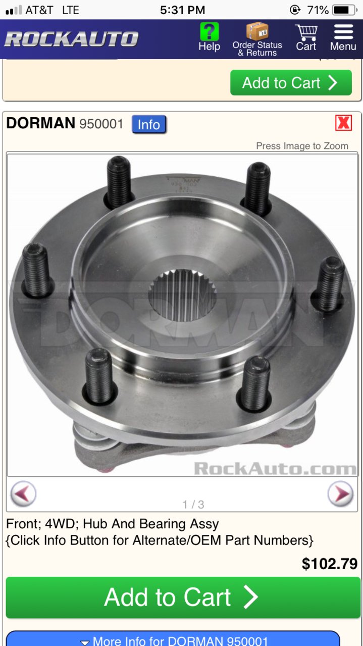

    Question. Did any of you have a damaged hub from the bad wheel bearing? Or is part of the replacement the "hub".
    A local TW trusted shop quoted me just under $500 to replace my front right wheel bearing... But he said the hub might be bad, too, from the rubbing and wear of the bad bearing. Said thatllt add another $200 to my bill for a new hub.
    Is this bullshit?

    The hub might be bad depending on how long you drove on it but it shouldn't cost $200 for the part. and it's less work if you don't have to cut the races off the old hub

    Well, he quoted like $490 for the job.... Then said IF it's bad, the hub part costs $200, but they only charge for the part... You're saying the labor time/cost would go down if they also did the hub?
    I drove on it for about a week @mynewtoy .. well, I could hear it for a week

    you won't know if it's bad until you pull it apart. if the bearing seized it could allow the race to turn on the hub wearing a groove in it
    xguntherc[QUOTED] likes this.

    Ah ok. Thanks for the info. The noise was pretty loud from about 35 mph and faster, that's the only time I could hear it though.
    Hope I don't have to replace the hub too. That's expensive. I coulda/shoulda done it myself.

    I just looked it up on rockauto and you can get the hub for like $20
    TOYOTA 2009 TACOMA 4.0L V6 Brake & Wheel Hub Wheel Hub
    Price
    WJB SPK107 {#4350204120, SPK403} Info
    Front; 4WD
    $20.79
    DURAGO 29595076 Info
    Front; 4WD
    $20.89
    DORMAN 930107 {#4350204120} Info
    Front; 4WD [Wholesaler Closeout -- 30 Day Warranty] (Only 1 Remaining)
    $61.79
    SKP SK950004 Info
    [​IMG] [​IMG] Front; Pre Runner; SR5 Prerunner; TRD Sport Prerunner; Hub And Bearing Assy
    $67.79
    SKP SK950001 Info
    Front; 4WD; Hub And Bearing Assy
    $78.79

    So if they try to say $200.... While my front wheel assembly is all torn apart. What do I tell him?
    Say I'll buy my own and bring it down in the morning. Lol

    I don't know what to tell you there. I have never dealt with a shop I do all my own work. I would call BS on that part price before they touched my truck. Or just go to another shop
