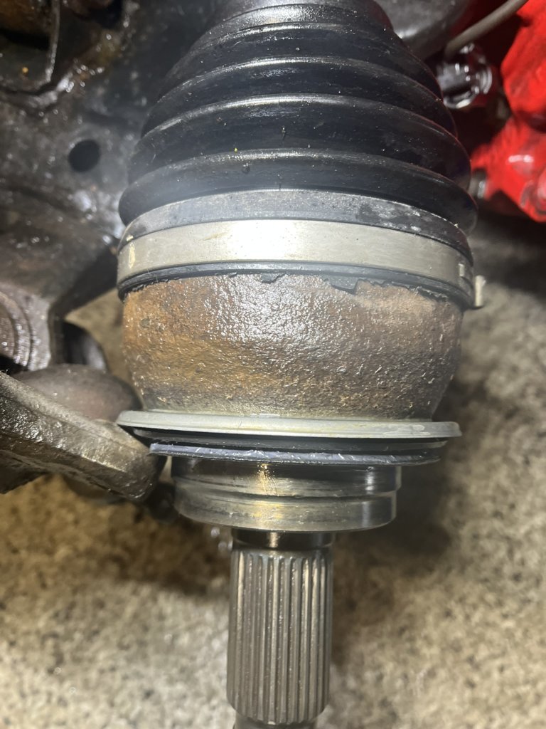

    I’ve used the stamped metal cover (that covers up axle/cv nut) and a hammer to seat that inner axle dust seal, it’s the right size for the job.IMG_0681.jpg

    +1 on using the old CV dust shield to install the new oil seal and vice versa. Also, the CV dust shield can be tricky and what was getting me was a lot of rust on the flange wasn’t allow the CV dust shield to fully seat. Once that was taken care of, a punch and a ball pein hammer and the seal was fully seated.
