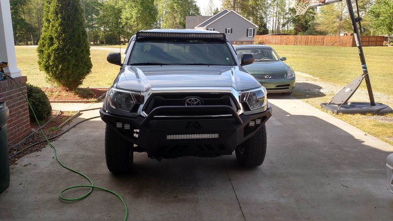

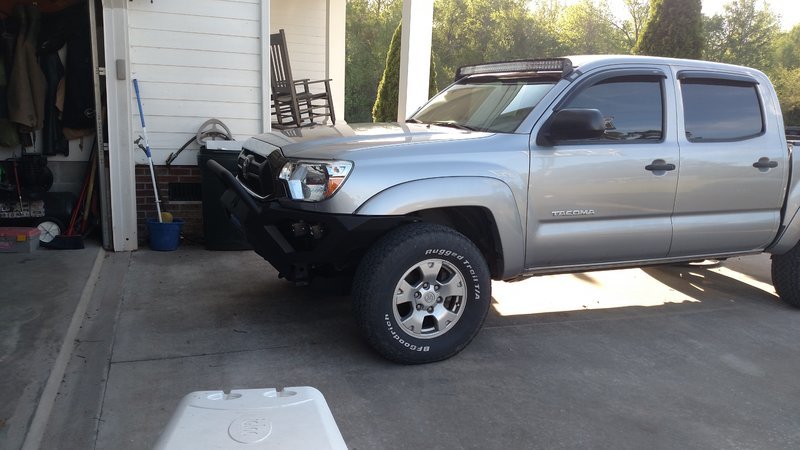

    Just ordered a 6inch Rough Country Suspension lift for my 2015 Tacoma, wanted to run 20x12 Hostile Wheels and 33x12.50R20 tires, debating between the Nitto Trail MT and Amp Mud Attack tires. Wondering if anyone has run 12 wide wheels and how long wheel bearing last and if any other components seem to wear over time due to the offset of the wheels.
