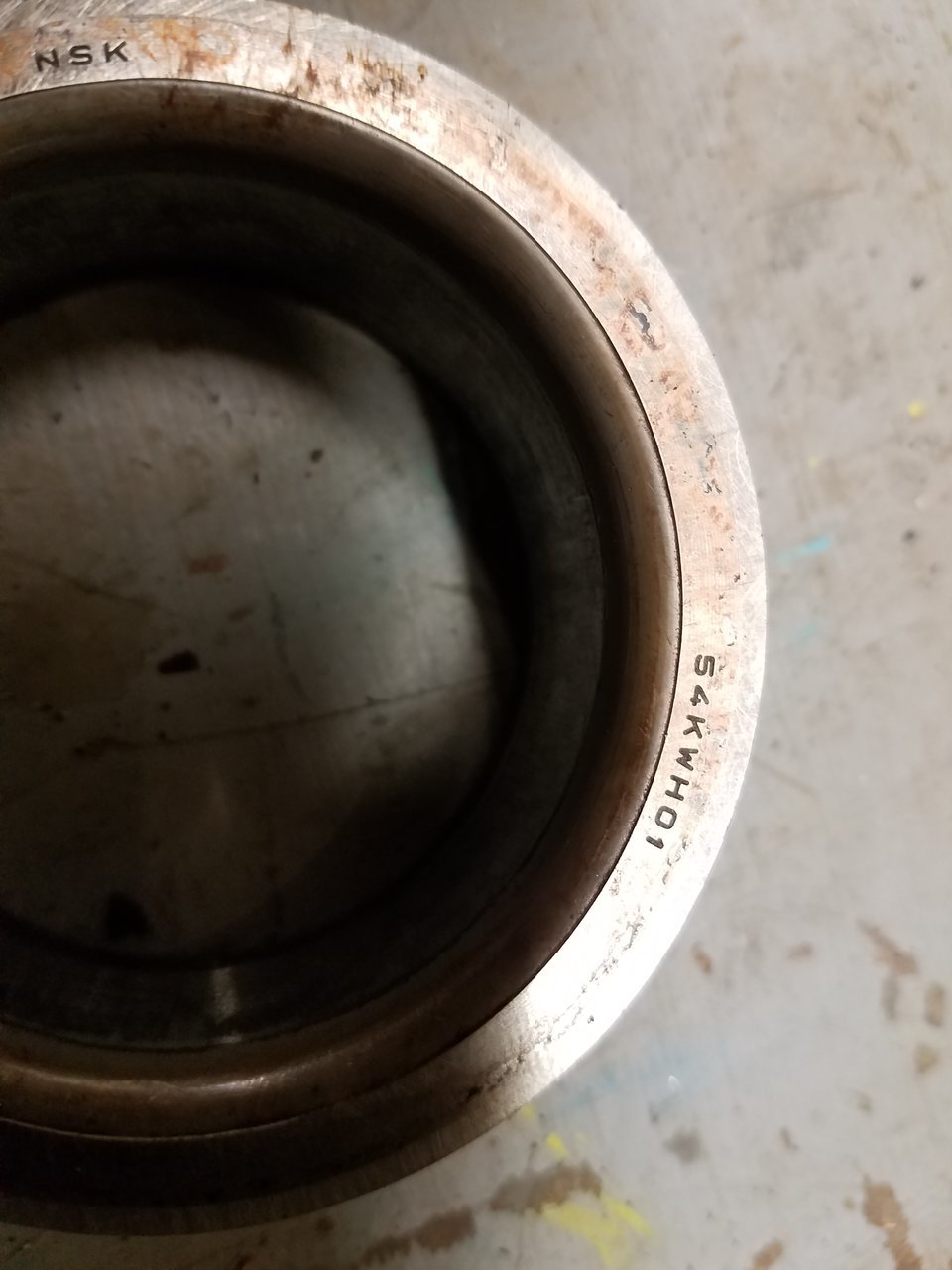

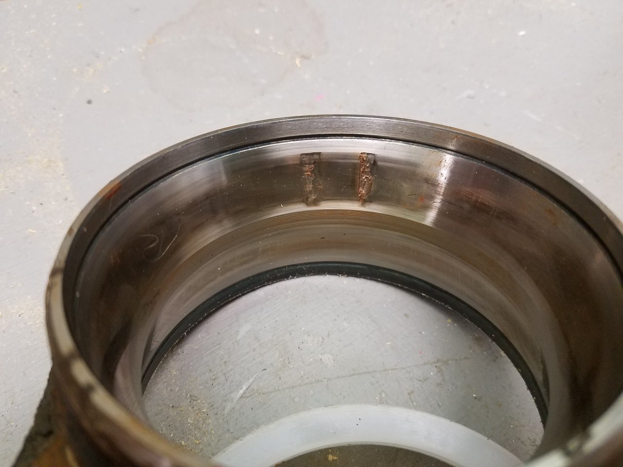

    Still no contact here either. Here is why my original failed. Pitting on race . Dorman assembly went on perfectly, no issues. I had my original hub and bearing apart with my press in about 10 minutes. I'm going to get a new bearing, seal, and bolts and build a spare for drivers side. Good bearings are $60 ish and that's about 1/2 What I paid for my Dorman asdembly. If you have a press, I wouldn't hesitate to do this. I just have a cheap 20 ton harbor freight one and it popped the bearing off with no effort. I can't imagine it would be any more difficult assembling a new one. Just be sure to press the bearing on the inner race to avoid damage. The factory bearing was an nsk 54kwho1.20180304_112334.jpg

    20180304_112213.jpghere is the bearing number
