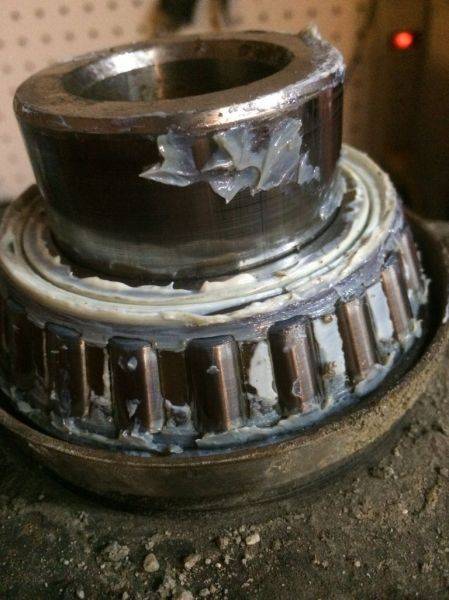

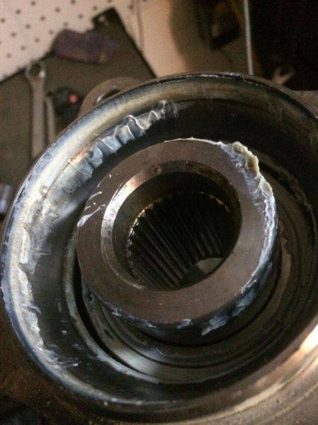

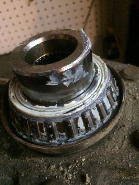

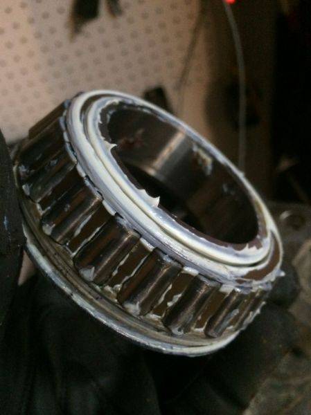

    So I replaced the bushings on my LCA's a few weeks ago and while I was there I replaced the LCA ball joints, outer tie rod ends & I came across the passenger side wheel bearing making some noise. I decided to replace both hubs.
    What I found interesting was the passenger side cv seal was damaged, which in turn allowed the outside elements into the bearing which lead to its demise.
    The driver side, which is original just like the passenger side, the seal was intact and the bearing was working great.
    I disassembled the passenger bearing assembly and it was pretty crusty in there. The grease was burnt, the bearing race was scoured badly it was a sad site.
    Now I disassembled the driver side. Here you can see the grease as I started to push the flange out of the bearing. The grease is still a nice clean white!
    looks new to me
    The cv seal was in perfect condition on the drivers side and as you can see the adequetly greased OEM 81,000 mile wheel bearing is in perfect condition.
    For those that believe the OEM bearings are inadequately greased from the manufacturer may want to think again. I honestly believe (and was told by a Timken Rep) that the white grease is adequate & under no circumstances should the bearing be altered with any other grease.
    As long as the seals are intact, the bearing will have a very long life.

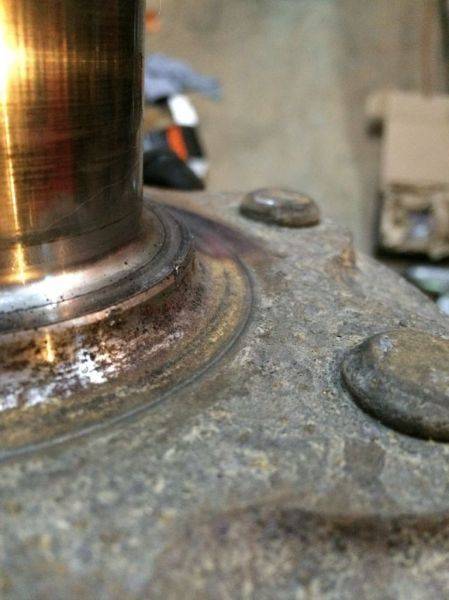

    I also took a few pics of the hub flange surface to show why you should not re-use this flange when replacing wheel bearings. As you can see the flange is scoured all the way around at the seal surface which allows the outside elements to get by the seal and into the bearing, prematurely wearing the bearing.
    This is the flange as it was pressed out of the passenger side bearing. The bearing surface is rusted and the seal surface is rusted and scoured.
    Here is the passenger side flange cleaned up to show the gouges in the sealing surface
    Definitely do not want to reuse this flange! :eek:
