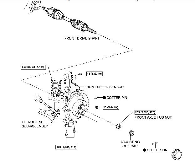

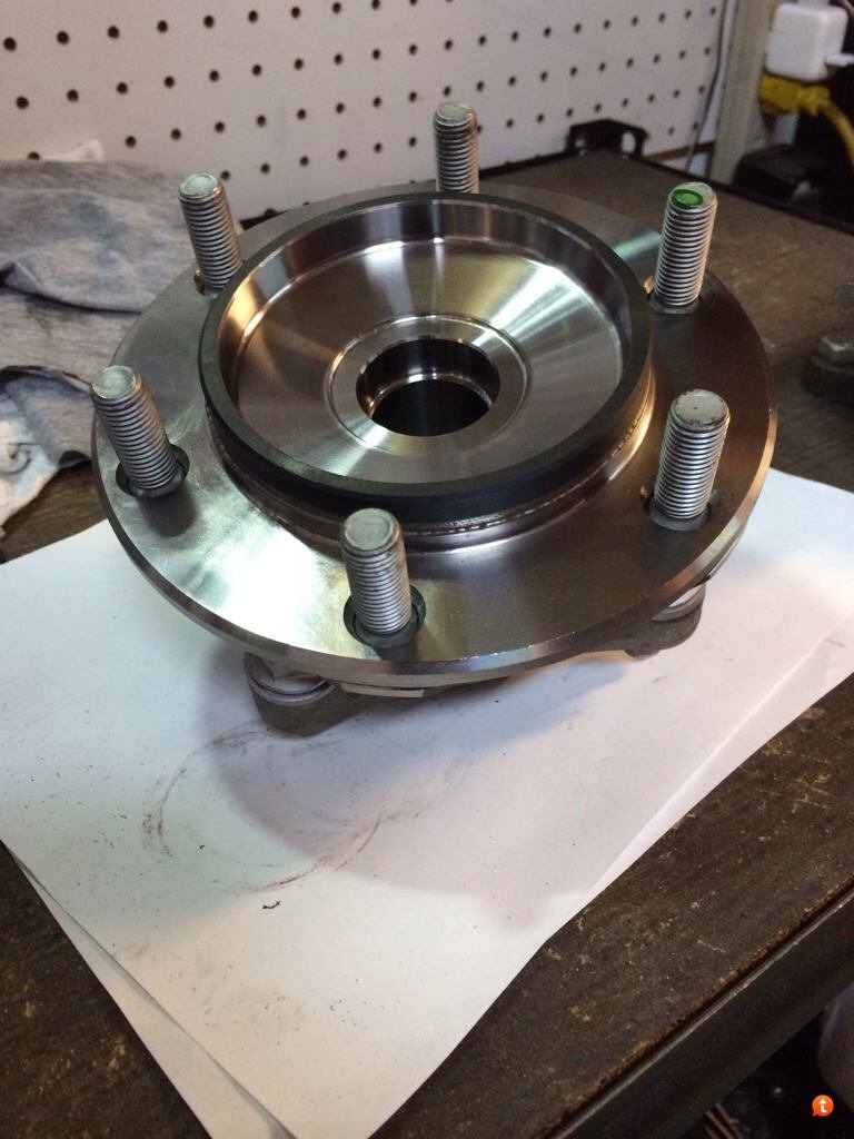

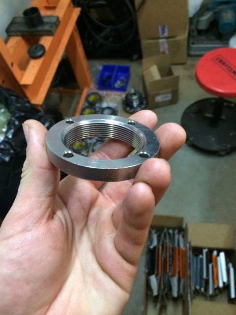

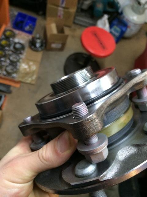

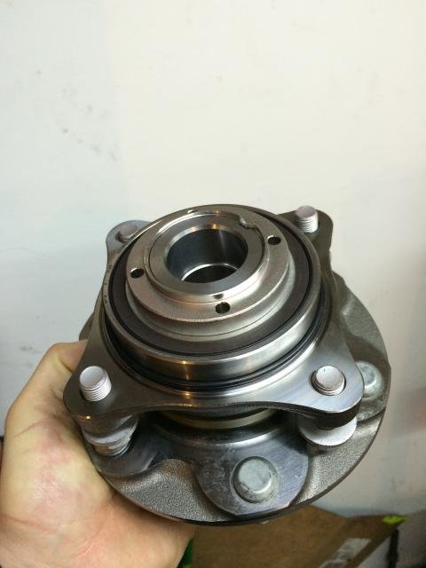

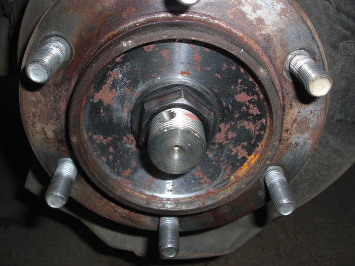

    This is probably a stupid question, but is there some reason you can't just bolt a 4wd hub onto a 2wd?.....

    Not a stupid question, it has been asked before.
    The 2wd PreRunner hub flange, unlike the 4x4, is threaded and is retained by a large nut that is torqued to a specific number. The torque setting is what keeps the proper amount of load on the bearing, and is needed for the longevity of the bearing. If that nut is improperly torqued, the bearings life will be decreased significantly.
    The 4wd hub flange is pressed into the bearing the same way as the PreRunner, but the cv shaft/axle nut is what retains the hub flange. The axle nut is torqued to a specific number.
    If you bolt a 4wd hub assembly onto a PreRunner, not only will the bearing fail quickly, but the hub flange would eventually work its way out of the bearing :eek:
    2wd PreRunner
    4wd hub flange
    not threaded, splines for cv axle shaft can be seen
    AXLE SHAFT/NUT
    Schematics
    2wd:
    4wd:
    HOPE THIS ANSWERED YOUR QUESTION
