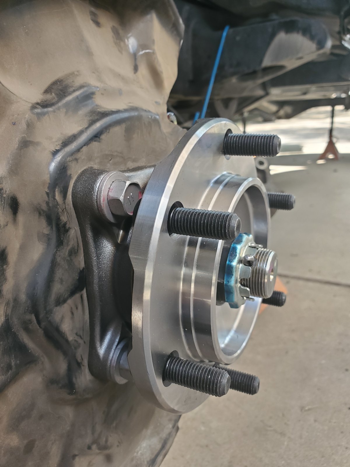

    Received and installed! After 240K km (150K miles) driver's side bearing was really bad. I do a lot of milage at a rather fast pace and fully loaded, on forestry roads, I'm surprised the bearings lasted that long.
    One of my knuckle seals was completely pulverized. The other seals didn't have much rubber, if any, left on em. The best way to install seals for me was to remove the two lower knuckle bolts and the stabilizer bar joint, flip the knuckle so the inside faces outside. The knuckle seal was easy to install using a small piece of 2X4 to hammer it in. It took me a while to figure how to install the axel seal, ended up using the old knuckle one with a small piece of 2X4 to push the seal onto the axel the same way they mate together once assembled. I painted and reused my very rusty backplate, and took the occasion to change a bad caliper, brake pads and rotors. Went on to replace back drum brakes the next day. Feels like a new truck :burnrubber: Looking forward to another 240k km before next wheel bearing overhaul :)
    Thanks 05Taco4x4!

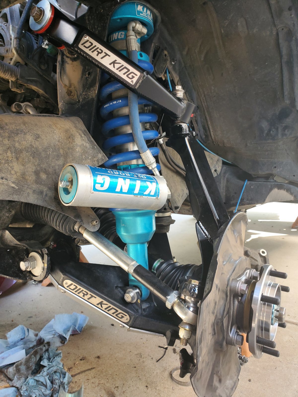

    Installed.
    Been sitting on the work bench for awhile.
    Rebuilt the front suspension and threw them on.
    Great product.
