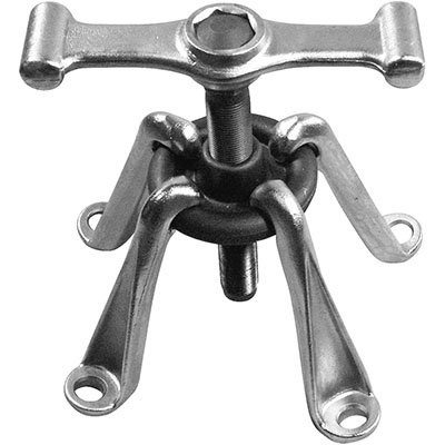

    Would be better to use this type.
    05Taco4x4[OP], jojotoo and Drainbung like this.

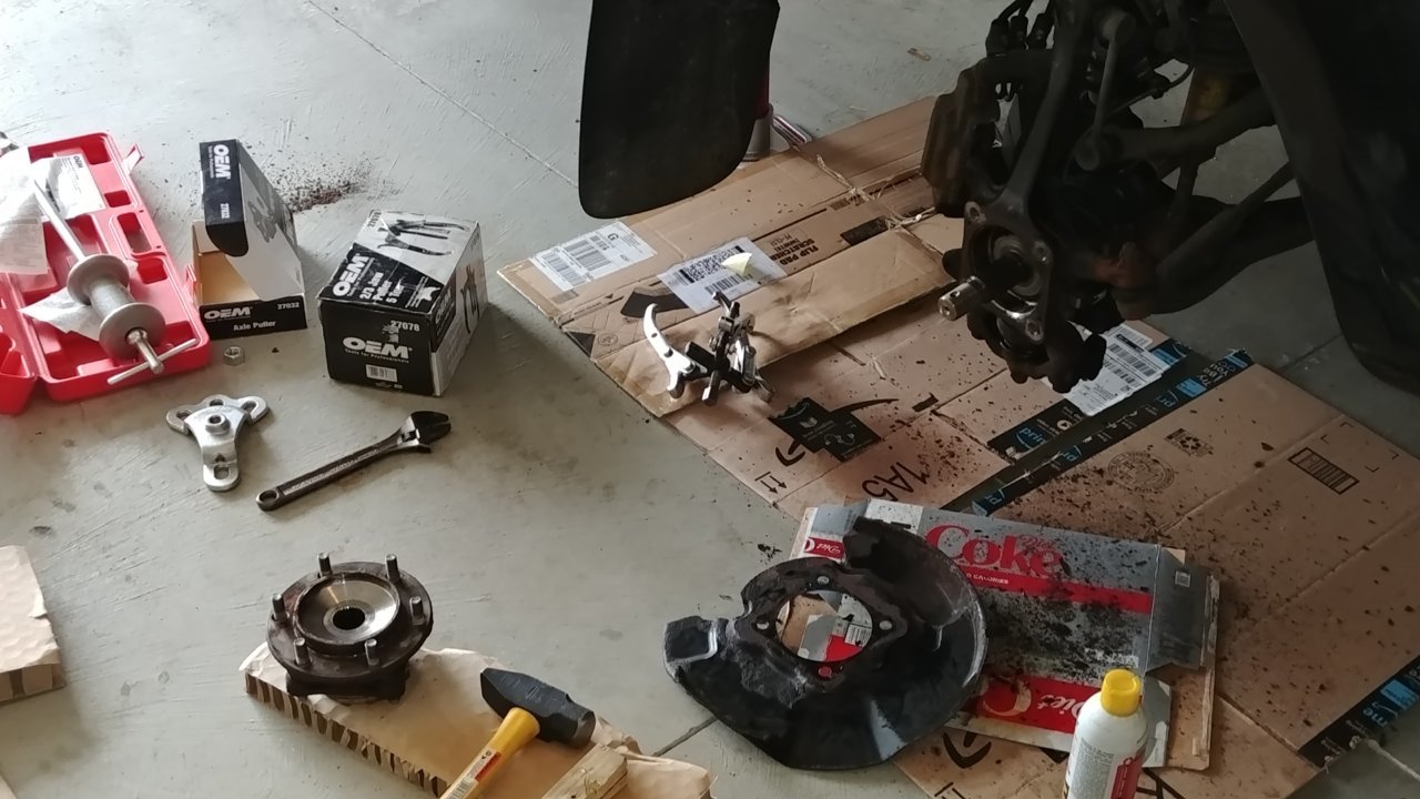

    Hallelujah...this thing would have never come off without the 3 arm puller. I had to put 2 wrenches on that even. But its off, and surprisingly looks pretty good/clean. Time for breakfast. Hopefully I dont have a lot of problems grtting it back together now (looks at spline).

    I cannot stress more highly that you go borrow a slide hammer with flange attachment and 3 arm puller before undertaking this task. It did not have to be this hard. Autozone lets you borrow this equipment for up to 90 days for free (fully refund a deposit). The new bearing assembly went on like butter. Realized my brake rotors are shot (they may have been the original units after 130k miles if that is even possible), so going to replace those while Im at it. Threadjack over.

    I might actually recommend the 3 arm. I had a similar looking flange for the slide hammer. It basically didn't really fit (wrong size diameter) I got like a turns worth of thread on two studs. I only proceeded bc I didnt care whether I ruined the thread or not (replacing the part). The 3 arm fit great though.
