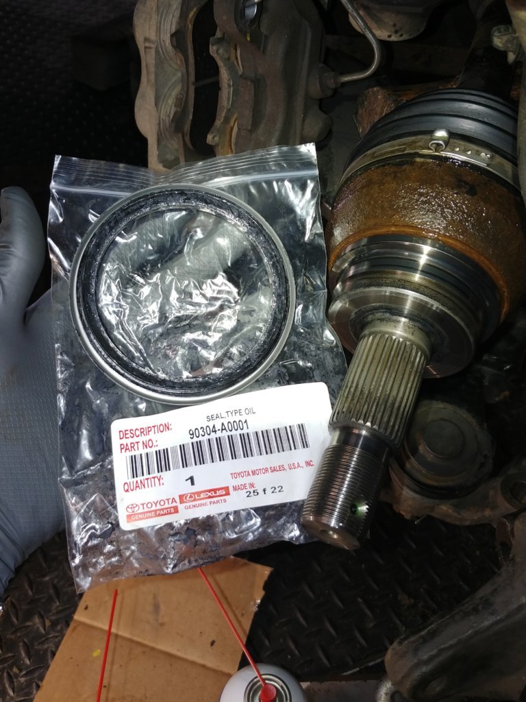

    90316-A0001 is the seal that goes in the hub...got that.
    90304-A0001 the dealer didn't even seem to find. Apparently it goes on the axle itself? Amazon keeps referring me back to the other part number. Going to the toyota parts online its telling me that doesn't fit my truck.
    I am just gonna roll with the one seal.

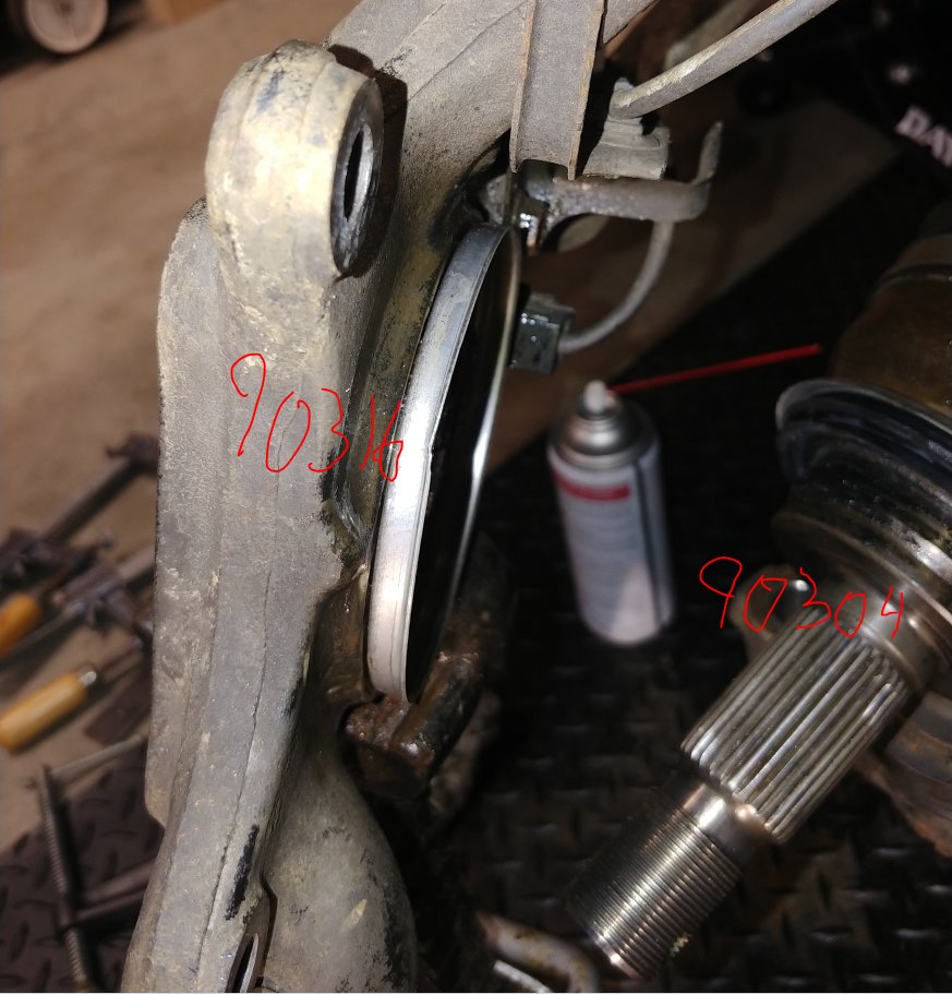

    Theres also this seal on the back of the spindle. Not sure on PN, mine was messed up but I didnt know it so I had to get a parts store one.
    Maybe this
    https://www.amazon.com/dp/B001UCMUEQ

    @TacoTuesday603 that is the 90316-a0001...pretty sure.
    The other one apparently goes on the CV itself but was shown as not compatible for mine. I will worry about it when I replace the cv...which will undoubtedly happen soon now that i am messing with the hub.

    My notes indicate that's correct for my 2012. I think so few people do the one on the CV there isnt much info on it. But yes it should be 90304-A0001. And its cheap so why not
